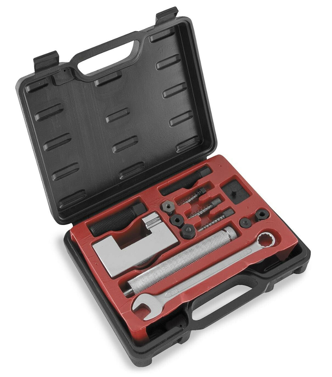

I did find a pretty decent priced chain tool that works on 630 sized chains. BikeMaster part number 01-630. That is a Tucker Dist brand part. Your local dealer should be able to order it for you too!!!! Tucker used to be one of the largest distributors for motorcycle dealerships. I have been out of the industry for like 15 years now so I don't know how big they are now compared to like Parts Unlimited. The retail price I saw on Ebay was anywhere from 104 dollars to 126 dollars. It looks like it does both cut and rivet chains. So you don't have to buy two different tools.

The Bikemaster chain tool kit part number 01-630

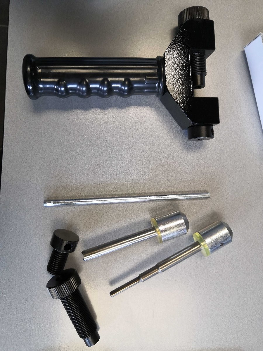

For anyone that has a Whale Riveting Tool, does the middle tool, or insert look like the correct one for "quad" staking a soft nose solid chain pin? I think the other two items are for pin removal and a tool for tightening bushings. You can get a better look at it by enlarging the picture. Thanks....

The middle tool looks to have the same end as my tool. I had to copy photo and blow it up to a supersize photo to make sure!!!! The bottom tool is the tool to push out the pin. I would love to have that part. My ex-racer "buddy" broke mine. And he replaced it with one that was made out of some cheap ass steel!!!! First time I tried to use it, it folded up like a piece of lead. THAT WAS THE VERY LAST TOOL I EVER LOANED OUT TO ANYONE!!!!! I would love to have another one of the factory Whale tools!!!!! Got no idea what that top tool end does. Never saw it before this photo. I did look, the anvil part of my Whale tools are the same. So you don't need two complete tools anymore!!!

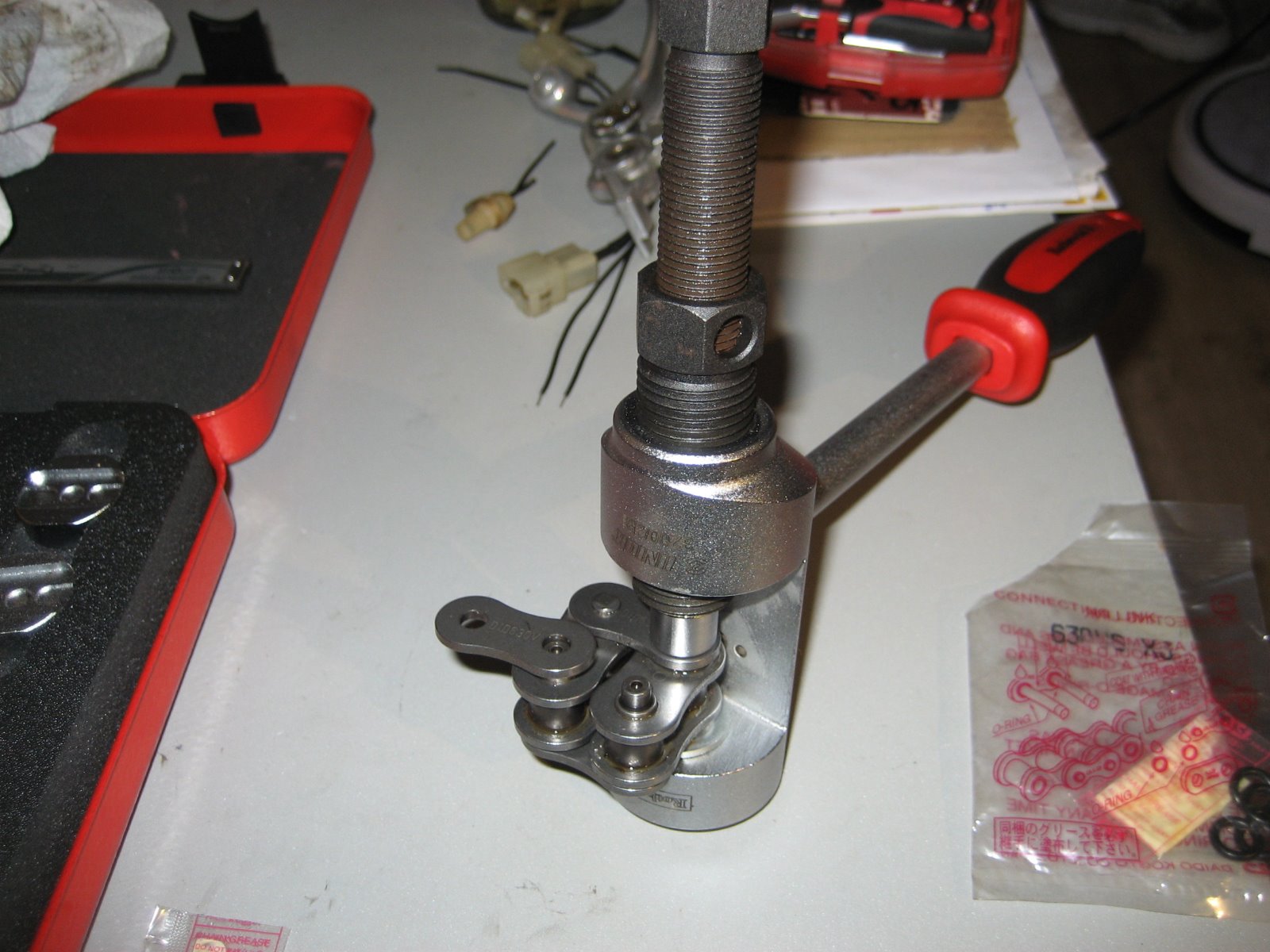

I would second and third Zed's advice. it used to be a "thing" to find dead sporty's with cracked RH cases from the chain link coming out and the chain wrapping up on the front sprocket, breaking the case. Although it looks like you are already on the right path with the rivet tool, the 4 point stake is really not necessary IMHO. This is my EK 630 SRO chain with hollow rivet link. Done deal. (the second time around on the link). A little learning curve adjustment was necessary.
Attachment not found
As previously stated, it doesn't take an expensive tool to stake the hollow pin links. I don't remember how much I paid for this cheapo tool, but it wasn't much on eeeeebbbayyyyy... Fast and FREE shipping too.

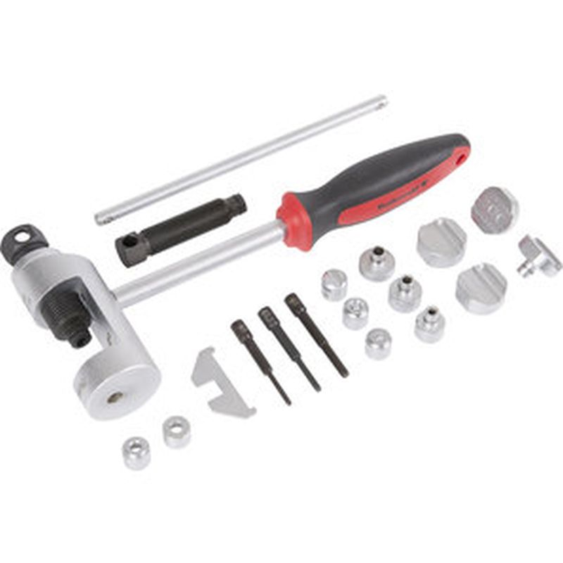

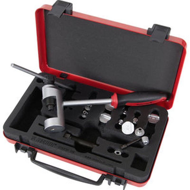

I use this chain pin removal and riveting tool over the years.
You can do D.I.D-, Regina-, RK and Enuma chains.
cdn3.louis.de/content/catalogue/articles...ennwerkz_GB_INET.pdf

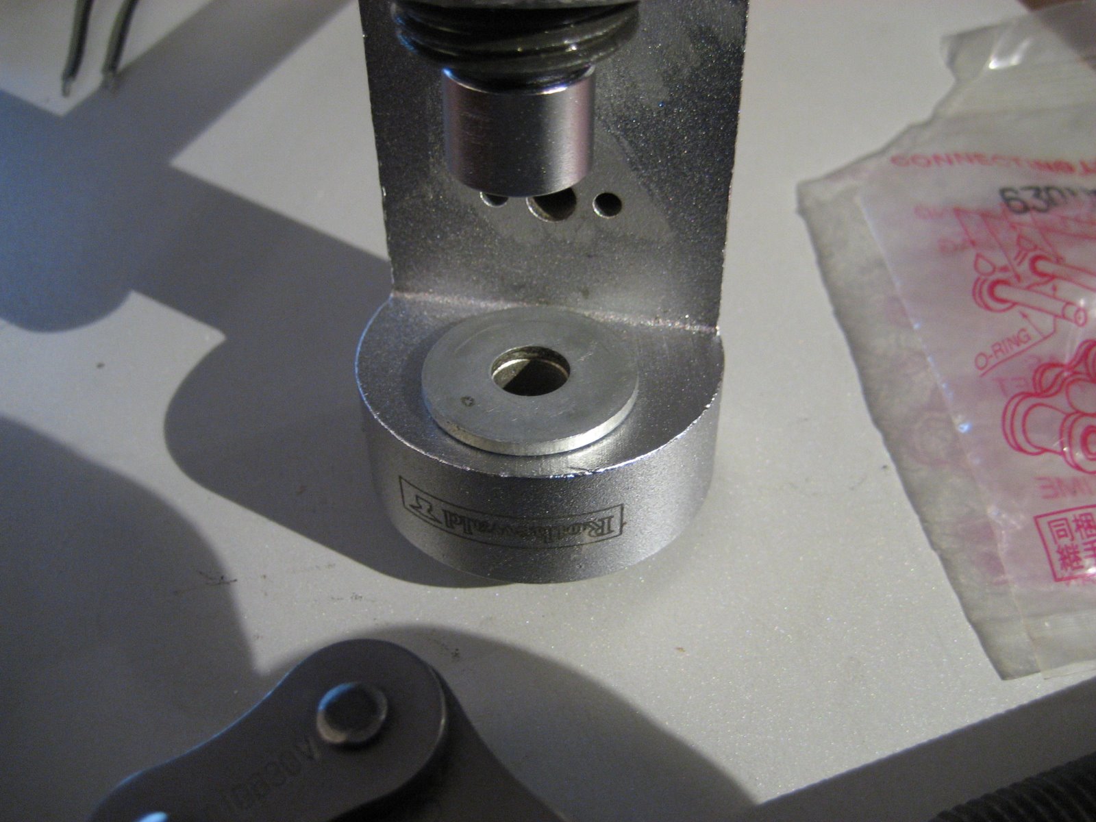

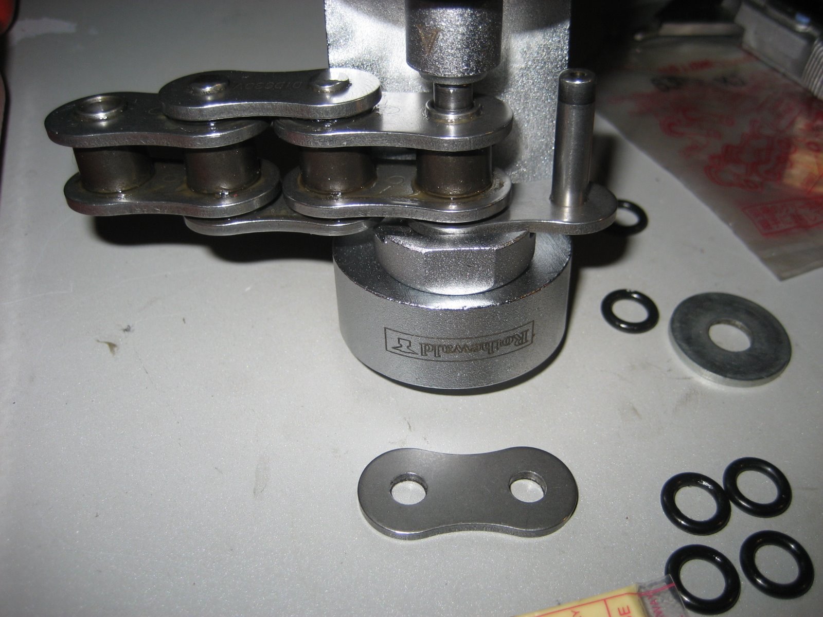

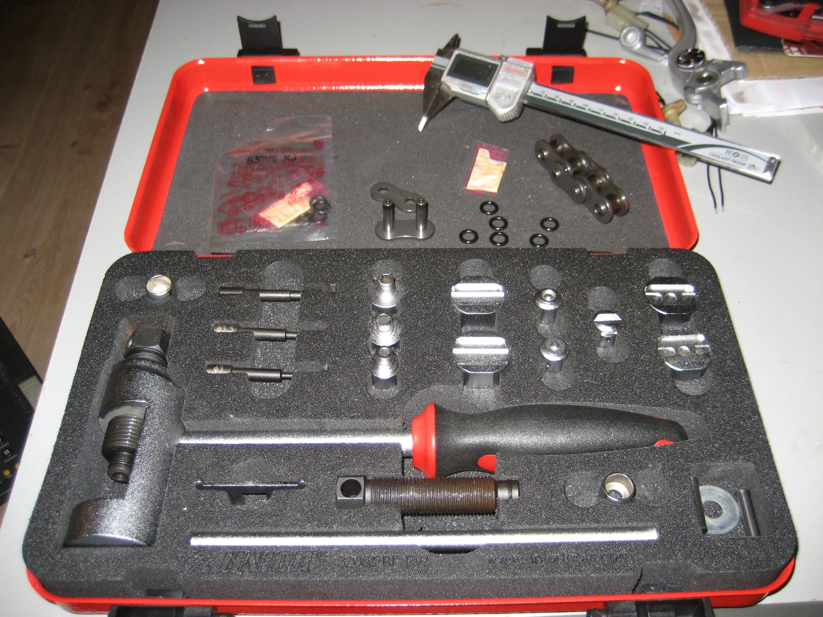

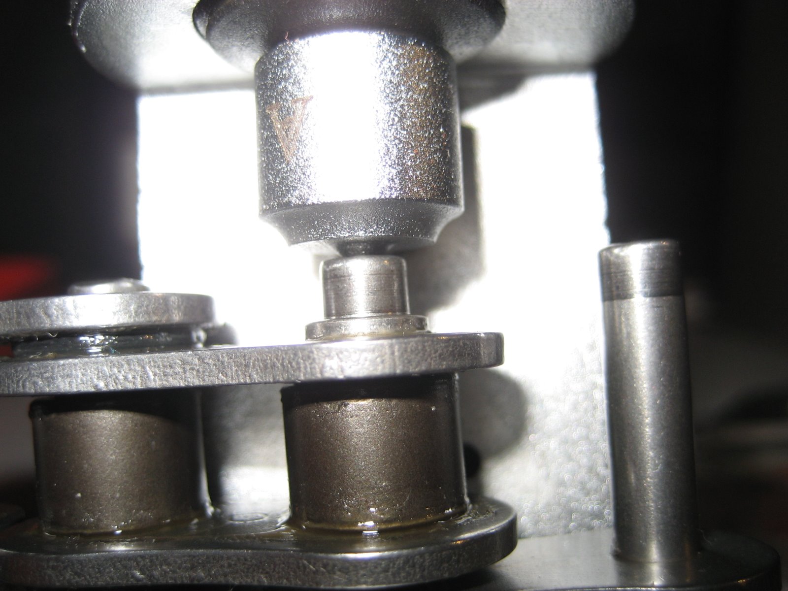

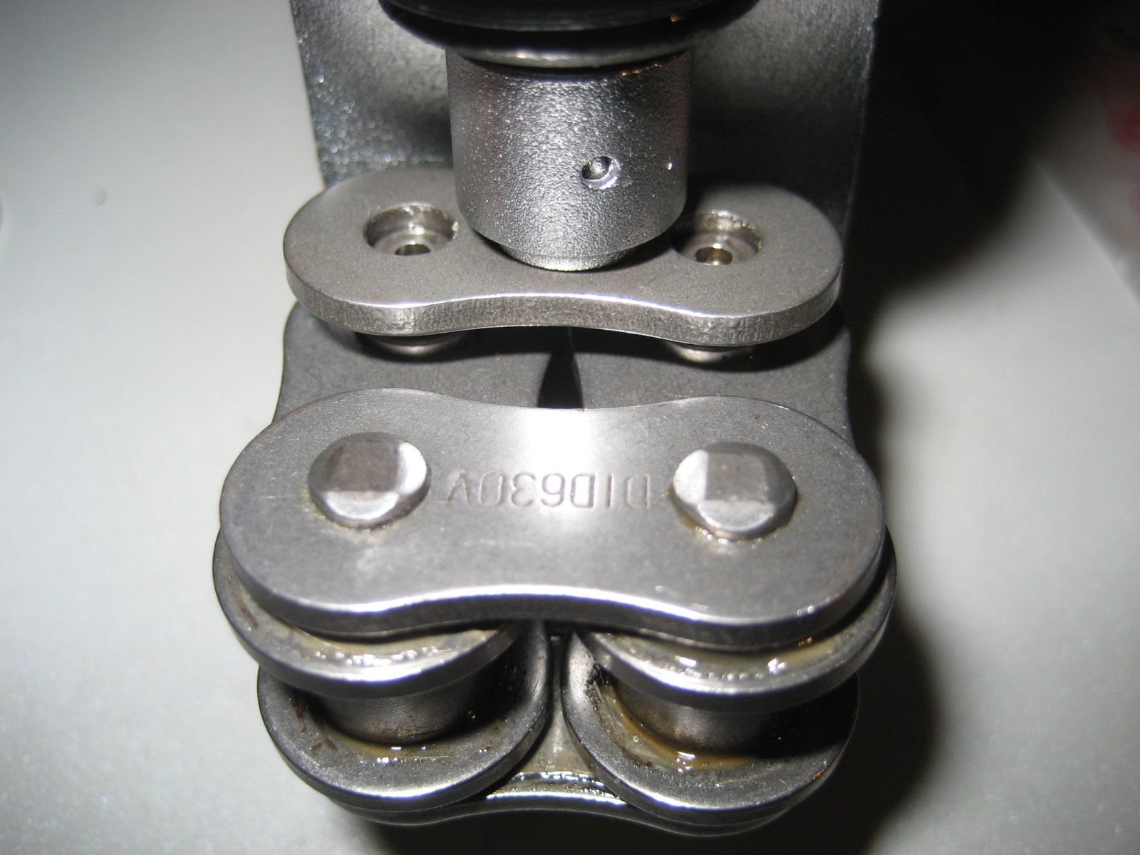

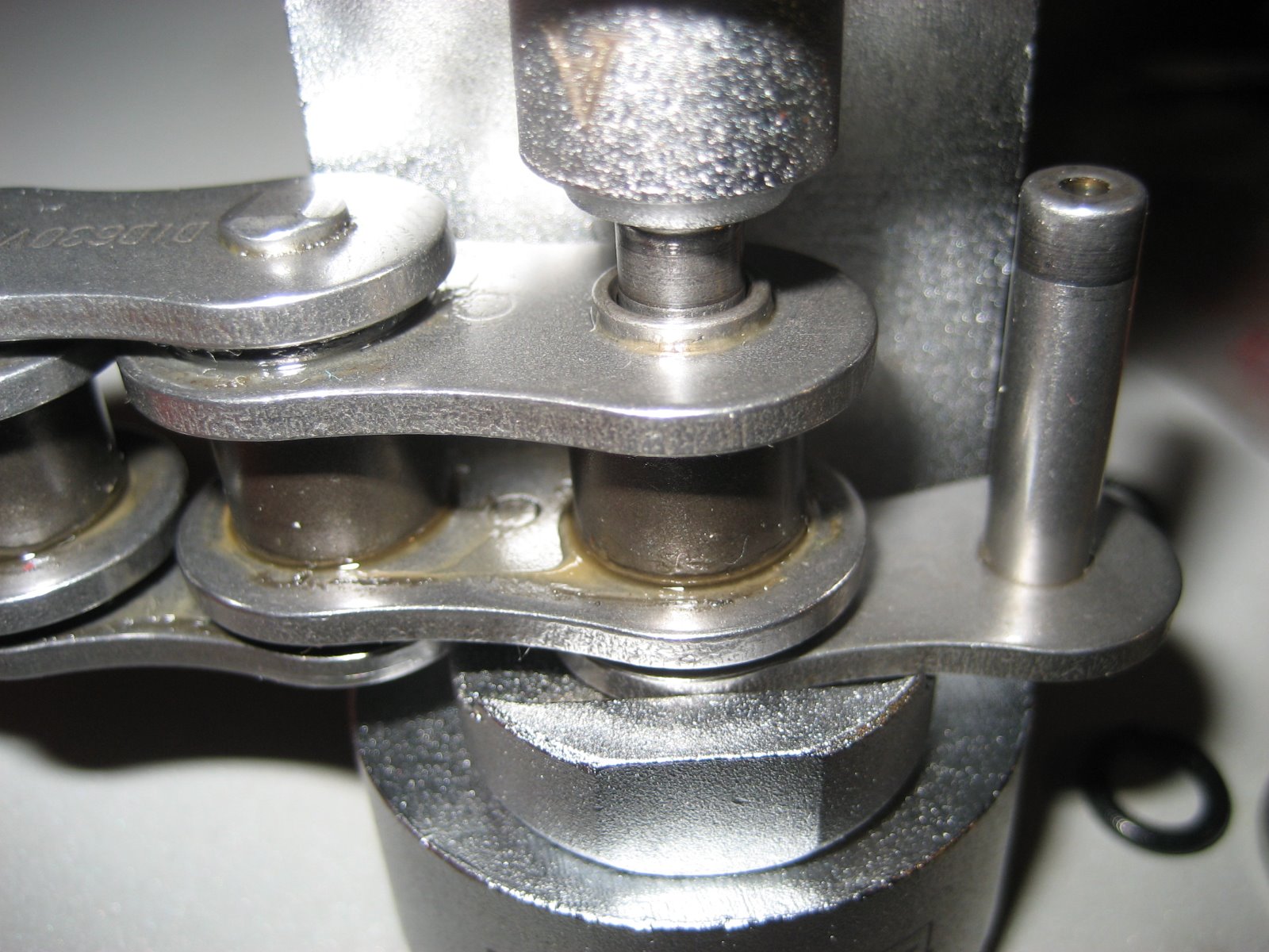

You can use the Rothewald chain tool to de-rivet and rivet 630 chains. To de-rivet 630 chains you need only a 7-8 mm ID washer to push out the link bolt. The 530 chain riveting tab can handle 630 chain key links. It´s a little tight fit but it works great.
If you need/want the tool i can order it for you.
