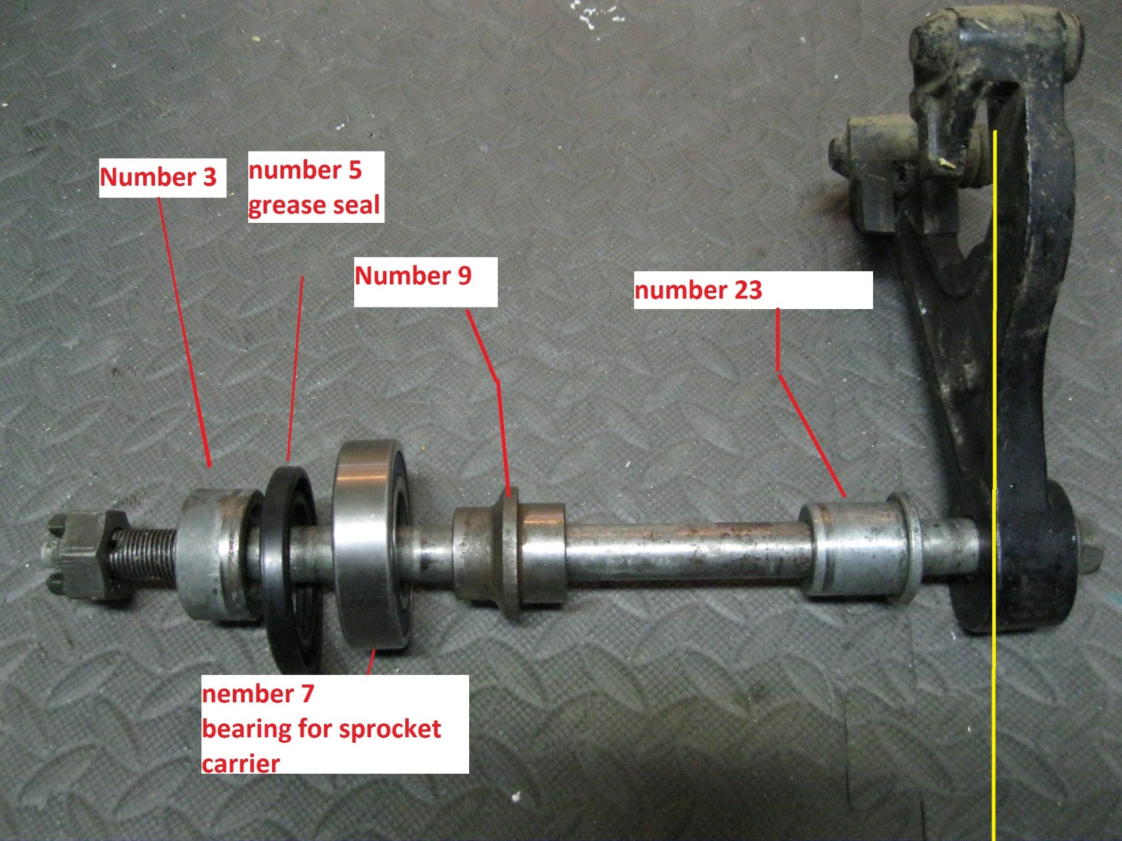

If the rear wheel is already off the bike bike then see the picture below which is from another post.
Remove the brake part which has the piston
insert the axle ( #9 in the pic may be backwards ) from the brake side. The rear disc is signified by the yellow line. Cant remember what the brake part in the pic is called. For now I'll call it the big black Y.
Hang the pads, pad guide and anti rattle spring etc in place on the big black Y .
Put the piece which has the piston on top.
secure with the bolts.
Hook up and the brake stay (torsion bar ?)
Its pretty easy to change rear brake pads with wheel in place. Just remove piston part, insert pads, replace top
