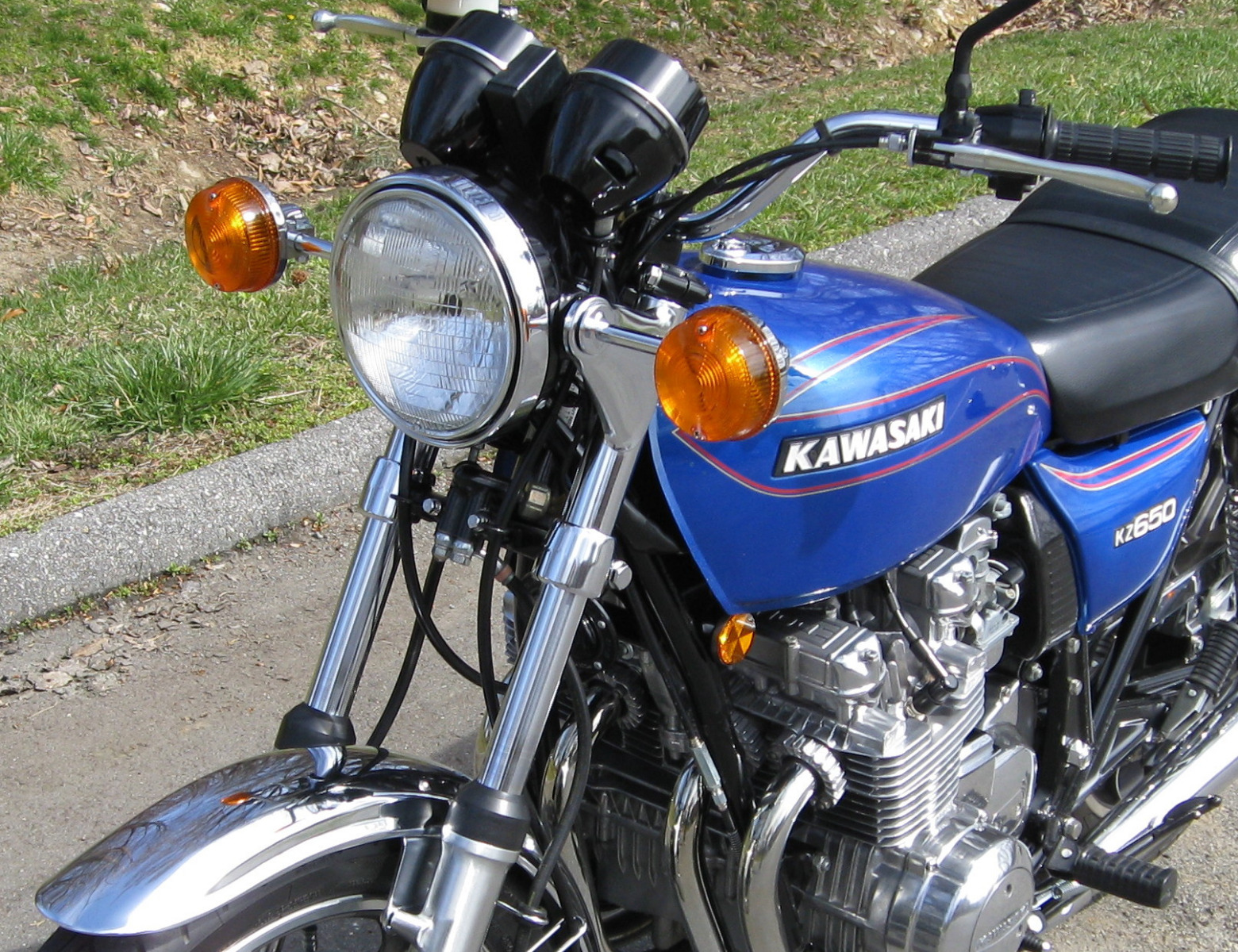

09 Apr 2019 10:09Trackerkz650sr wrote: .............Pics of what u guys are running would be ideal......
And my brakes definitely are not spongy..........

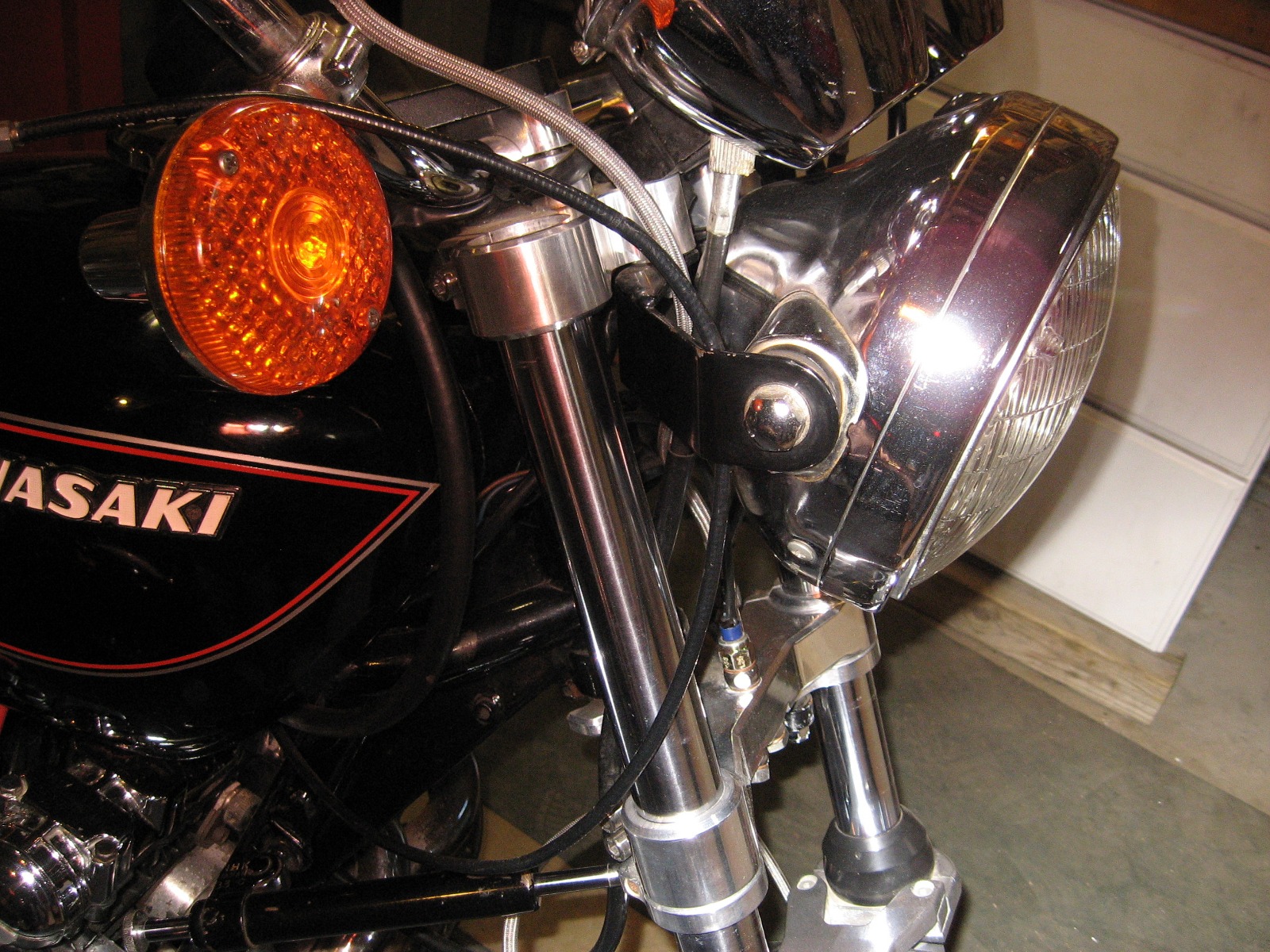

Or have Les Holt at our vendor PDM build you a custom triple tree with the brake splitter built into the lower tree
I never liked the look of the stock splitter. It works great , but ugly in my eyes
