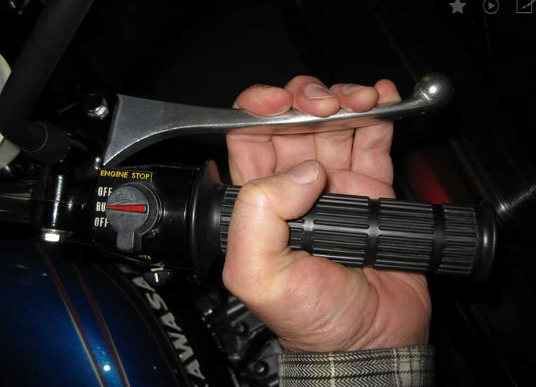

Re: Front brake splitter options
09 Apr 2019 10:09Trackerkz650sr wrote: .............Pics of what u guys are running would be ideal......
And my brakes definitely are not spongy..........
