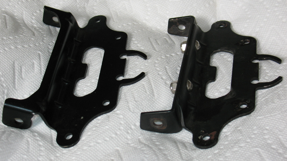

Yes, a photo may help. You may have already considered this stuff, but depending upon where it's broken, maybe you can get it welded or maybe add some angle iron. or buy a good replacement & beef it up where it tends to break. ???
Here's one that appears to have been welded or something. EB meter bracket Spectre 1100

For reference, the pictures from the ebay auction that Martin posted are showing the break in exactly the same place mine snapped. It's basically where the metal bends at 90 degrees for the mounting posts to the tree.

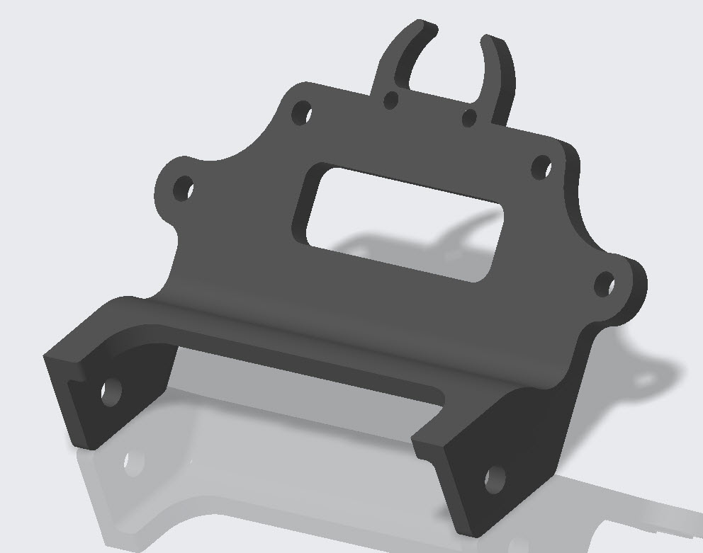

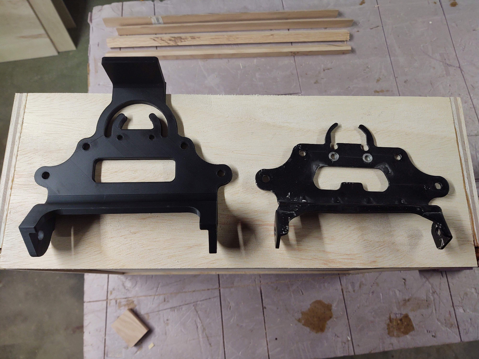

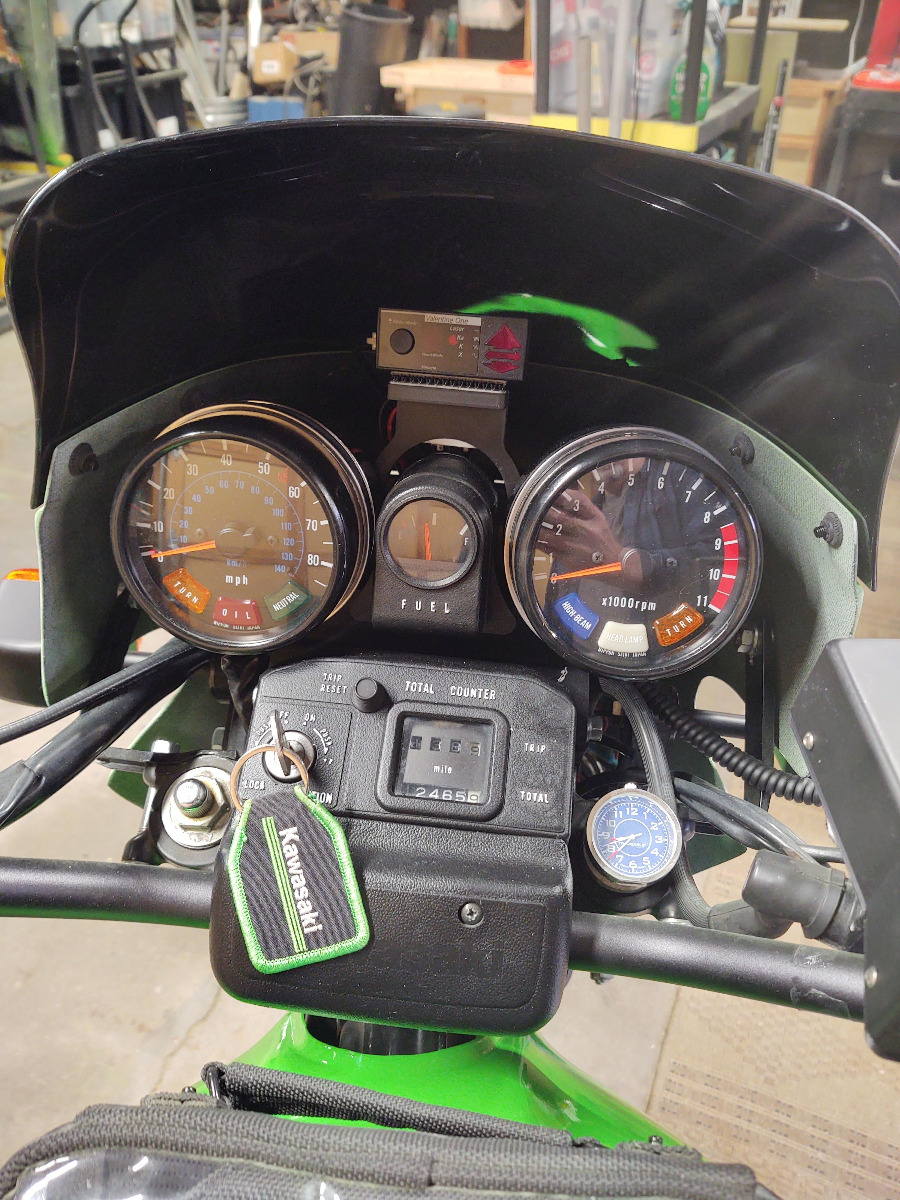

Just to add to an older thread, my bracket broke like others have mentioned. I took the high-tech newfangled route and made up a 3D printed replacement. 1/4" plus of ABS with very generous radii. Should work, if not I'll redesign with some additional gussets or something. One advantage to this method is customization - I added a shelf for my radar detector remote display.
