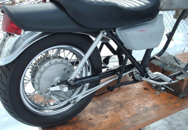

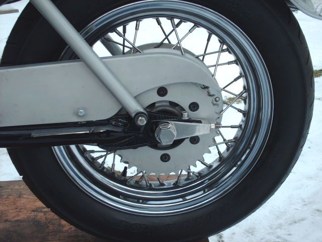

Simple & common change from back in the early days of Z1-KZ's & SOHC Honda 750's. Ya' got Dave Mann art from EZ rider. Hog wheel conversion.
I assume your rear wheel is same as the Z1-KZ900. 16" spoke kit for Harley drop center wheels, were sold in all those bike magazines, EZ Rider, Iron Horse, Street Chopper.
Every once in a while you see NOS kits on ebay. Plus, yes Buchanon spokes sell them. I have a Harley 4" x 16" with a 150 tire on an old project that's been sitting.
These are 10 yr old pictures.
Search around, should be an easy find.
Good Luck.

No eBay APP ID and/or Cert ID defined in Kunena configurationHere is what you want to do!
This one is rusty, but, this is the common conversion.

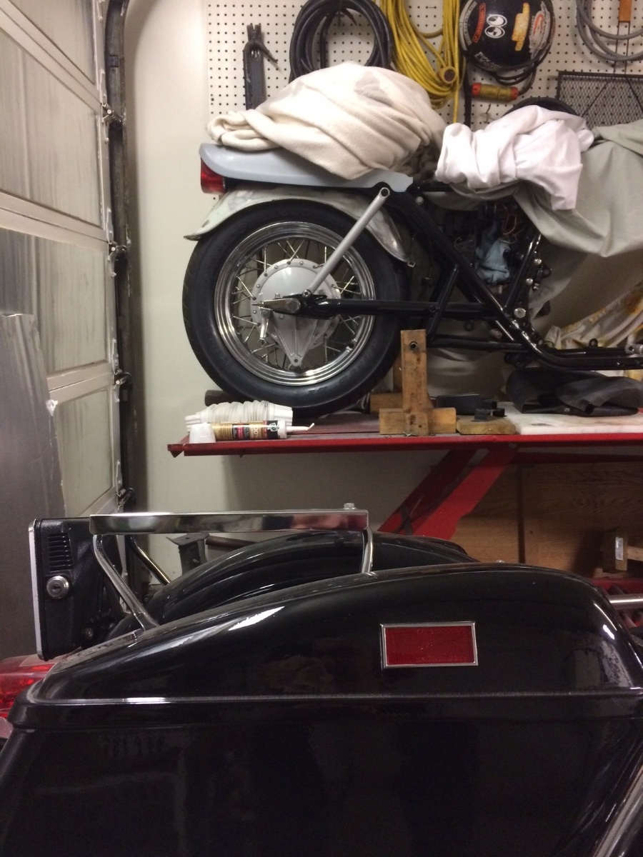

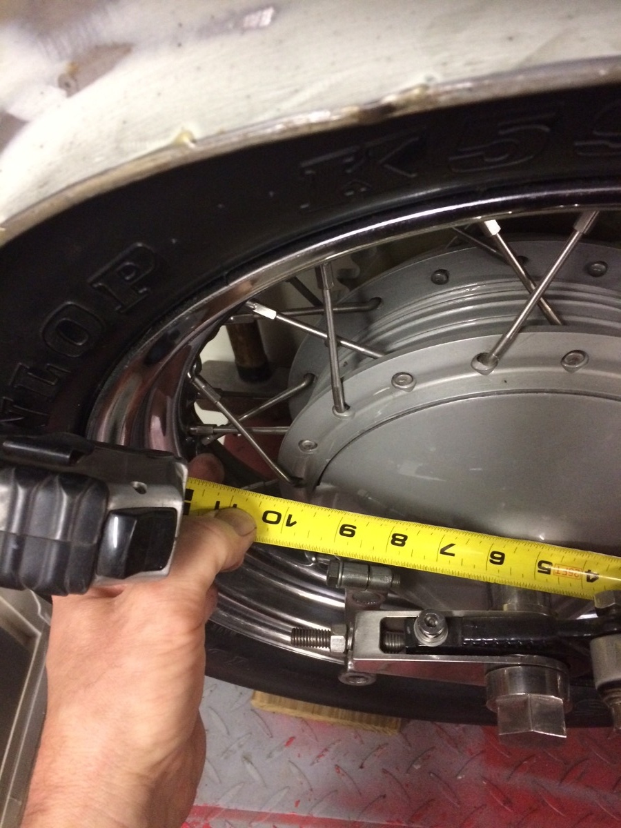

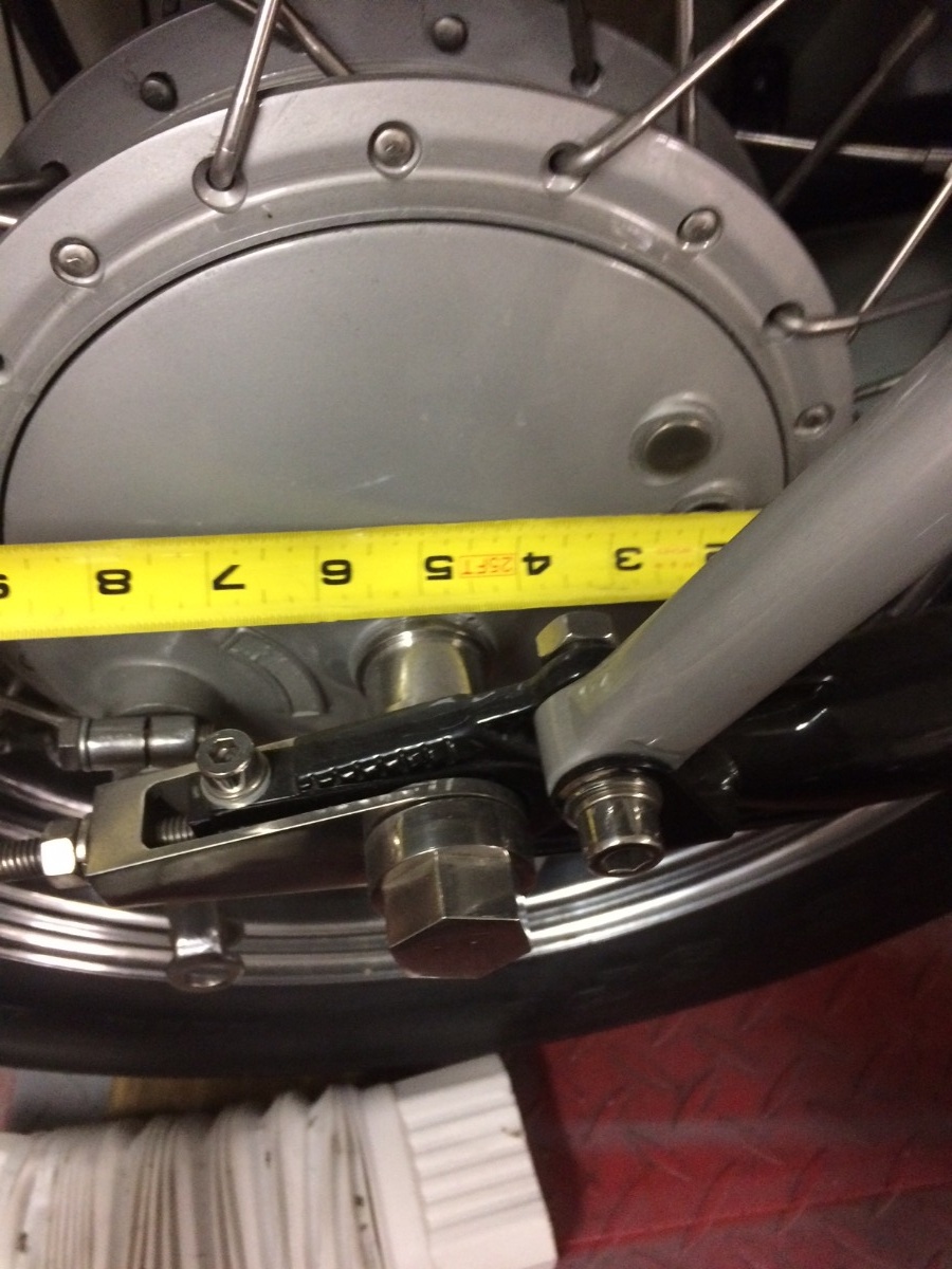

z1kzonly, any chance you could give me a guesstimate of the center hub diameter on the bike you posted ?? That is if you still have it... Nice looking bike by the way.

Hey S Bum, 650's are smaller than the 900. And it's hard to get a measurement around the hub, with the axle in way.
But about 10" plus a little bowed. Hard to measure on bike. Someone might chime in with a hub not mounted?
But, I know 650 hubs are smaller.
