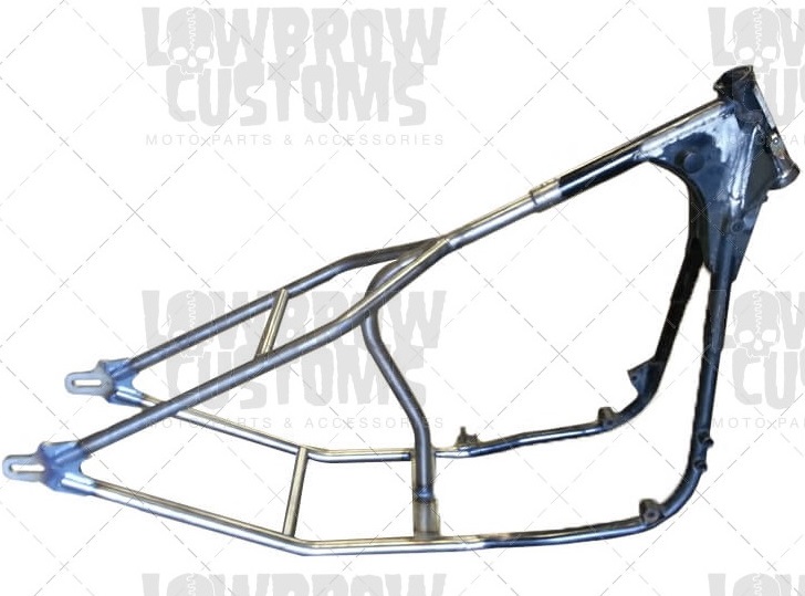

Thanks for the info DoctoRot !! I forgot to post I decided to go for the expanding type, or hub brake on the rear wheel. Yes I will have some fab work ahead of me on this. I purchased the hardtail conversion from Lowbrow Customs for this project which lowers the rear 2.5" and stretches it 3.2". It uses the front portion of the factory frame, so it eliminates getting the DOT involved and having to get a new title for the bike.
Here's a pic of it....

I understood you want a drum brake/ "expanding type" hub. What axle diameter are the plates of that hardtail?

This is from the manufacturers website........
Stretch: 3.2 inches
Drop: 2.5 inches
Axle Slots: 20mm (3/4 inch) x 65mm
Int. Axle Length: 9.25 inches
Stretch: 3.2 inches
Drop: 2.5 inches

The kz650 uses a 17mm axle. Its probably easiest to find a z1/kz900 drum hub which already uses 20mm. Otherwise you will need to do a bearing conversion, bore the brake plate, and make a custom bearing spacer for inside the hub.

They make spacers \ sleeves, I think there referred to as top hats, as with a little imagination they look like the top hats men used to wear in the 1920's I believe. These top hats are machined to fill the void between the axle and the axle plates on the frame, thus eliminating the need to go through all the work you've referred to. Depending on where you get them, they range from $8 to $15. That will save me time and money going that route.
