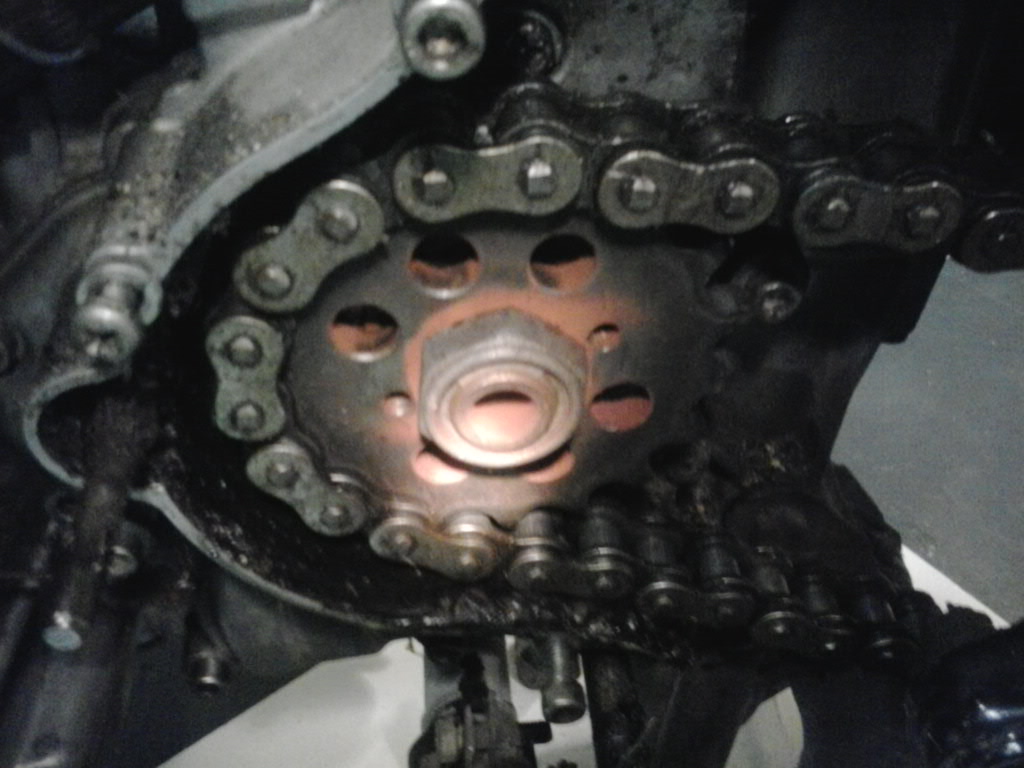

This year I could feel the chain vibration and tight spot so I knew it was time.
We hardly ever get caught in the rain and the bikes are garage kept in the summer and are in the house for the winter months.
I guess 50 K is all I can expect out of these new chains
You can't tell from the out side because I kept up with the waxing , doing it while the chain was warm just after a ride.
but the inside was rusting out as can be seen on the front sprocket.
The chain never really stretched out much after the initial setting.
