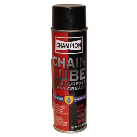

07 Jun 2017 10:47Maxima is good stuff. I've used Champion now for years. My chain and sprocket set has roughly 15k on it and I've barely had to adjust it. Good stuff on the cheap.
