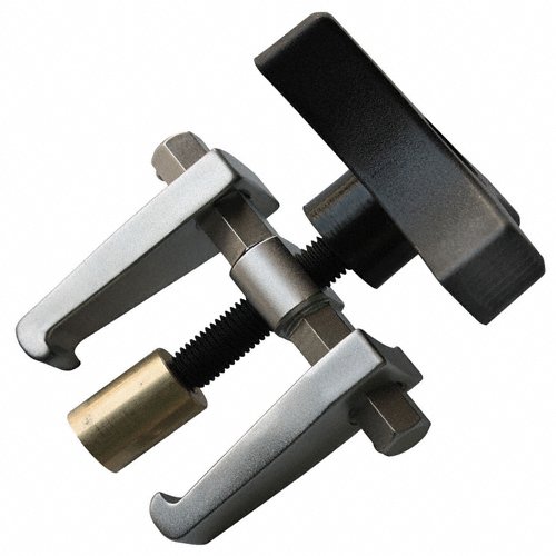

Remove the circlip and pull of the kicker
get the right two arm puller
everything else and unnecessary force destroy your kickstarter cover
Michael
Michael

The pullers are cool, but I'm just trying to remove the Pedal, not the shaft/gear assembly.

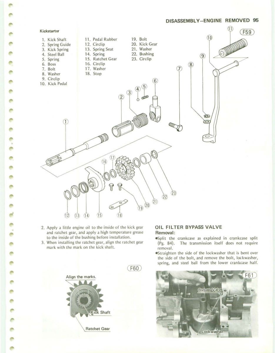

So you are trying to remove #10 from #6 in the diagram??
As already mentioned, just remove the e-clip and it should slide off very easily. If not, I would suggest some better penetrant like Kroil or a 50-50 mixture of acetone and atf.

Actually I'm trying to remove #6 from the #1 kick shaft . #10 and #6 are still attached .
