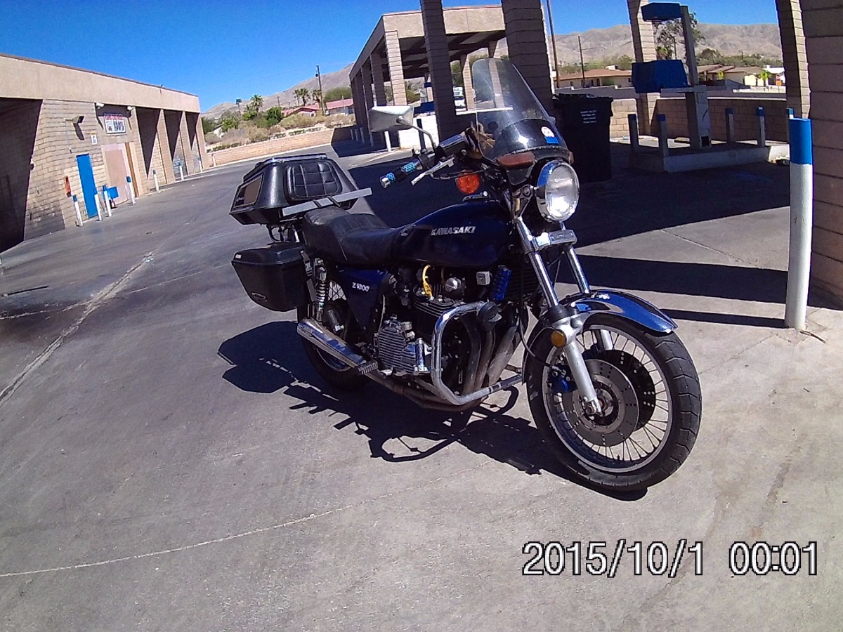

I understand. Bossie sat under a tree for 15 years. Single parent two children. No money for a bike.
