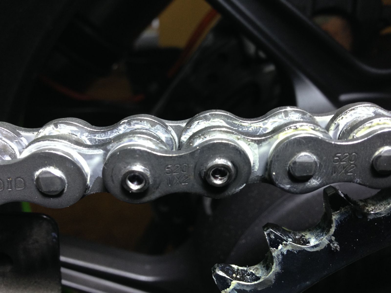

Re: My 1977 KZ750 Chain BROKE today while I was riding
16 Apr 2017 20:01
It looks like the chain lock (master lock)was not good riveted
It happens to me on my Hayabusa with a D.I.D chain. I lost the chain on a Highway in Austria, Thank goodness nobody was hurt.
I investigate i use the wrong tool for pressing the master lock for D.I.D chains.
It should look like this
