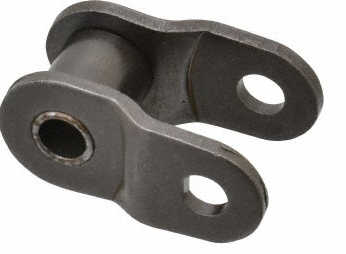

I'm with Steve that it looks like a half link. I'm in a hurry and might have missed it but there is no more mention if indeed it was a half link???
The reason I'm bringing it up is......................................if it was a half link there is a reason it's in there. Purchase the same size sprockets you had before and you might end up with a odd number of drive chain links again?????????????
I have a couple of broken half links on my "wall of shame". Self inflicted of course. Live and learn......and lucky enough to still be riding.

The chain you show in your pics definitely is not the original chain. It is in fact aftermarket trash. The image below shows a half link. Notice that the side plates are not flat; Kawasaki never installed that junk. Your motorcycle would have left the factory with a size 530, 106 link EK530SH "endless chain" (see
www.powersportswarehouse.com/p/Kawasaki#...50-B2-1977/070058E-7
) That original chain would not have a master link; instead, all the links would be riveted, and it would have been an O-ring chain. When buying a new chain I highly recommend you buy an O-ring or X-ring chain. D.I.D. (not to be confused with cheap DID knockoff), Tsubaki, EK, etc. make excellent chains. Don't buy Chinese junk. Replacing the sprockets with the new chain is a very smart thing to do, otherwise even moderately worn sprockets will kill the new chain quickly. Be sure to buy quality sprockets. Ed
