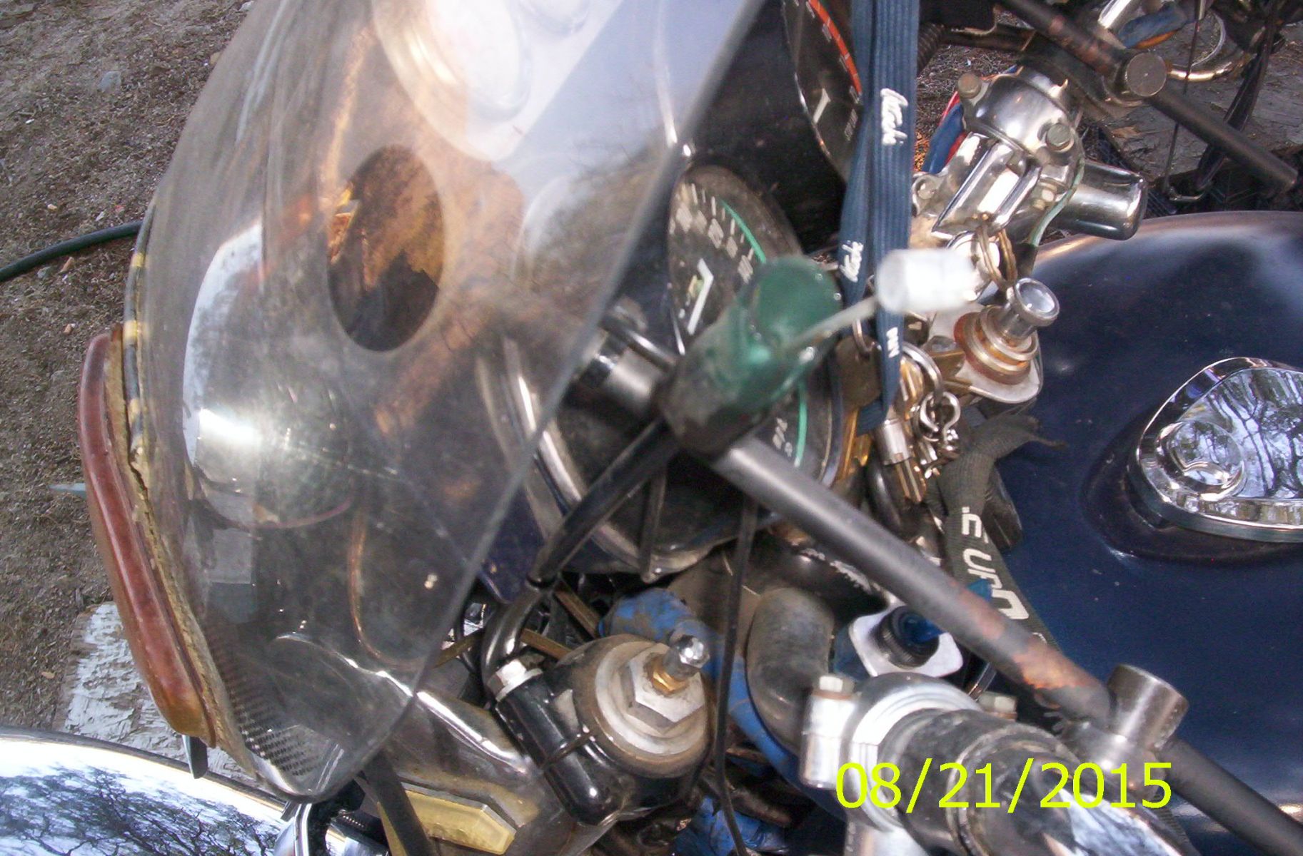

You can buy an attachment for it but I use this. Carry it on the bike and use motor oil.
kzrider.com/forum/5-chassis/599386-cable-lube#686767

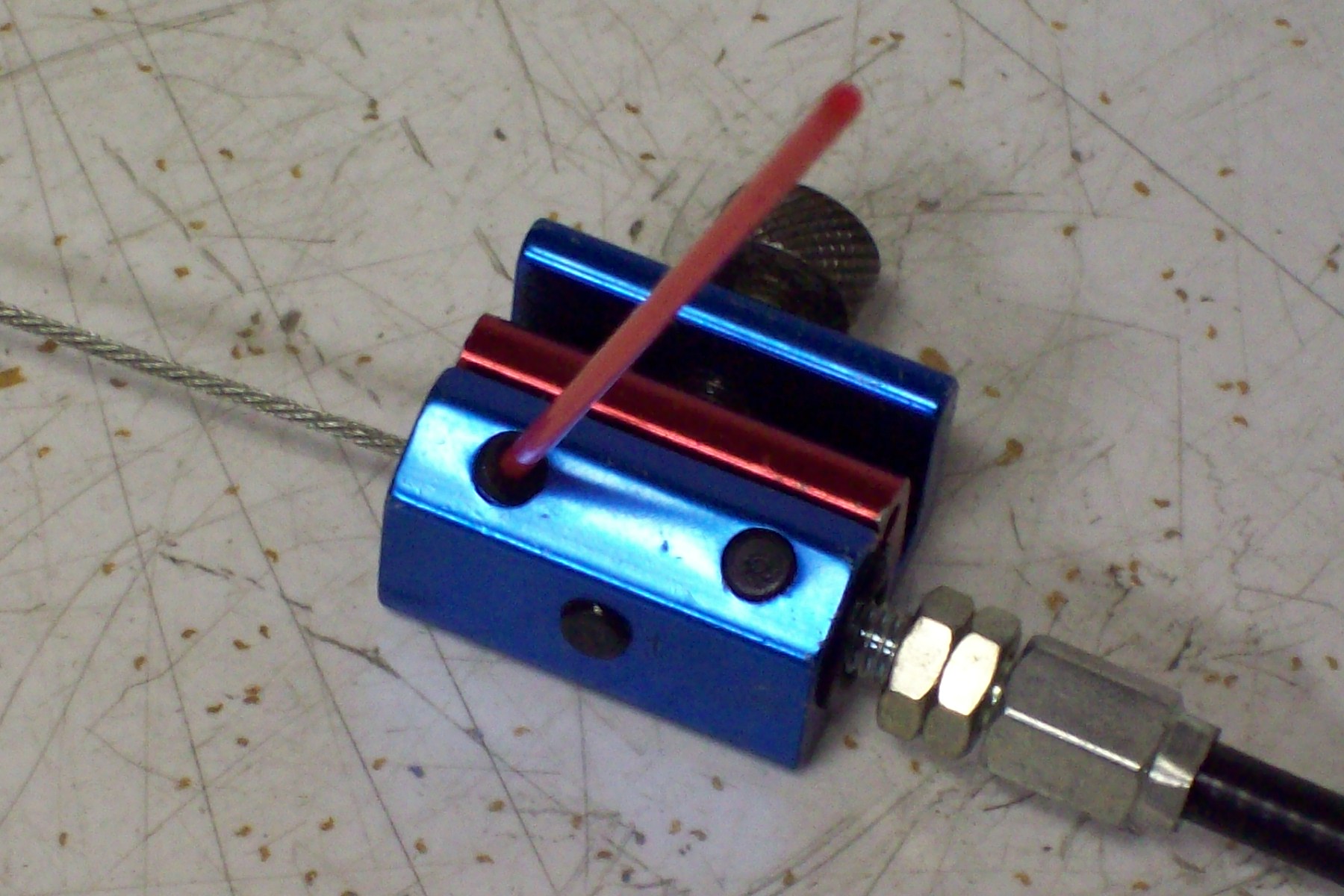

I bought this fancy little tool back in the early 70's to lube cables. Its so old it even has stamped in it "MADE IN USA" I use PJ1 black chain lube for clutch cables, and WD40 for throttle cables. Anything heavier when it gets cold the throttle does not snap back quickly. Less than 5 minutes and you are done!!!

12 Jan 2017 18:53Dr. Gamma wrote: I bought this fancy little tool back in the early 70's to lube cables. Its so old it even has stamped in it "MADE IN USA" I use PJ1 black chain lube for clutch cables, and WD40 for throttle cables. Anything heavier when it gets cold the throttle does not snap back quickly. Less than 5 minutes and you are done!!!
I have one of those too, but it's early 1990s vintage. Not sure where it was made.
I recall reading that one should not use chain lube for cables as it becomes tacky after application (as a result of the anti-fling properties) but it seems to work for you. I've always used cable-specific lube - right now it's this:

I've got the same tool as Dr. Gamma and had it about as long. They still sell them. I flush with WD-40 until it runs clean, followed by a cable specific lube (PJ1 I think). A can will last a lifetime. I also do a light coat of White Lithium grease on the exposed cable and end.

Motion Pro has come out with a new version of their cable lube tool. I have not used it yet, but want to buy one.
