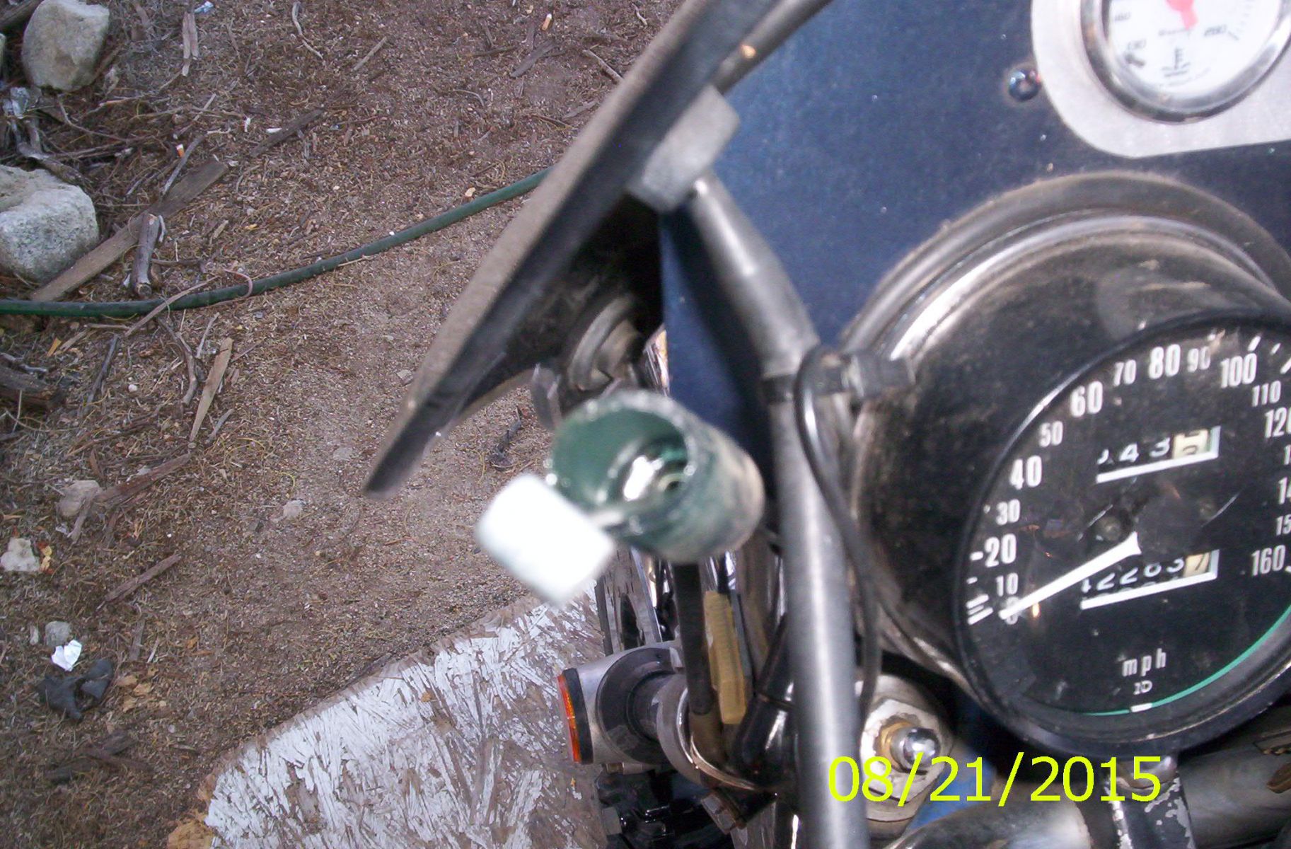

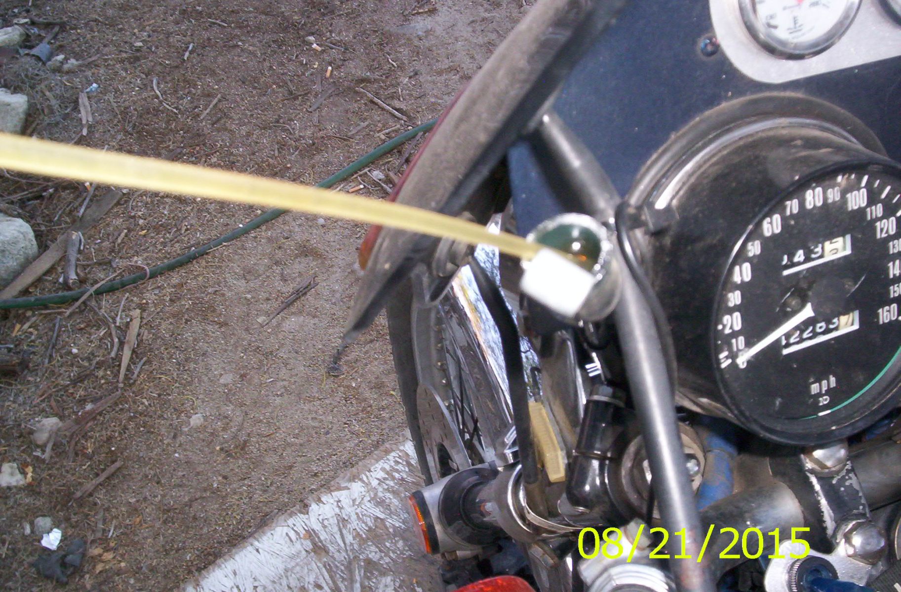

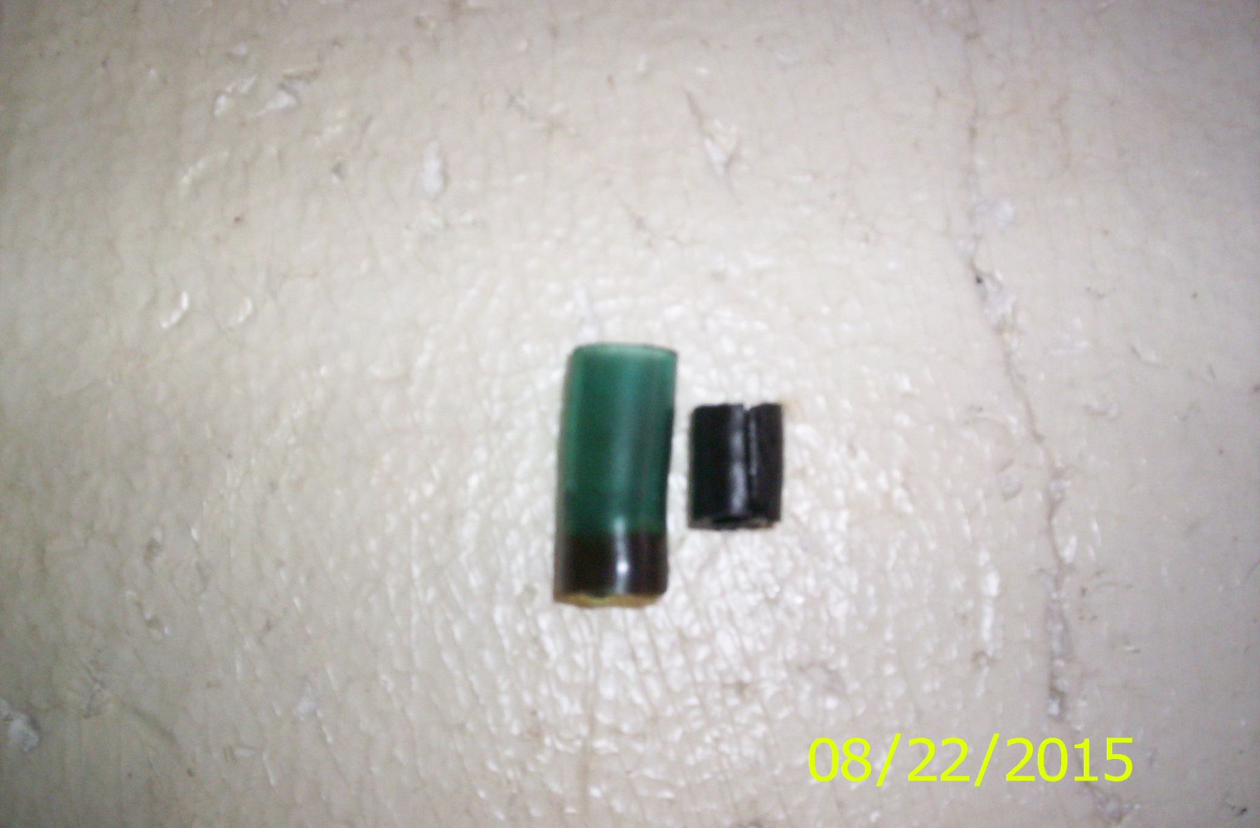

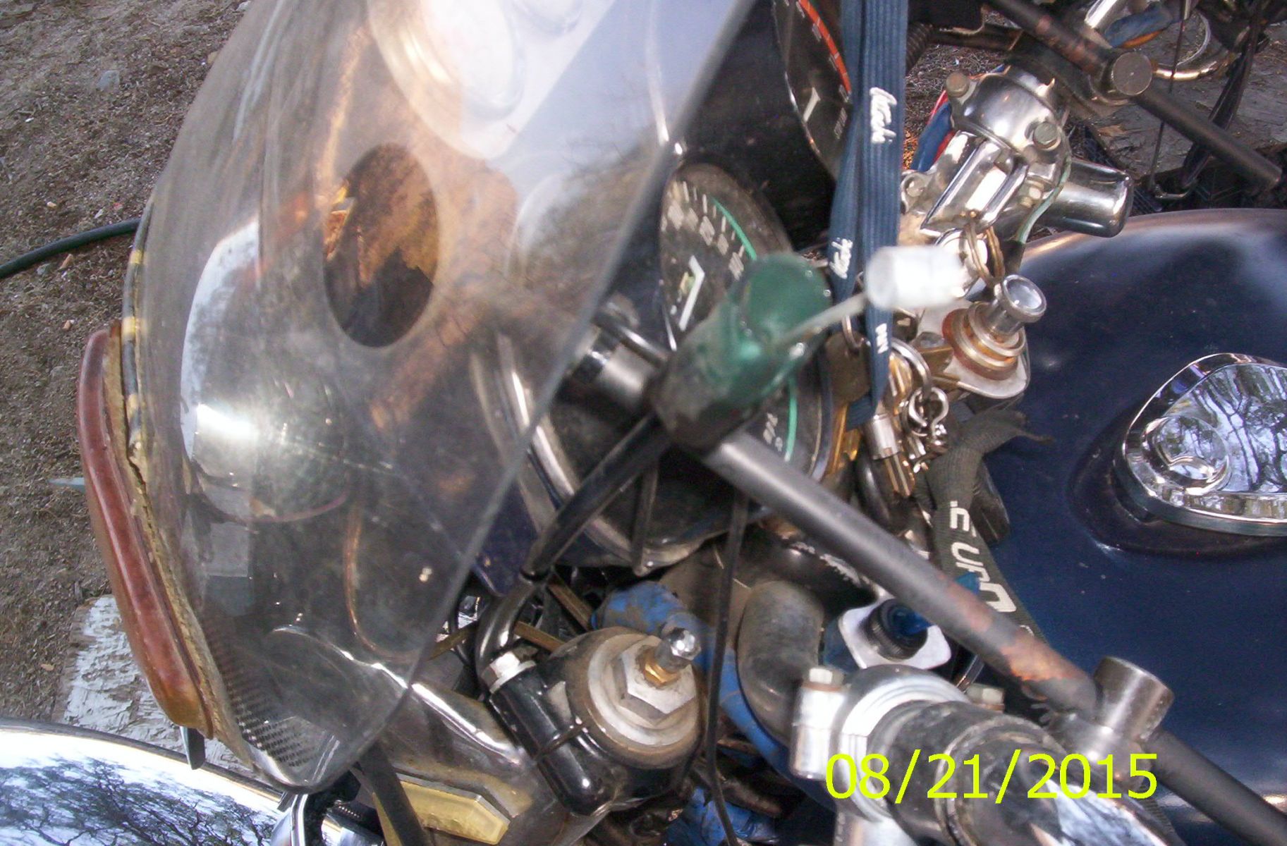

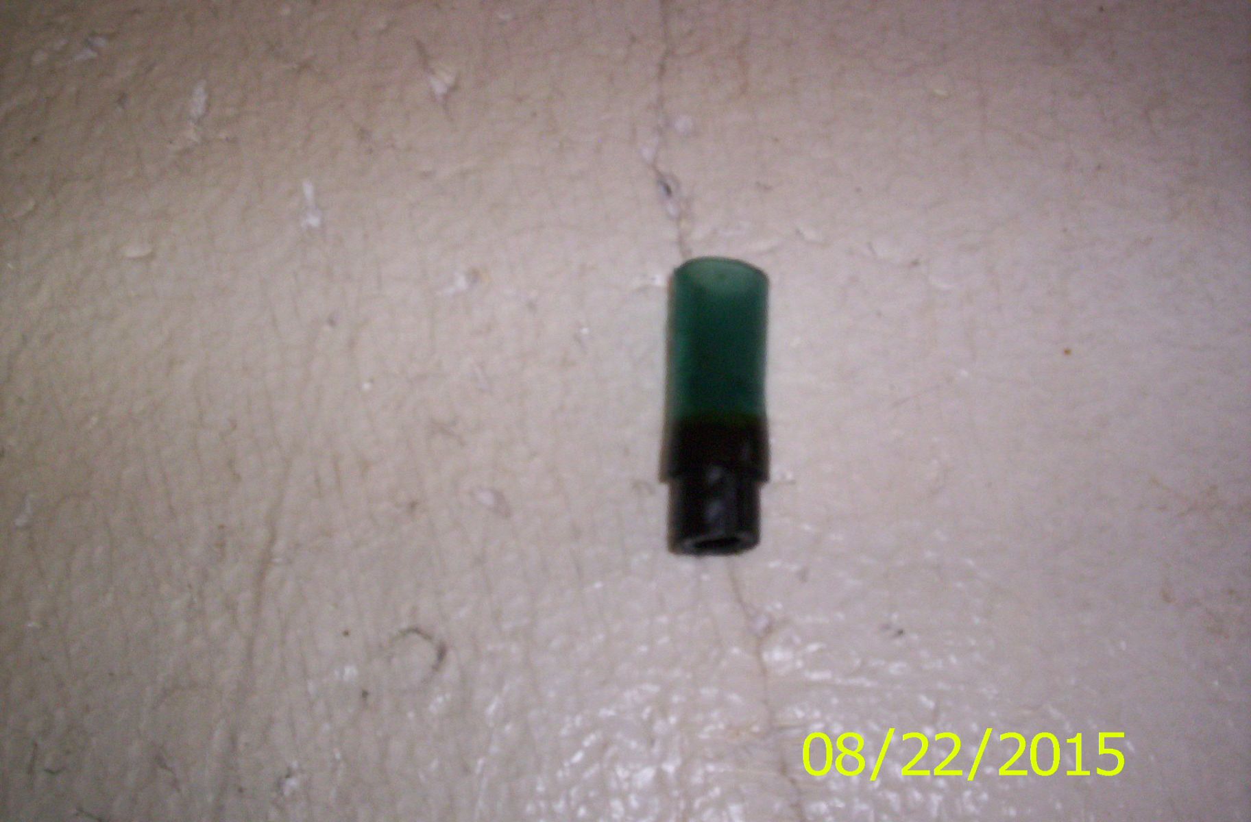

I've been doing this for ever. Can't seem to find it when I need it. No matter, it doesn't cost anything. I take a piece of 1/2" clear tubing and a 3/4" piece of 5.16" fuel line, cut a slit in the fuel line to fit over the cable sheath, slide the 1/2" over that and instant cable lube tool.
I just lubed my clutch cable so I decided to put it up.
