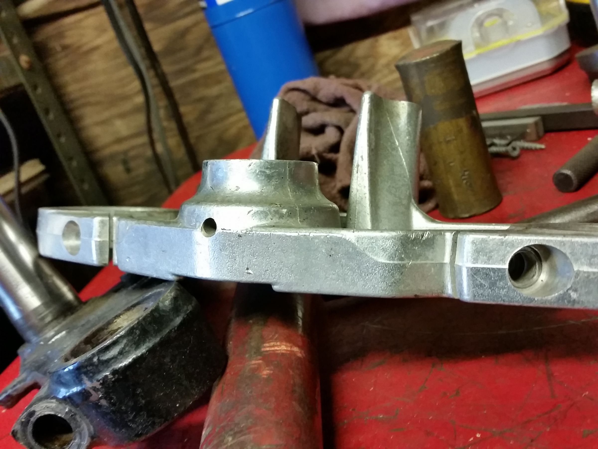

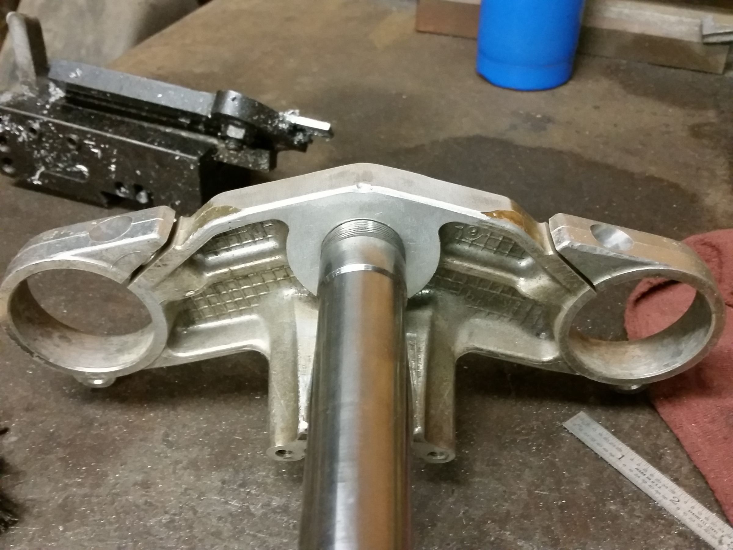

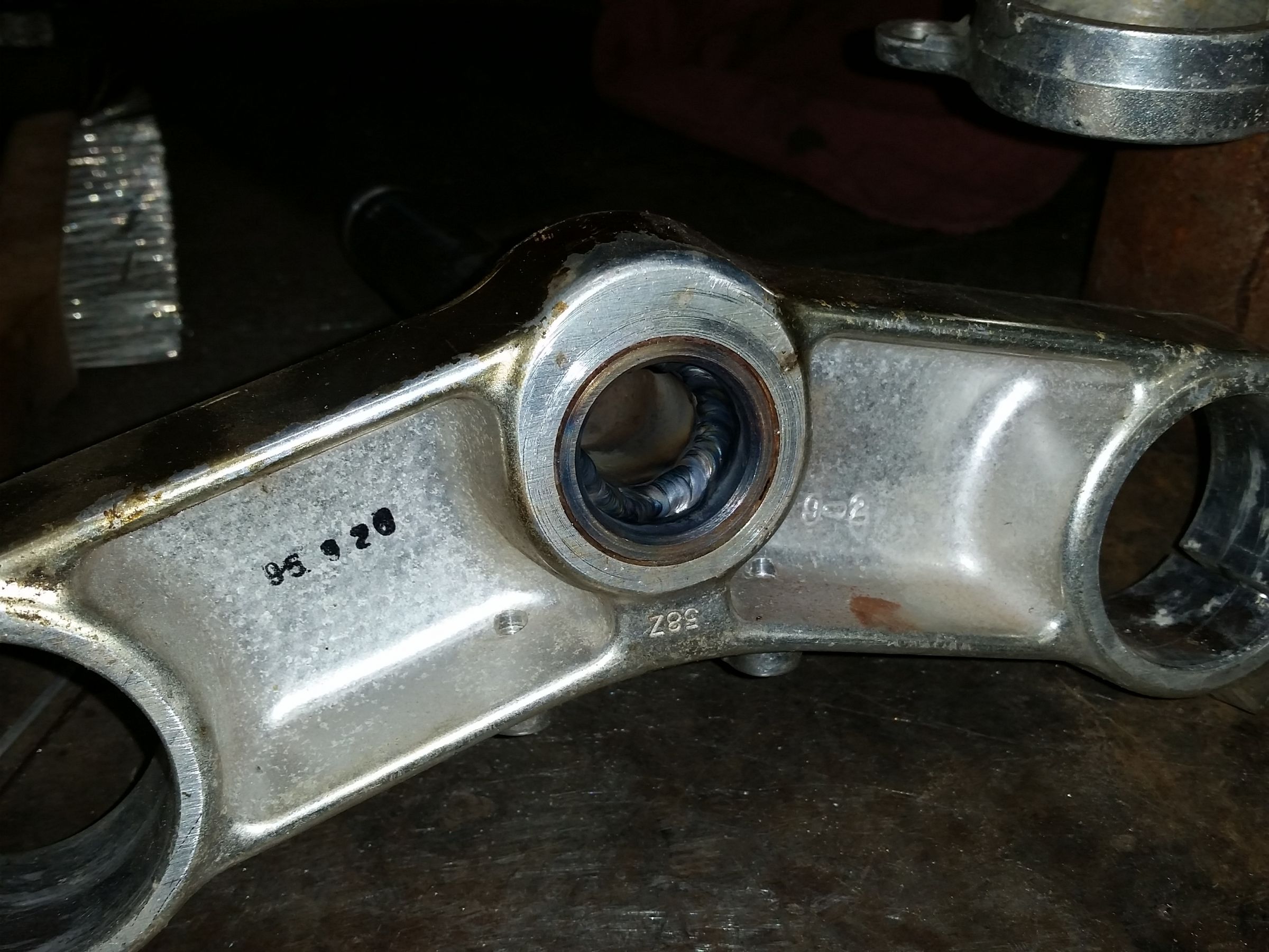

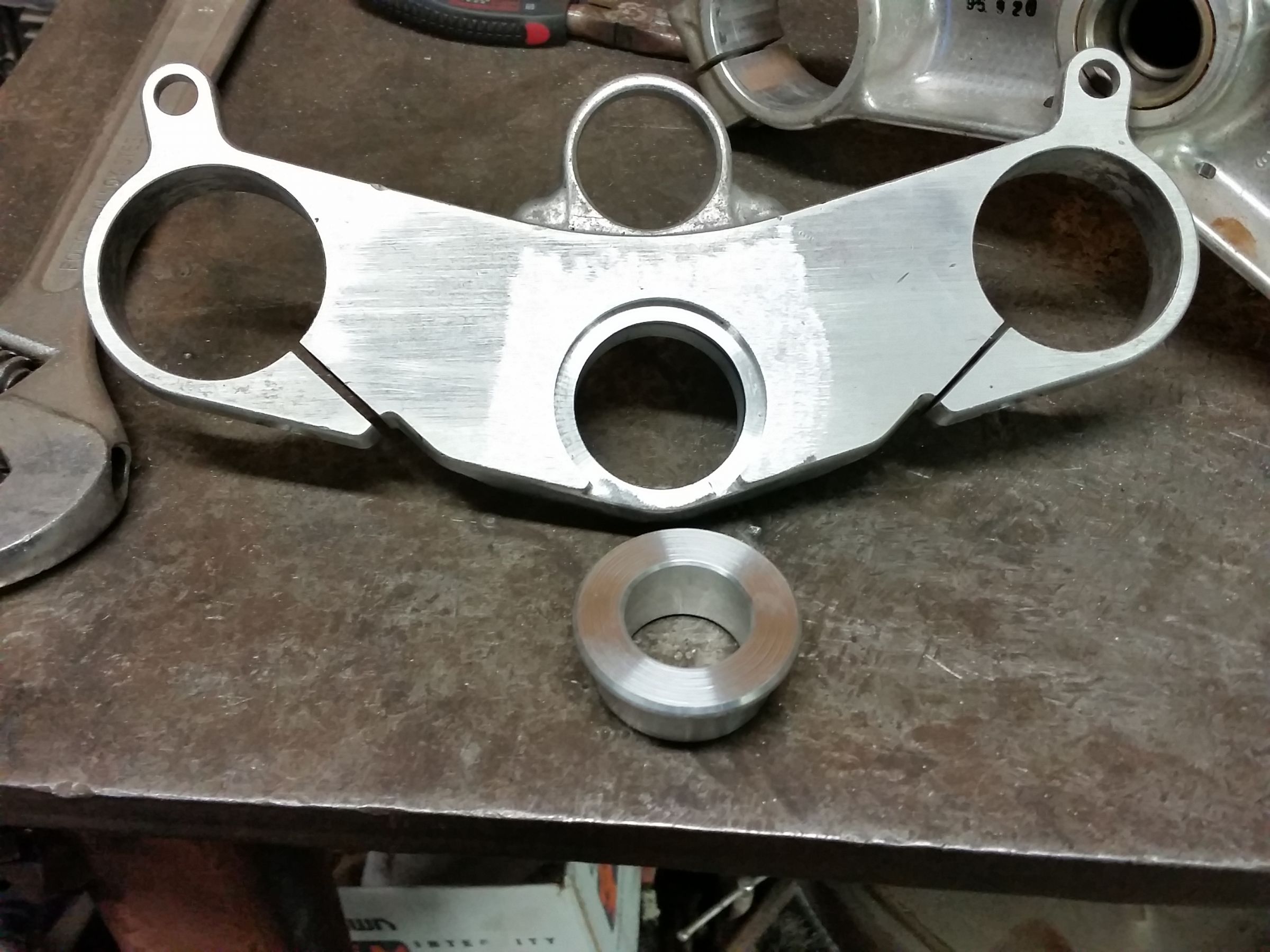

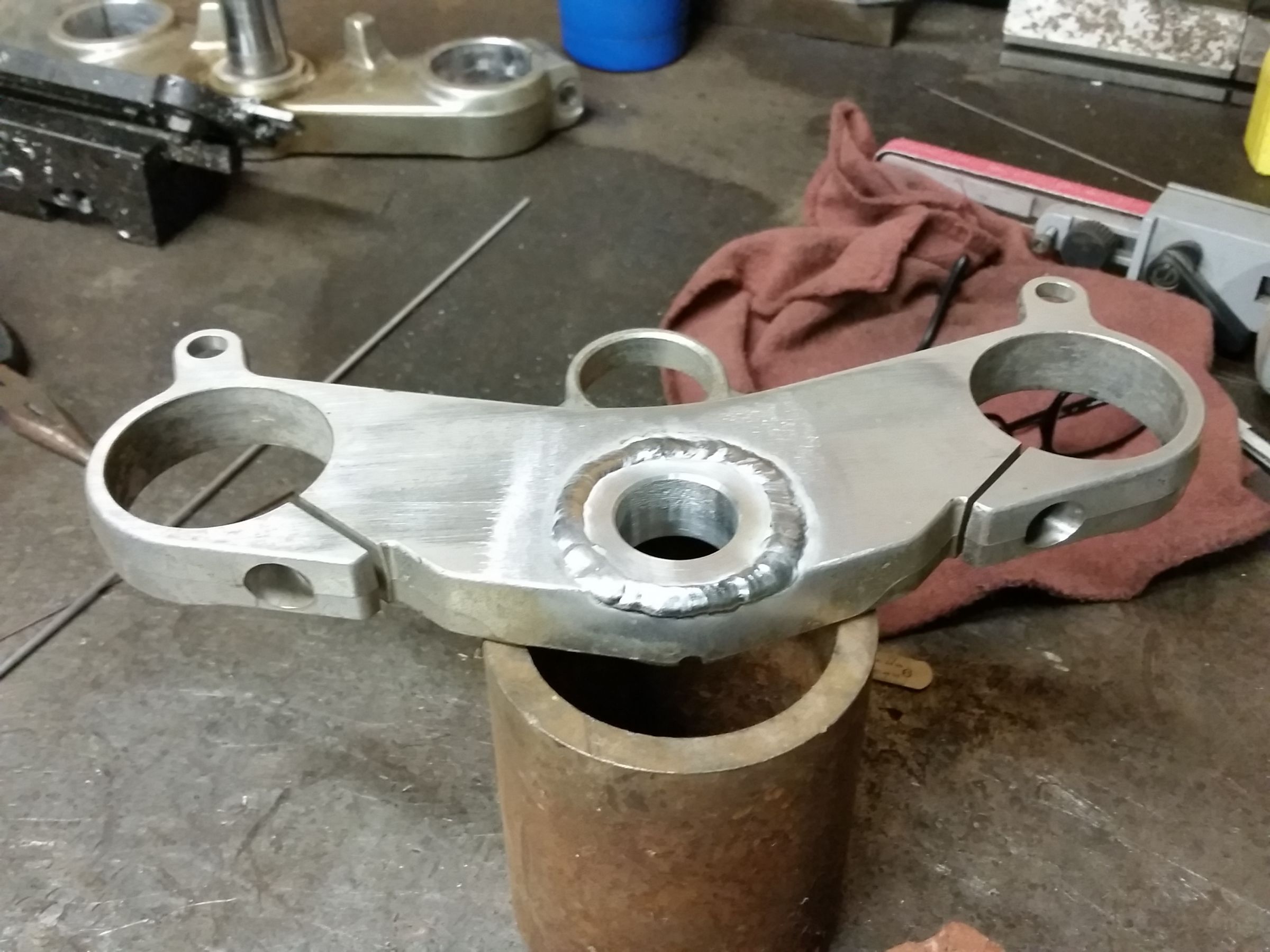

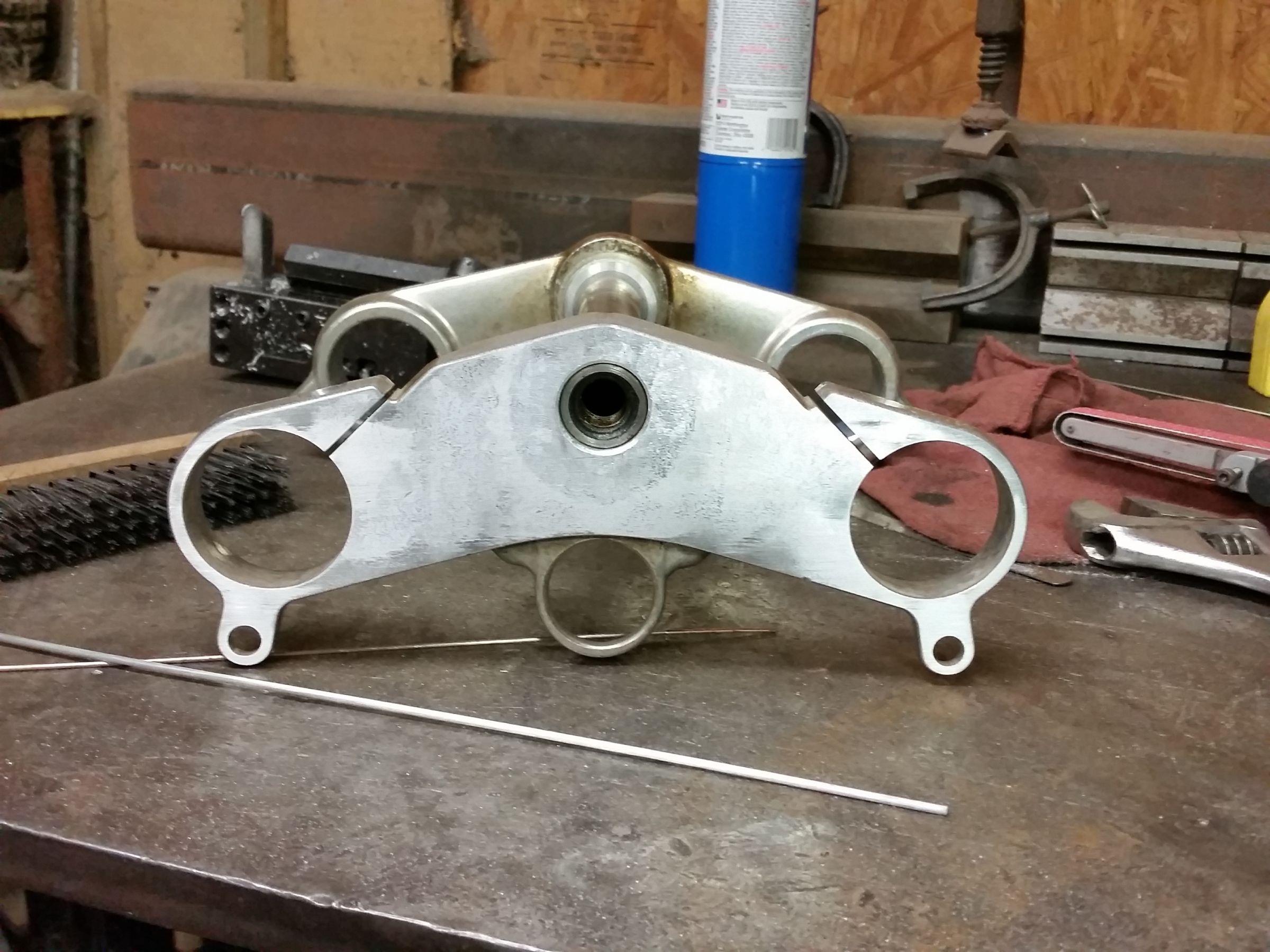

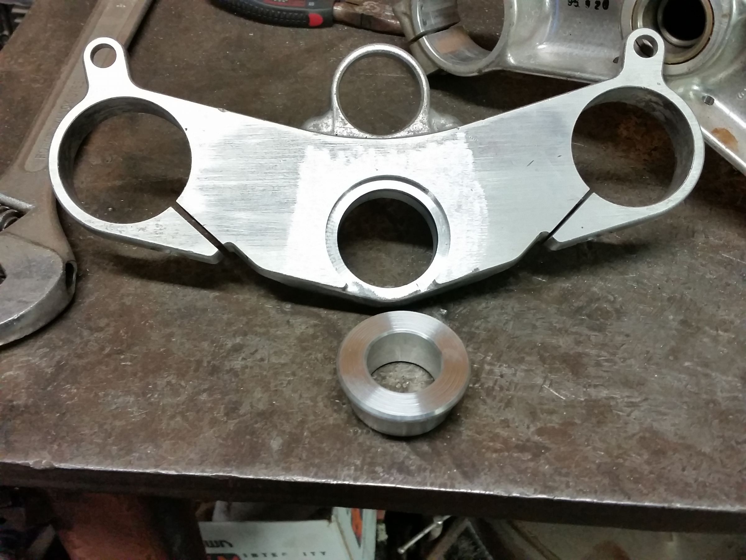

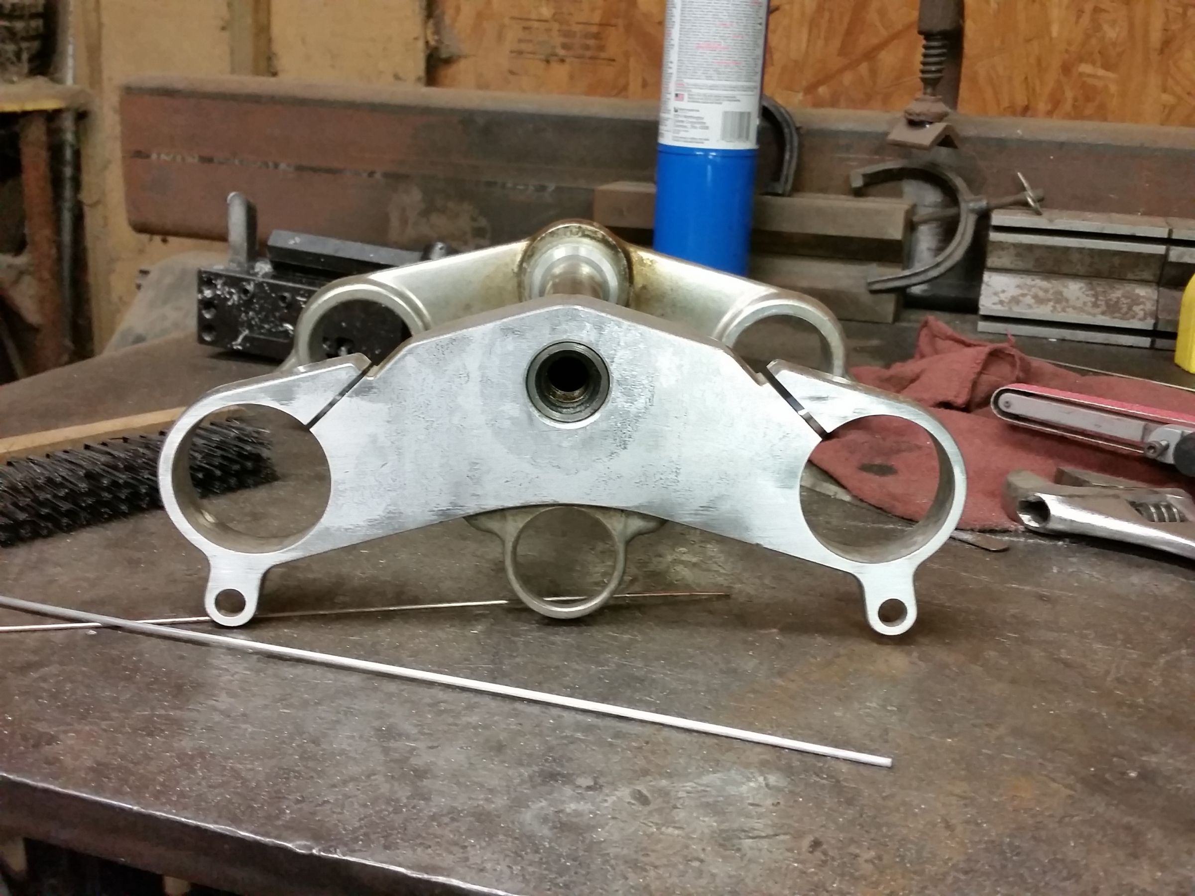

- Posts: 7442
Re: zx9r fork query
12 Jan 2017 06:20
the boss on the bottom of most zx9 upper triples can typically be machined off and a piece of aluminum welded back in and remachined to fit the kz stem and gain about 7/8's of an inch.
it's a jag of work but sometime's an extra 7/8's is worth it. :whistle:
- Posts: 7442
Re: zx9r fork query
12 Jan 2017 06:26
another thing is the older welded in kz stems once removed from the lower triple are typically a press fit for the inside of the zx stem.
so this allows the zx stem to be cut off and machined flush with the lower triple.
sometimes you have to hone the id of the zx stem a little.
then you can press the kz stem into the zx stem that is left thus using the zx stem as the conversion bushing.then reach down inside and weld the two together.
