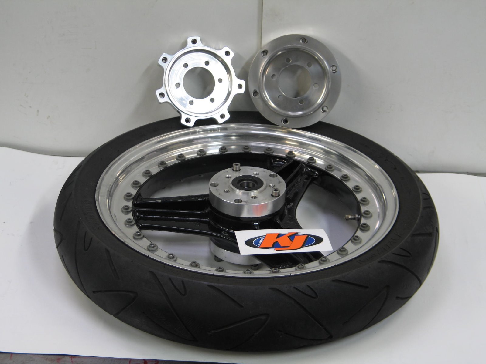

What kind of wheels do you want to use with the ZX9R fork conversion?

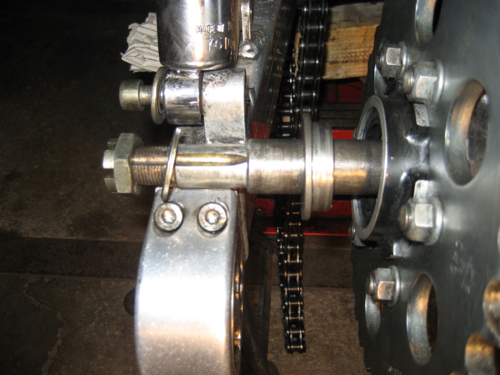

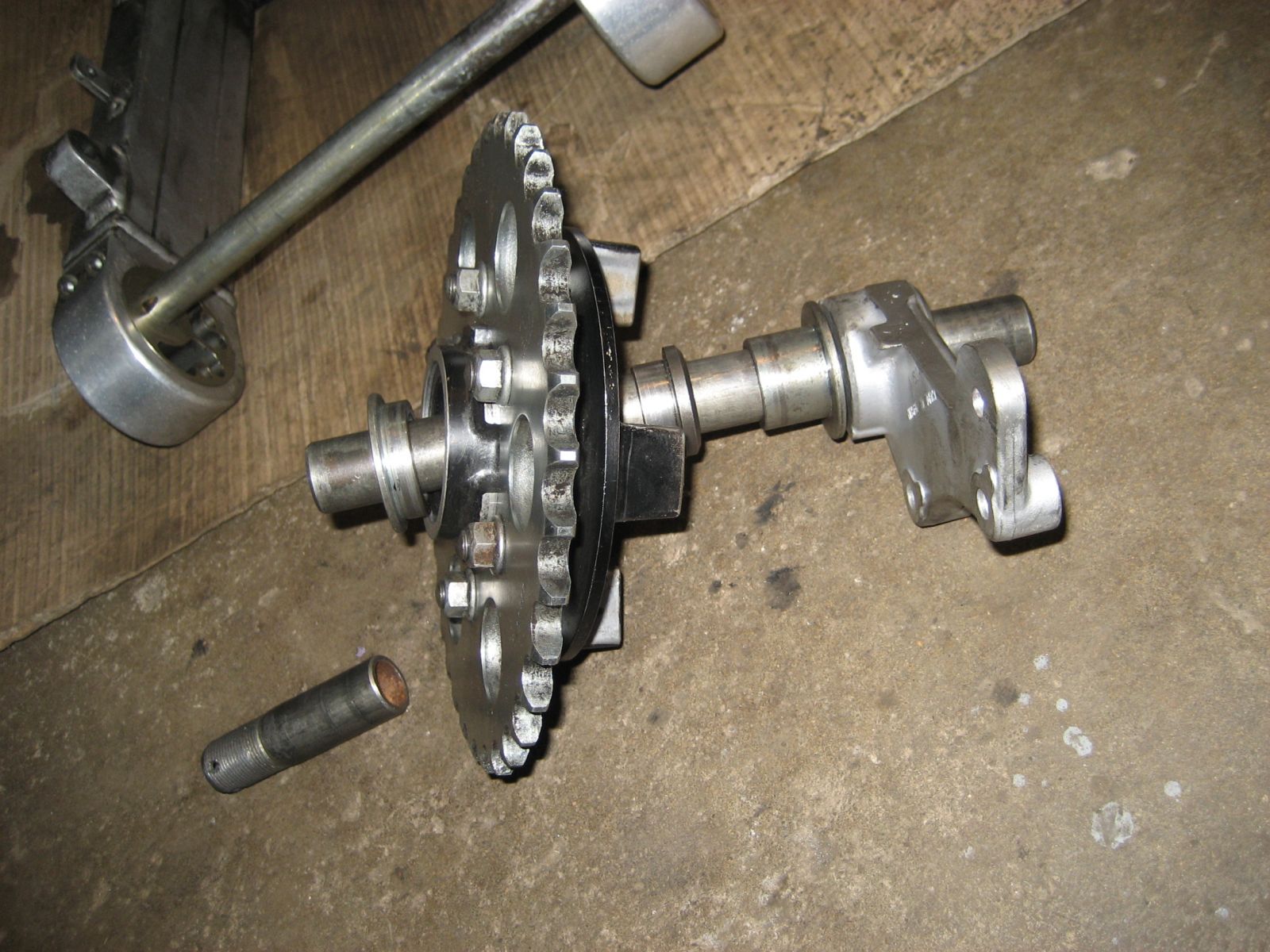

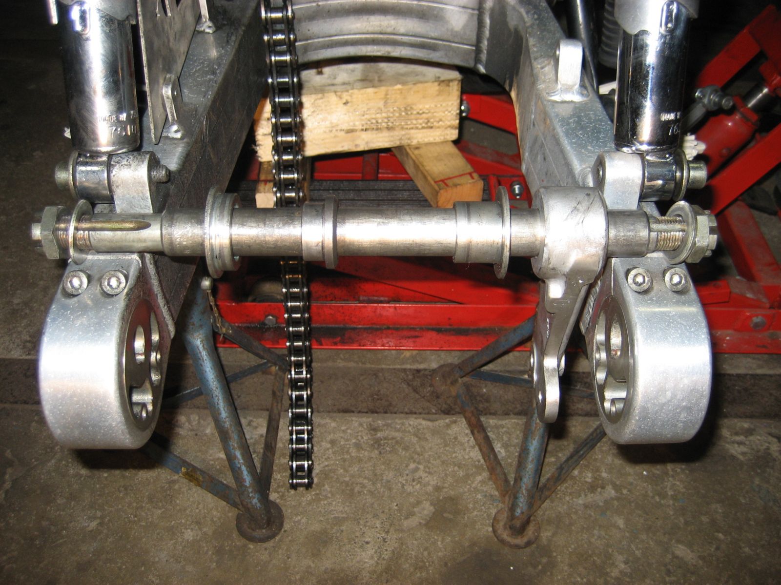

I have to cut the ZX9R rear axle to use it as a bearing (ID) sleeve from 20 mm to 25 mm, so that i can use it for my swing arm eccentric chain adjuster.
So you can do the same for the front conversion, dependent of the wheel setup.

It's going on this Harris magnum GPZ I want to keep it period looking with the 7 spoke alloys. Just want to beef up the front forks from the 36mm ones that are on there. The only problem I see really are the discs. I could fabricate carriers. Can you get dished discs to compensate?
