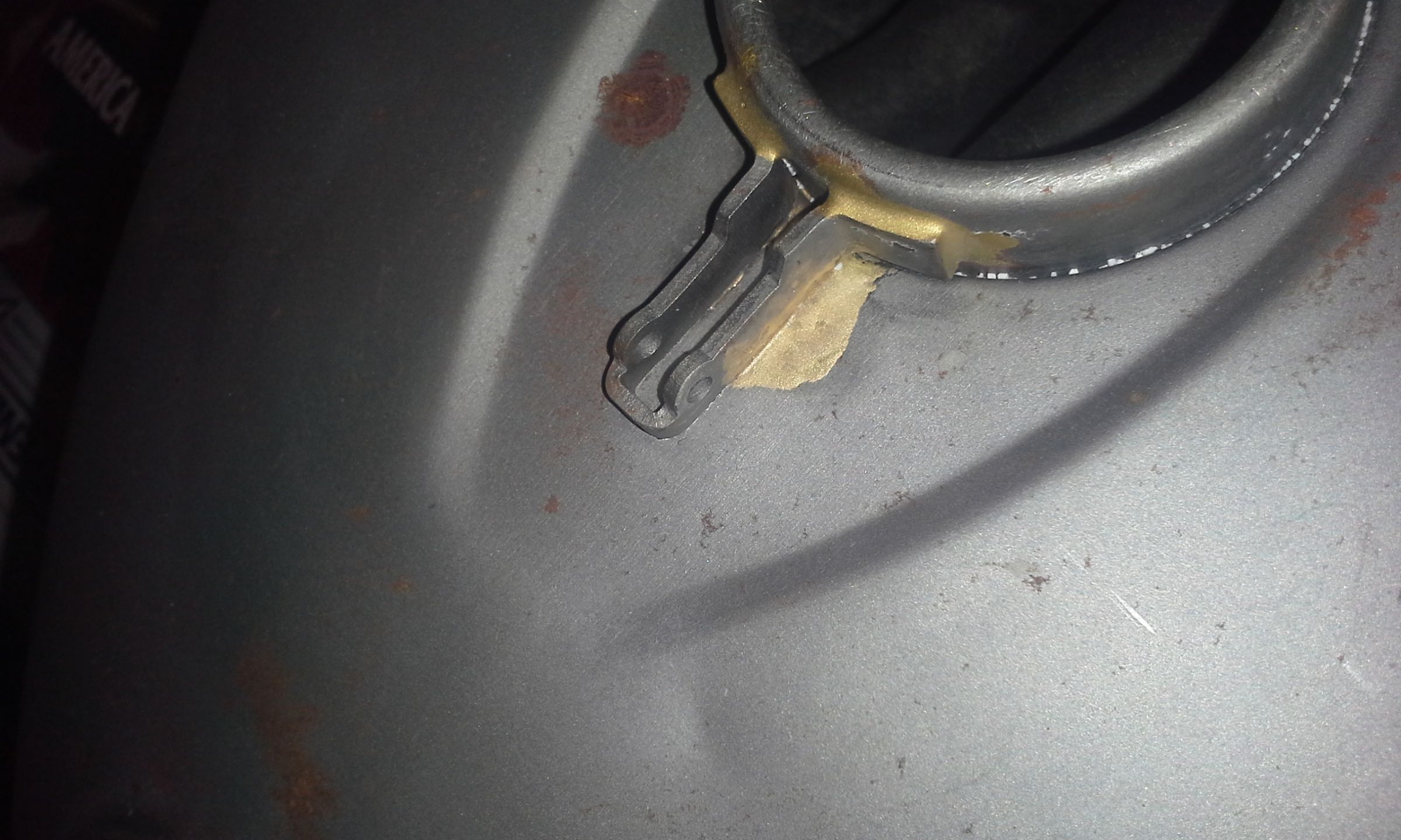

As above picked this up a couple of days ago, the frame is kz1000 ltd, anyone know what the tank is thanks Swirl

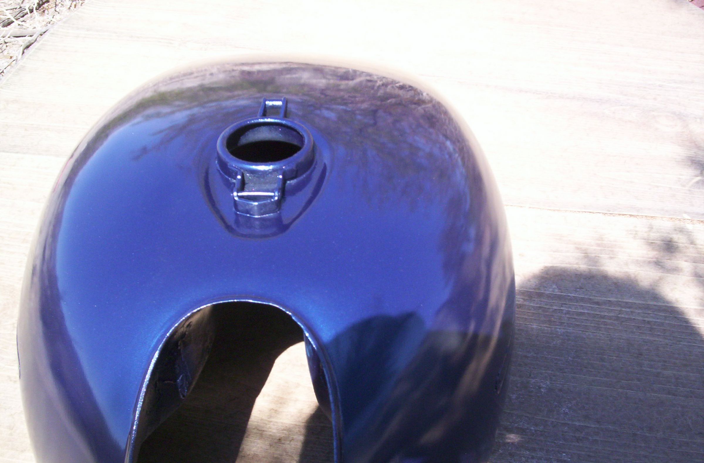

Definitely not a Z1 tank, it has the wrong latch for petrol cap. Its a kz900 or kz1000 depending on the petcock mount. If it has the 22mm threaded type bung you have a good tank. If it has the bolt on petcock you will need a vacuum operated petcock or get a pingel adapter if using non vacuum carbs
this is a Z1 tank front latch mount

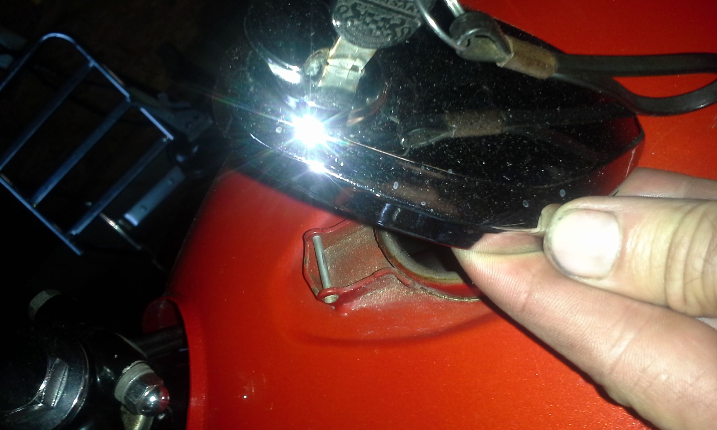

24 Aug 2016 16:54GregZ wrote: Definitely not a Z1 tank, it has the wrong latch for petrol cap. Its a kz900 or kz1000 depending on the petcock mount. If it has the 22mm threaded type bung you have a good tank. If it has the bolt on petcock you will need a vacuum operated petcock or get a pingel adapter if using non vacuum carbs
My Z1 or KZ 900 tanks don't look like that.

One came off a KZ the other is a Z1b tank.
- Posts: 23785
- Thanks: 3050
Re: Help identifying Z tank
24 Aug 2016 18:02
Seems I have a mystery on my hands. I had a latch years ago and went to a key type. After looking at the Z1 tanks both of mine don't have the cutouts on the bottom. Greg, I stand corrected. I had the Z1 tank on the bike in the wreck and a wrecked KZ 900 for parts. Question is where did I get two late model tanks? THAT's gonna bug me.

I couldn't tell from the blurry pictures, but greg nails it like usual.
The bolt on petcock style tanks I usually use some 1/4" thick aluminum and a 3/8 npt tap to make my own adapter, but there actually are some $30 or so manual petcocks that fit those tanks. I can't vouch for their quality (it's sitting on my parts shelf in my shed, behind my H2) but it's an option
