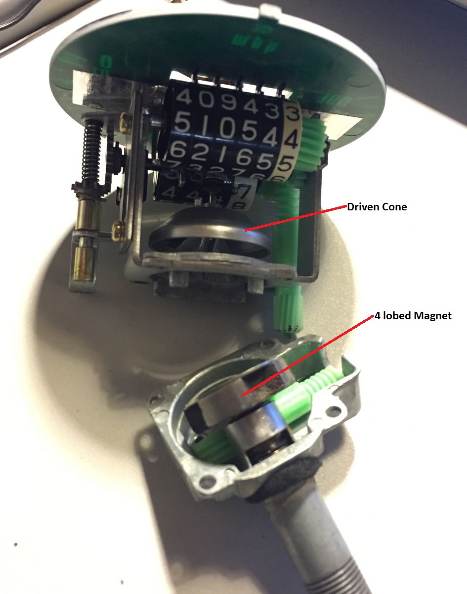

The Z1 and KZ dampers are solid and won't turn on their own. I've had them apart and this is what I learned about them. They are weights and aren't interchangeable between the Tach and Speedo. I tried it. I have a few taken apart at home and will put up pics when I can.

Yeah I've taken a couple apart. The balance between the drive (and depth) plus that four lobe magnet, cone and return spring seem to be the glitch.

It's the pivot where the shaft fits that gets hoged out. TTY in a few hours.
