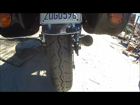

Re: Anyone use shinko 712 tires?
26 Jun 2016 18:27
Bruce and afew others run them and like them. I run the 230's. 110/90-19 front, 130/90-18 rear. I ran the 120 the last 6 months and just installed the 130 this time around. The bike handles better on dirt roads with the larger tire on the rear Looks better too.
Steve.

Steve, forgive me for being a jerk but those sizes are too big for the rims. Yes, you can get away with them, but that doesn't mean they are recommended.
The front rim is 1.85 and the rear is 2.15. Go check some tire maker recommendations and they typically recommend some pretty skinny sizes on those size rims. Kawasaki was really pushing the envelop by specing a 120 on the rear.
26 Jun 2016 18:59
They work well for me.
