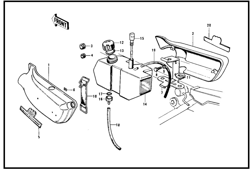

Remember these on the original 1973 Z1 :woohoo:
Per Dave Marsden:
[Original text in all caps]
ANOTHER FIRST ON THE Z1 WAS THE FITTING OF AN AUTOMATIC CHAIN OILER. UNDERNEATH THE LEFT HAND SIDE PANEL WAS A WHITE PLASTIC TANK WHICH HELD SAE 90 GEAR OIL. A RUBBER RETAINING STRAP HELD THIS TO A BRACKET. A DECAL WAS STUCK ONTO THE TANK STATING WHICH OIL WAS TO BE USED TO FILL IT UP WITH.
ON TOP OF THE TANK WAS A BLACK, SCREW-ON, FILLER CAP AND A BLACK RUBBER DIPSTICK FOR CHECKING THE OIL LEVEL WHEN THE SIDE PANEL WAS FITTED.
A BLACK VINYL OVERFLOW PIPE RAN UPWARDS FROM THE TOP OF THE TANK, OVER THE SIDE OF THE TOOLBOX AND DOWN TOWARDS THE SWING ARM. A SMALL FILTER SCREWED TO THE BOTTOM OF THE TANK AND FROM THIS LED A BLACK VINYL PIPE. THIS FED A SMALL PUMP IN THE RIGHT HAND ENGINE CASING WHICH IN TURN SPLASH FED THE FRONT SPROCKET WITH OIL. THE DRIVE FOR THIS PUMP CAME FROM A SMALL PIN SITUATED IN THE END OF THE GEARBOX OUTPUT SHAFT.
THIS IN TURN LUBRICATED THE DRIVE CHAIN. THIS PROVED TO BE A VERY MESSY SYSTEM, BUT THE PUMP WAS ADJUSTABLE AND COULD BE REGULATED TO A MERE TRICKLE. OWNERS PREFERRED THIS SETTING BECAUSE THEIR PRIDE AND JOY LOOKED A LOT CLEANER. HOWEVER, THE PRICE TO PAY FOR THIS WAS EXTREME EXCESSIVE WEAR ON THE DRIVE CHAIN. SOME OWNERS WERE APPALLED TO FIND OUT THEY NEEDED TO REPLACE THE CHAIN WITHIN 5000 MILES! KAWASAKI CAME TO THE RESCUE AND REPLACED MOST CHAINS UNDER WARRANTY. IT BECAME APPARENT TO THEM HOWEVER THAT THEY WERE ON A LOSER, SO A REVISED INFORMATION STICKER WAS ATTACHED TO THE BIKES ON THE PRODUCTION LINE STATING THAT A REPLACEMENT CHAIN WOULD ONLY BE ALLOWED ON MACHINES THAT HAD COVERED UNDER 3000 MILES! ONLY ONE CHAIN PLUS THE ORIGINAL WAS ALLOWED PER BIKE.
MOST OWNERS RAN THE OILER DRY AND RESORTED TO MANUALLY LUBRICATING THE CHAIN THEMSELVES.
IN MARCH 1974, KAWASAKI RELEASED A SERVICE BULLETIN CONCERNING THE REPLACEMENT OF THE DRIVE CHAIN OIL PUMP. DUE TO DIFFICULTIES IN ADJUSTING THE PUMP BY SOME OWNERS, KAWASAKI MODIFIED IT GIVING IT THE NEW PART NUMBER 16082-056. THIS PUMP WAS MUCH EASIER TO ADJUST.
KAWASAKI FITTED THE NEW PUMP TO ALL BIKES ON THE PRODUCTION LINE FROM FRAME NUMBER Z1F-039150 ONWARDS.
[1975 Z1-B]
REAR DRIVE CHAIN AND SPROCKETS:
DUE TO COMPLAINTS OF THE DIFFICULTIES IN USING THE AUTOMATIC CHAIN OILERS OF PREVIOUS MODELS, THE Z1-B WAS FITTED WITH AN O`RING CHAIN. ANOTHER FIRST FOR KAWASAKI. THE NON O`RING CHAIN WAS NOT REALLY UP THE JOB ANYWAY, SO THIS WAS A GOOD MOVE.
THE WHOLE OF THE CHAIN OILER SYSTEM WAS REMOVED.

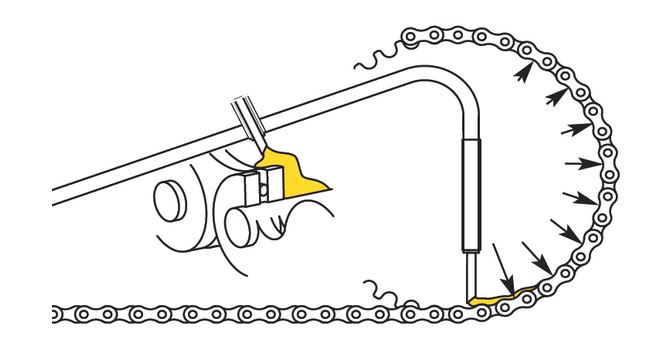

I did get a cool tip from their site on where to oil though, makes sense to me anyway
