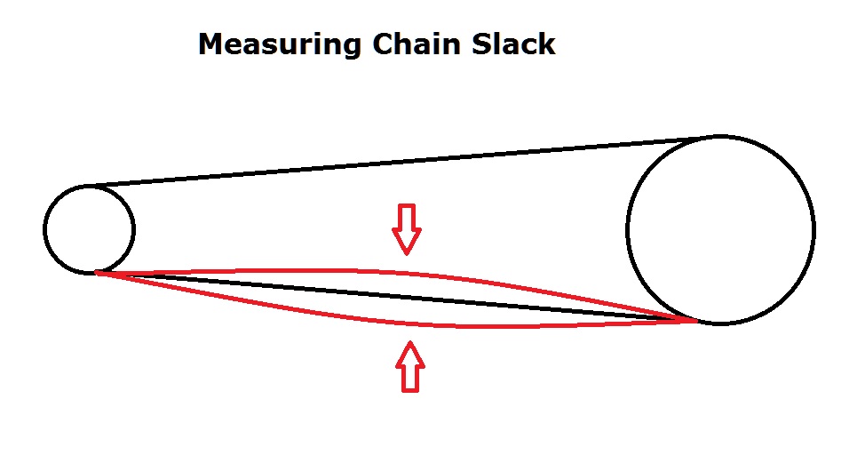

23 Apr 2016 10:0382KZ305Belt wrote: I've always measured the 25-30 mm from slack up to where its tightish . . .
I have re-evaluated the diagram in the manual and its pretty clear I should have been measuring it from a pressed-down to a pressed-up position.
Yes. Measure chain slack between pressed up and pressed down position mid-way along the bottom run.

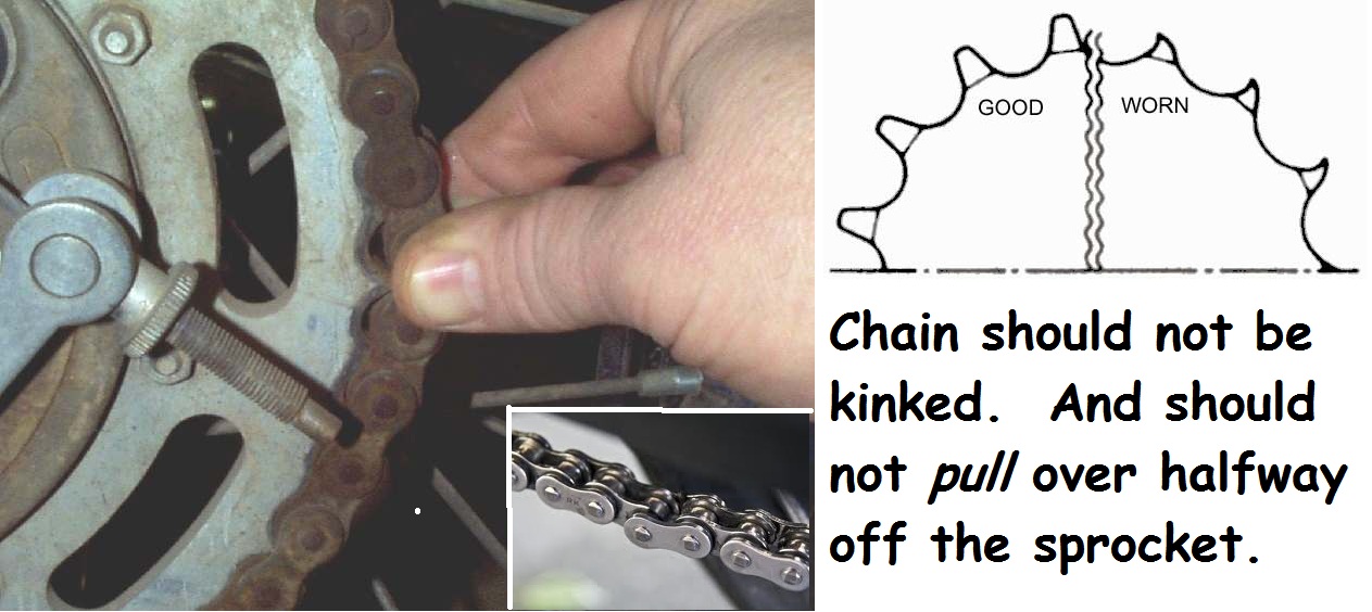

The manual likely mentions that "the chain wears unevenly," which uneven wear may produce less slack at different rear wheel positions. Perhaps uneven chain wear is more evident in heavier higher horsepower models that produce more pulling force on the chain. I would expect a perfectly maintained high quality drive chain on a KZ305 to remain serviceable for a very long time.
The manuals with which I'm familiar call for lubing the chain before measuring slack, and include diagrams showing slack being measured in the bottom run. Sometimes there's accompanying text specifying the bottom run. Sometimes not.
Nevertheless, I believe measuring the top run is okay, and should produce equivalent results where the bottom run is being held slightly taut.

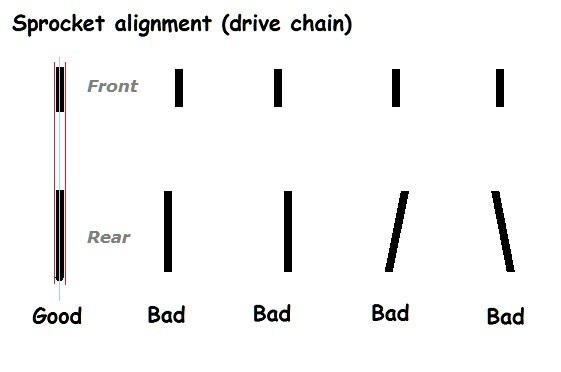

And chain "alignment" is also very important.
The manual may provide the means for measuring chain stretch, and how much stretch is acceptable.
For example, the original Z1 chain was measured by hanging a 20 lb weight at the end and measuring the length of 20 links, with replacement needed if the distance from the center of the first pin to the center of the 21st pin exceeded 15 5/16ths inches (389mm).
Or simply the amount pf pullaway from the rear sprocket.

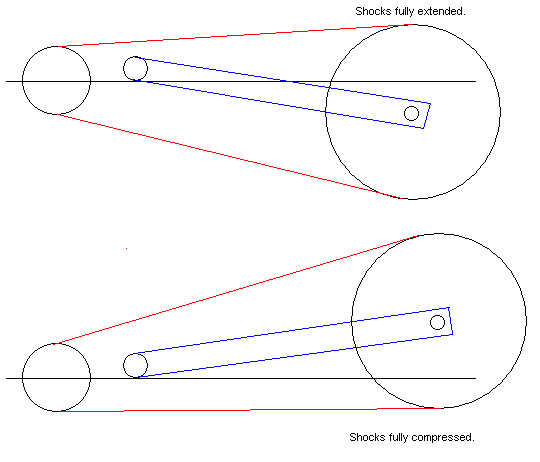

The layout of the sprocket centers and the swingarm pivot are called the anti-squat geometry. You can google "anti-squat geometry" for more details.
Notice those 3 points are not in line with each other at all times. They form a triangle. As the wheel moves upward, they become more into alignment. When that happens, the geometry forces the sprockets to get further apart. Obviously that will tension the chain (or take up the slack). This happens every time you hit a bump. If the suspension has been altered, the position where the chain is adjusted needs to be altered accordingly, or the actual tension needs to be adjusted accordingly.
If the manual specifies the wheel position while on the centerstand, the wheel's position will be different if the shocks are longer or shorter. Thus the range of chain tension will be different from what the manual is expecting.
It's not a critically precise adjustment, so a little extra slop is safer than too tight.
So why "anti-squat"?
A bike tends to squat down when you accelerate.
When the rear squats, the chain tension increases as described earlier.
Now notice what happens if we increase the chain tension by trying to accelerate the bike. The engine pulls on the top section of chain. This has the effect of trying to pull the sprockets closer together. When this happens, the rear wheel tries to move down, jacking up the rear of the bike. This works against the squatting, thus it is called "anti-squat".
Getting a good launch, without wheelieing, and without spinning the tire, depends a lot on how much antisquat you have to start with. The more jacked up the rear end is while sitting at rest, the more it will tend to wheelie. With less antisquat, it will tend to spin the tire more.
Some bikes are designed with minimal antisquat. If you make the swingarm pivot concentric with the front sprocket, there is zero anti-squat effect. The bike would then rely entirely on the suspension to maintain the rear-end height during a launch.
Since your bike was originally a belt drive, which is designed to run with no slack, they may have designed it for minimal anti-squat in order to minimize the stresses from stretching and releasing the belt. That way the belt might last longer.

Standard chains have a nasty habit of developing kinks and tight spots. When you adjust it, you have to turn the wheel and watch the chain being sure there is slack all the way around. Best to lube the chain hot then check the adjustment.
