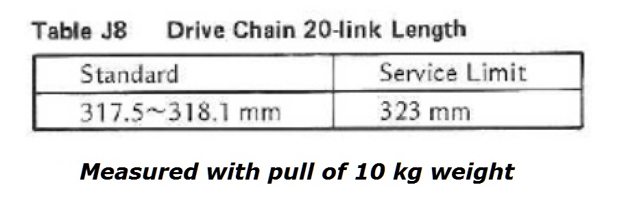

30 Apr 2016 02:1282KZ305Belt wrote: . . . the instructions for my chain are on page 24 here.
www.scribd.com/doc/34889983/Kawasaki-KZ-...-a-82-Service-Manual
And information about chain stretch parameters is on page 144, which also include the following chart:
The FSM refers to a non-o'ring chain, but which would in my opinion also apply to an o'ring version.
I wouldn't expect a relatively fresh well-maintained final drive chain to exhibit a very noticeable "tightest position" due to "uneven chain wear" on any model motorcycle.
If the chain at hand is kink-free, well lubed, not worn past the specified stretch limits, and passes the rear sprocket pull-away test, and the slack is adjusted within spec at mid-way between either lower or upper run, you are in my opinion good to go.
The instructions in the FSM at hand are typical of the instructions shown in all the Kawasaki Factory Service Manuals with which I'm familiar.
Failure to exhibit a noticeable "tightest position" should be welcomed as an indication of good chain condition.
Precise sprocket alignment is also a "best practice" condition.
