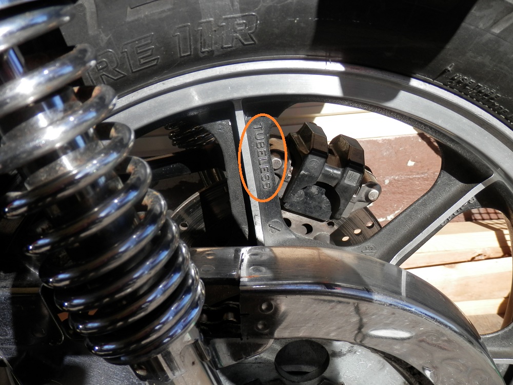

Does it say TUBELESS on the spoke or rim ?
Look for something like this below
This is my rear wheel. Front is the same.
I dont have any experience with a 550 but others have posted that tubes should be used on the 550 unless a PO has made changes
