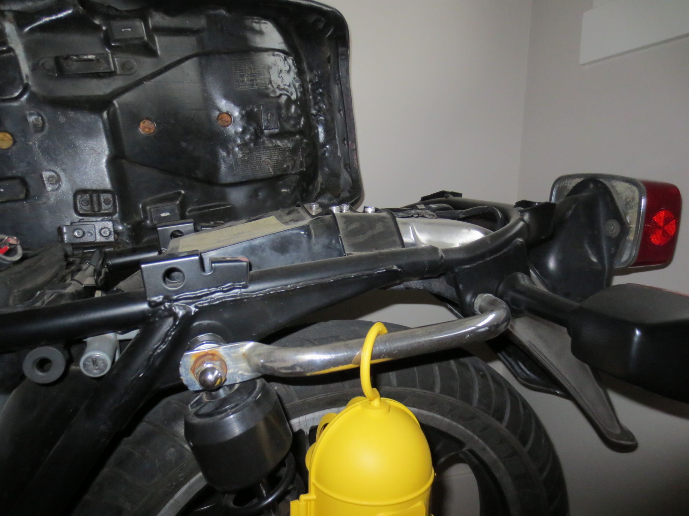

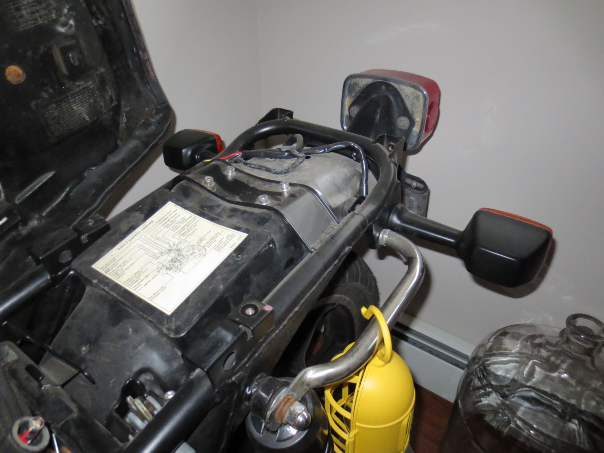

02 Mar 2016 15:21 - 02 Mar 2016 15:22I suppose you'd expect the frames to be the same, but I think they are not. Unless it is just a trick of the light, I reckon that the end bit of my frame does not turn up as much as Eds' C1, It lies much flatter, and also the flat bit of metal that forms the mounting bracket for the rear fender on mine is concave, and has a rib on the front and back edge which faces UP.
Now, unless someone went to a lot of trouble to make these very slight modifications, and make the paint (before it went away and got replaced with powdercoat, anyway....) and welding look just exactly like factory, I have to assume that this is stock. Not to be contrary, I've just struggled to find a seat pan that works perfectly on my bike, and didn't really want to make one. It also might explain why the one I have looks like it was pounded in with a hammer a little on the back end. The other seat pan I have doesn't *quite* come low enough for the rear rubber bumper to sit on the above mentioned cross member. It hangs about a half inch or so high. So, either I was sold a '77 seat, which from the look of it, would fit Ed's bike like a charm, or there is something just a little funny about my '78. Dunno.
Any thoughts would be appreciated. I will certainly try to buy the next seat in person to assure fitment, that is for sure. Or maybe I will just do the same as the person who modified my current seat, and just take a hammer to the new one until it fits properly. Have to decide when I get back to my shop. Might be a while before that happens, so no worry.
Jon
PS - Anyone have a stock type seat they figure will fit my frame they want to be rid of? :whistle:

Not stock. They don't use pop rivets. If you straighten the flat plate, will the seat fit?

Interesting. My frame definitely looks like it tilts up more in the rear than yours . Here's another photo from a different angle. Ed
