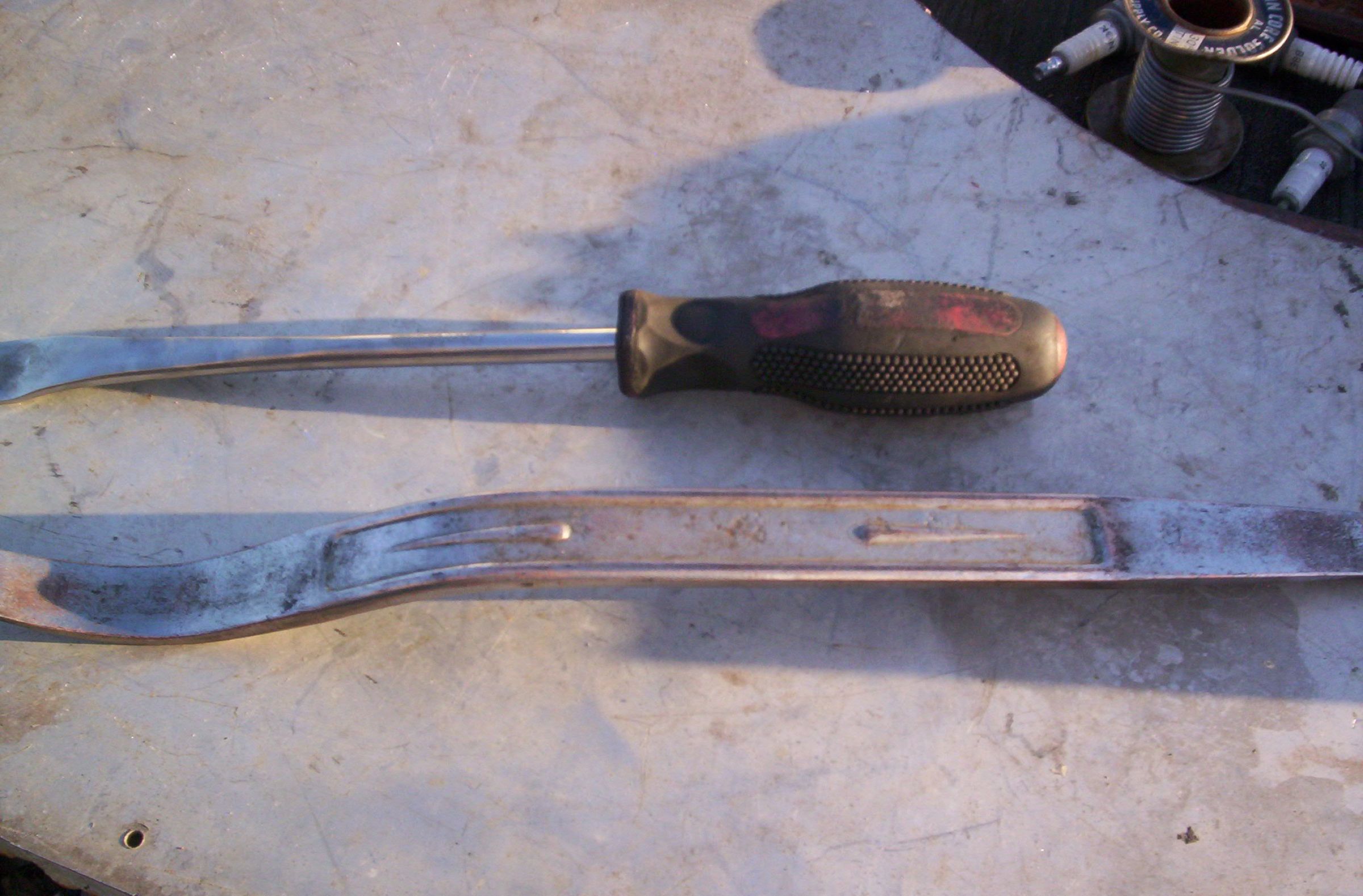

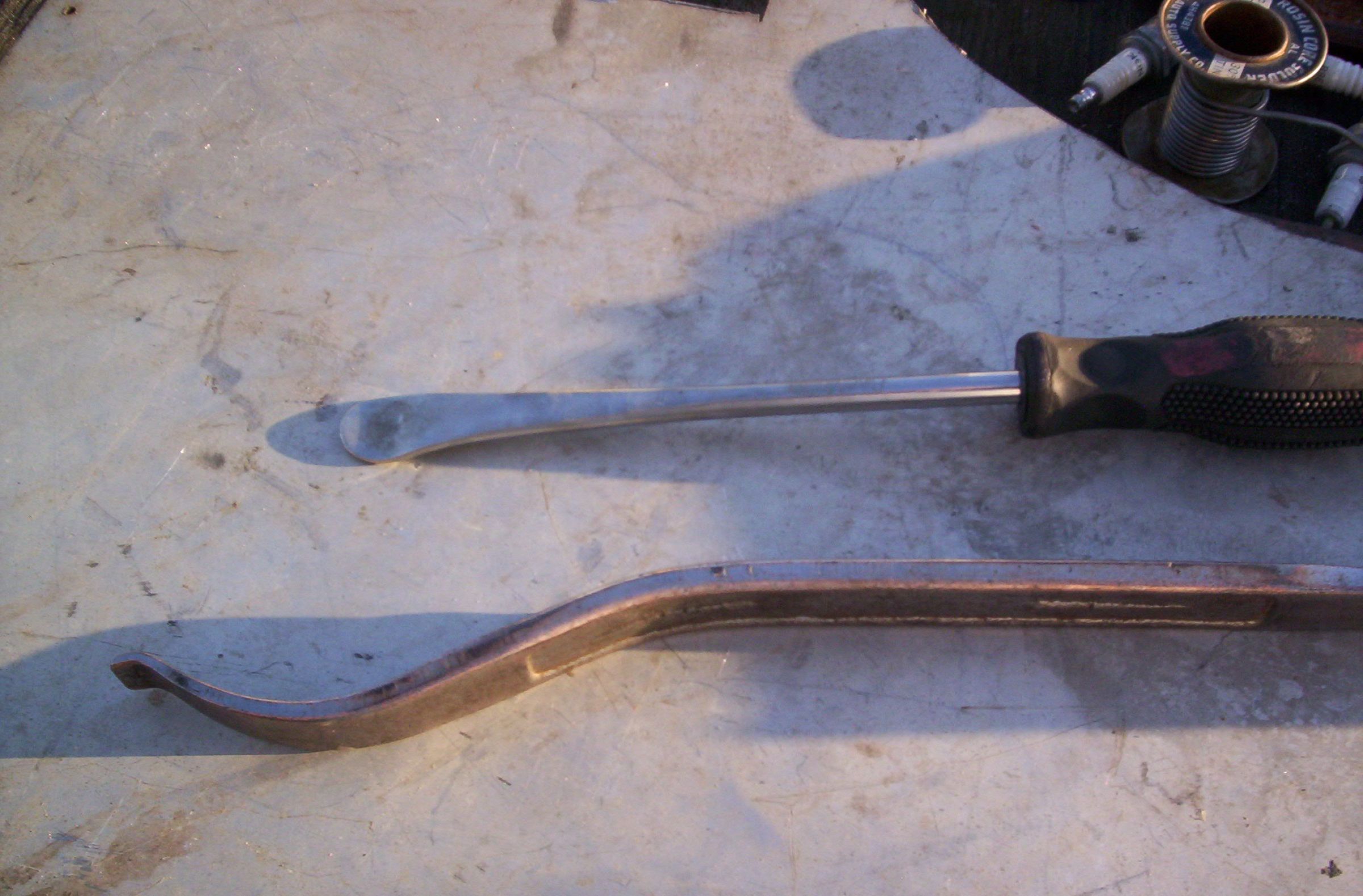

I've been changing my tires since I was 18. Yeah it's a PITA but you need to know how to do it. I use these.
The scoop is for working around the tire. Less chance of pinching the tube. The longer is for starting and prying the old tire off the rim.
With a little practice, you'll be a pro in no time.

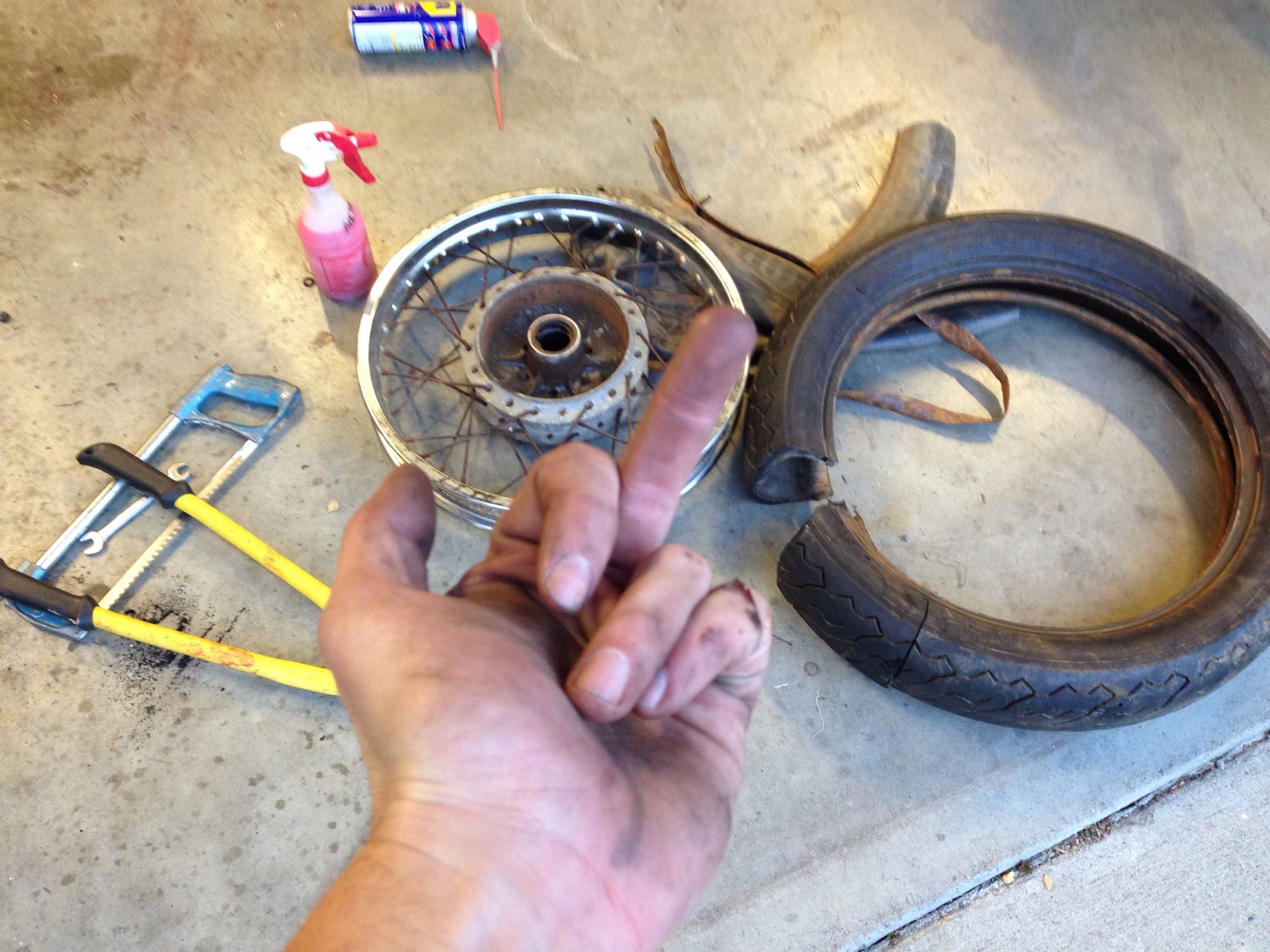

24 Feb 2016 20:51 - 24 Feb 2016 20:52Sardonicus wrote: Thank you for the information. Tire irons, lube, tube - aside from the tire is there anything else I need?
Another rim related question. The spokes on mine are quite rusted, but from what I can see they are not bent or anything. At what point do I have to do something with them? Are they even replaceable?
if the wheel is really bad and you want to save your money for other potential problems that you haven't found yet you can give the wheels a sand and paint them. That will hold up for a while and look OK.
I have been changing my own tires for a couple years now and its really not that hard. I use three 16" tire irons for maximum leverage., and a set of rim protectors. Getting the tires on is the easy part. Getting your ancient dry rotted tires off is gonna be the hard part. This tire was older than me....
