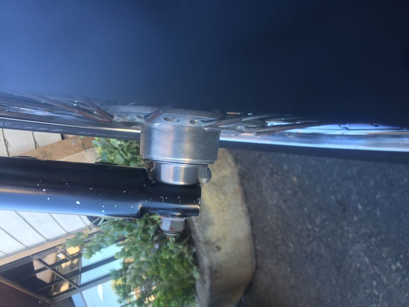

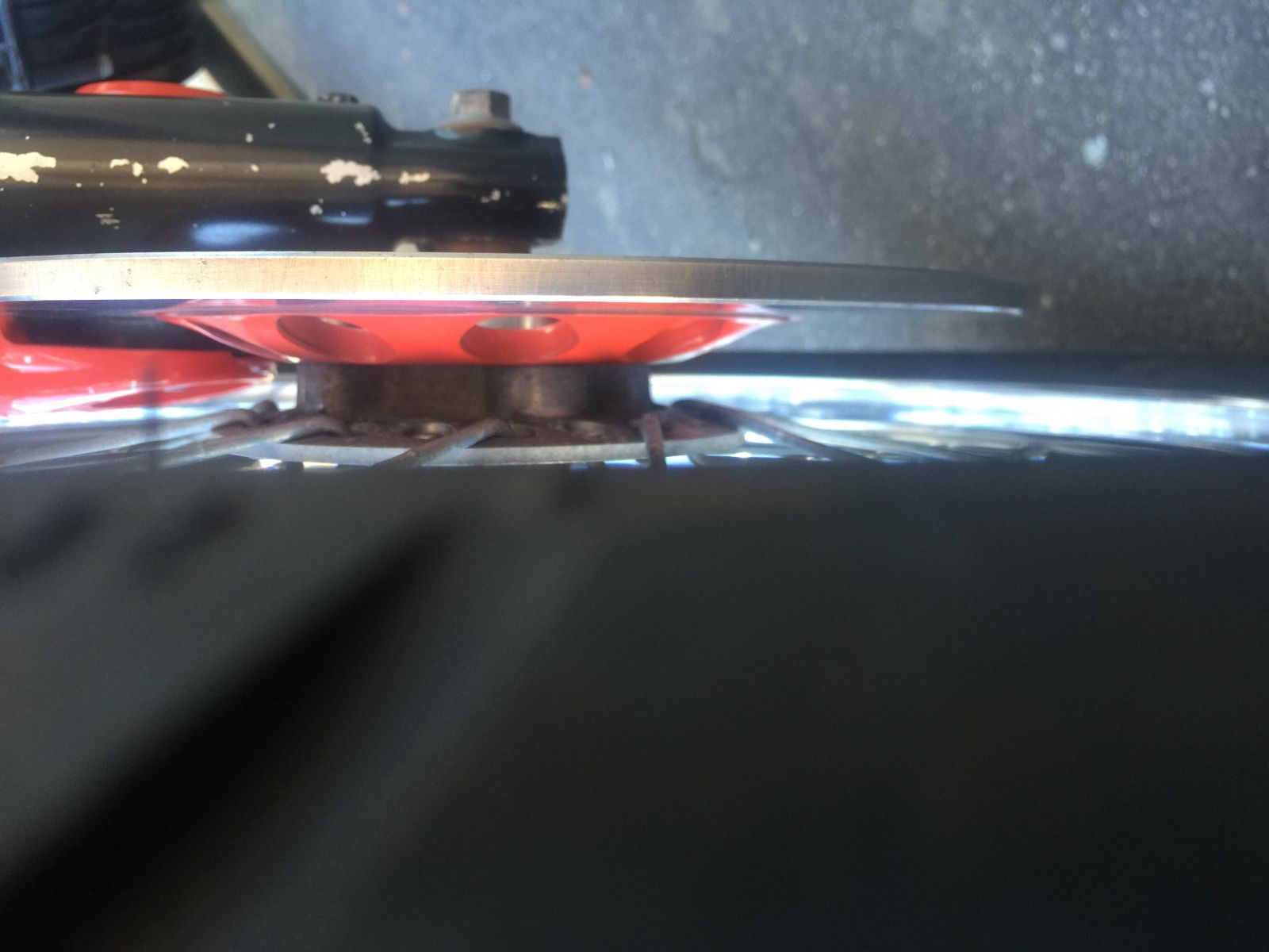

29 Jan 2016 21:14
ok so this is why I'm "NOT" gonna be able to use the wheel (kz400) I have now to add another rotor on the right.
The side I would like to add the rotor to.
Left side for comparison.
I do need to replace the the spokes front and back so now considering going disc out back as well after reading some horror stories of the rear lining falling apart from age degradation. So I got some researching to do..
ed
