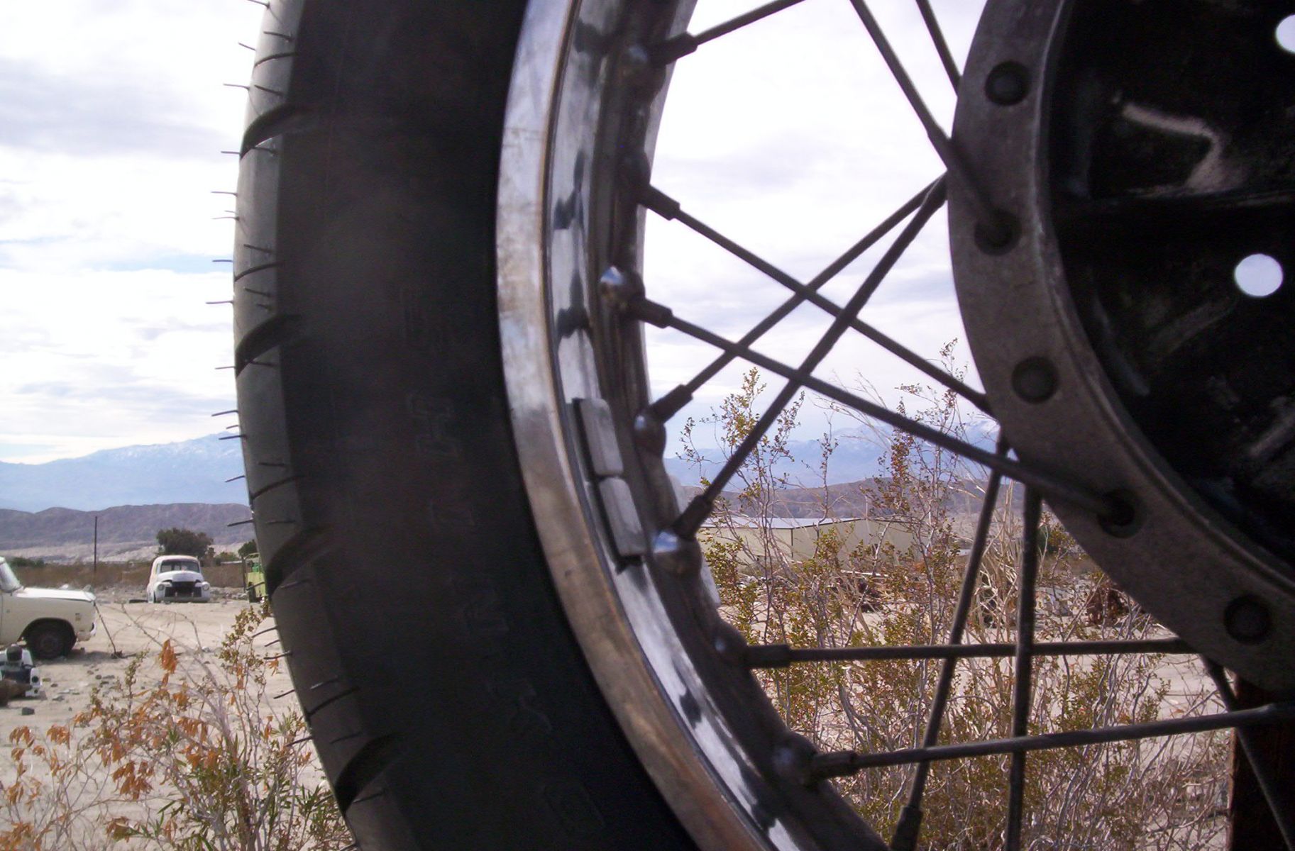

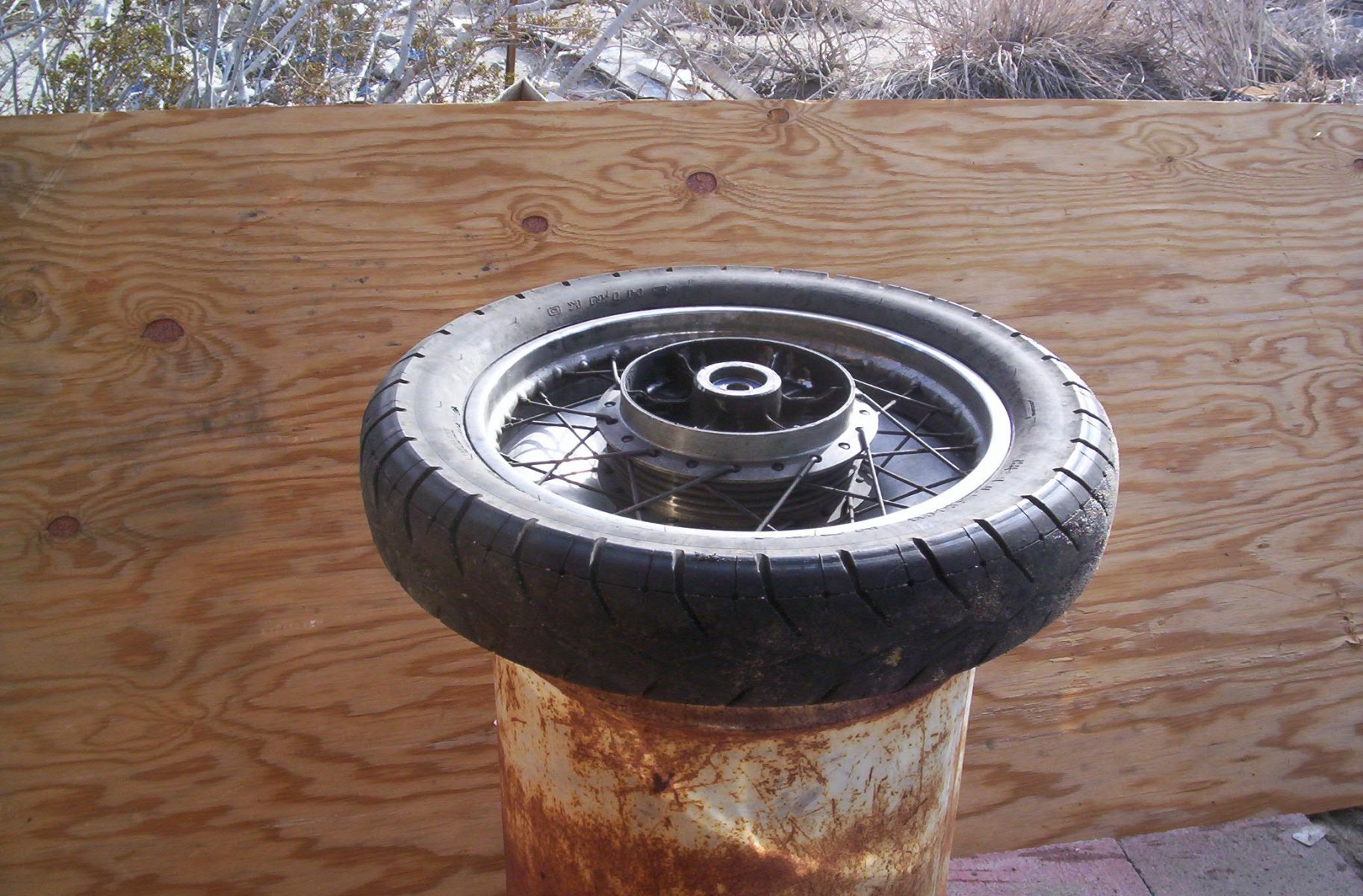

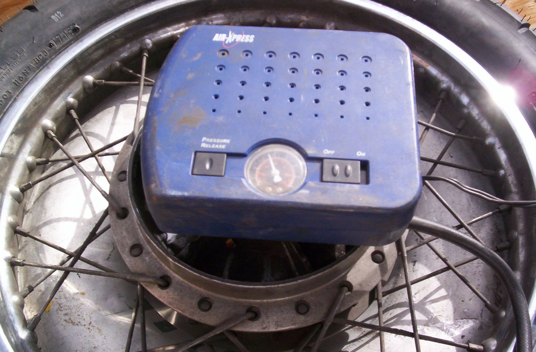

Re: Tires
13 Jan 2016 10:14
#706586
Got my new Shinko tire mounted and balanced. 120/90-18 Shinko, 1 1/4 OZ weights. Cleaning and lubing the brake cam among other things. Taking my time. Noticed a little play in the swing arm. While I'm at it I'm going to size up the swing arm I cut. I'll post those results in my swing arm thread.
I think I got my moneys worth. :whistle:
Held pressure for 20 minutes.
I'm going to weld me up a new stand. This one is 30 years old.
