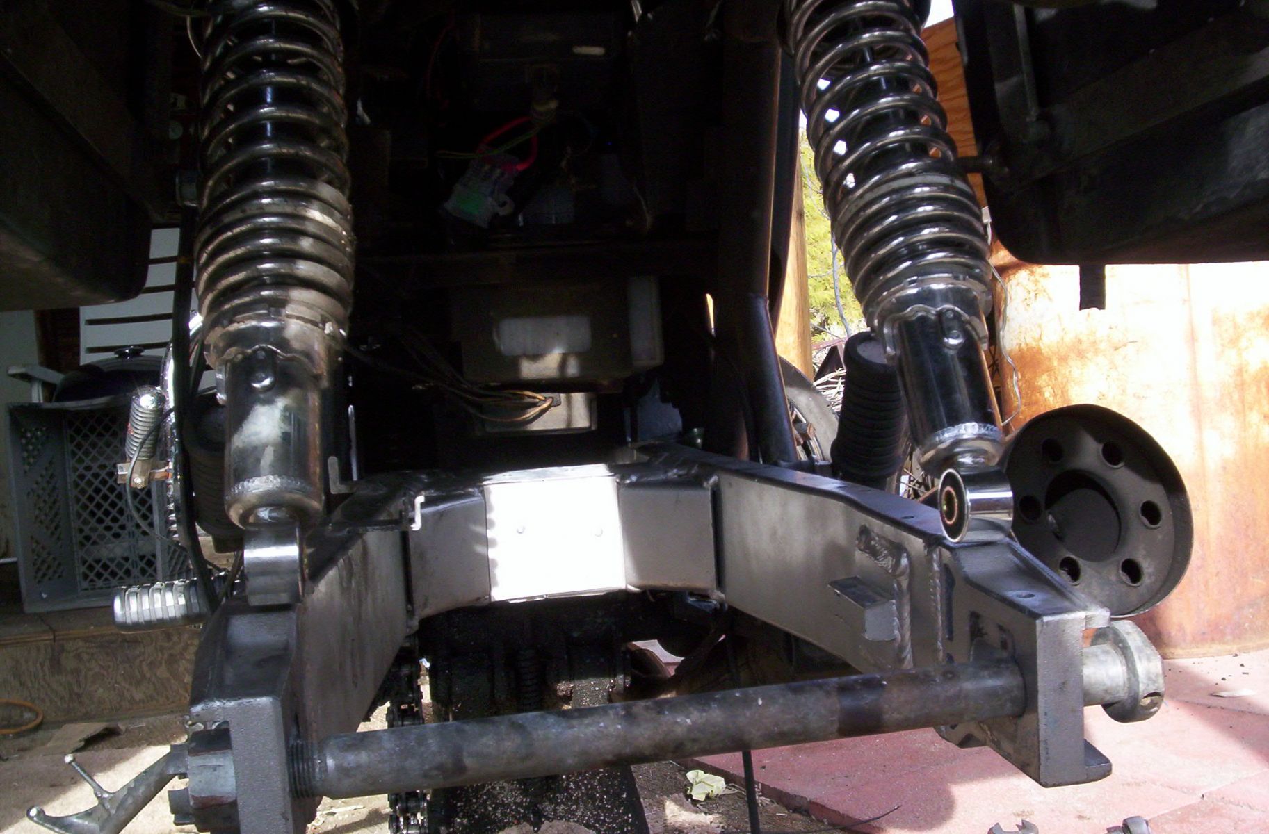

Got the swing arm and wheel back on yesterday. I can't help thinking I made a mistake buying the smaller tire. I have a 110/90-19 up front and now a 120/90-18 in back. I painted the arm so it looks good and found some loose connections so this morning I'm going out to take care of that. Windy today and will have to ride to the store later when it's done. Guess I'll find out how well it handles in windy conditions.
I'll have 6 months to have my new arm modified and welded. It will except a much larger tire and maybe I'll try my hand at lacing a larger rim and mount a larger tire then. :dry:
