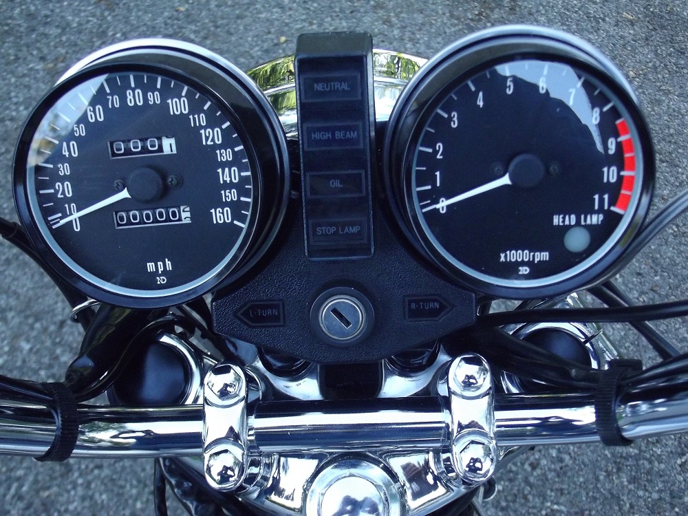

I had bought an older banged up 160 MPH gauge to replace the 80 MPH gauge that came stock on my 80 LTD 1000 a few yrs. ago & sent it along with my tach to Z Resto to get rebuilt, & it cost less than the aftermarket ones, I'm very happy with the job they did
This is what they looked like when I got them back, a few yrs. ago
www.google.com/url?sa=t&rct=j&q=&esrc=s&...m=bv.118443451,d.eWE
Pete
Pete

Mine work good and are pretty decent still but those moisture drops drive me crazy....
gonna either take em apart or send em in someday..... that pic gets me re thinking it every time Pete and Steve.
