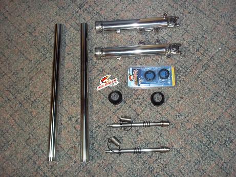

21 Sep 2015 04:57Lower legs have lacquer finish on them. Buy a cheap aerosol can of paint, gasket stripper.Rockranch wrote: I have 3 '76 KZ900's and a '77 KZ1000
And you need to buff with a bench style electric motor buffer at least 3450 rpm's.
I always glass bead my aluminum, then some fine scotch wheels then wet sand with auto paint wet sand paper 400-600 grit.
Good thing you can do forks assembled if your internals are good. Easy to hold, aluminum gets hot!
The machine buffing with the correct compound does it.
Here's a couple of front ends I've sold on ebay over the last few years.
Good luck! Patience and your own labor and sweat equity are free! If you have the time.
