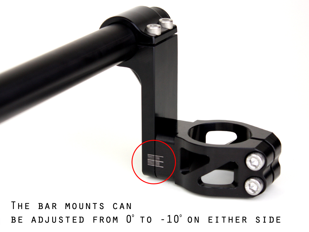

Those are cool Leon. Ever used them or have pics of them on a bike?

gpzmod i haven't ever used them myself.
i did build a steel set that wasn't adjustable but did rise a lil more than those i showed.
but i have no pics of em.

21 Jul 2015 12:19 - 21 Jul 2015 12:21I'd like to see those mounted. It looks like it could put the grips about level with the top of the triple clamp. For my purposes, commuting, I'm thinking somewhere between half way from where they are to level with the tri clamp. Angled the same to straight.531blackbanshee wrote: gpzmod i haven't ever used them myself.
I'd still like to see what others have done regardless of the configuration. My mind might be changed.
