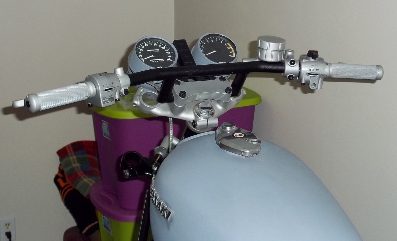

I came across these. Never thought I would like them. They just seem to fit this old project.
They were $31 bucks to my door. They are only 28" end to end 7/8" of course.

The drag bars look great, I hope the handlebar switches clear your tank at full lock. It sucks to dent the tank from having the switches hit them.
z1kzonly's bars look good. I also have a straight set of drag bars about 33 inches wide that I cut to size so that the switches are far enough out to clear the tank.

16 Mar 2016 12:57 - 16 Mar 2016 15:56The switch set in the right just slightly kisses but that is an alignment issue. I need to drill another hole just a little bit behind the first one I did and it should clear.Kapahulu wrote: The drag bars look great, I hope the handlebar switches clear your tank at full lock. It sucks to dent the tank from having the switches hit them.
The left interferes just a little bit more because of the horn button and larger loom coming out but I think I can grind a slight relief and pull the wires tight to the bar and solve that. Otherwise, I will be looking for a lower (higher?) profile switch set for that side.
