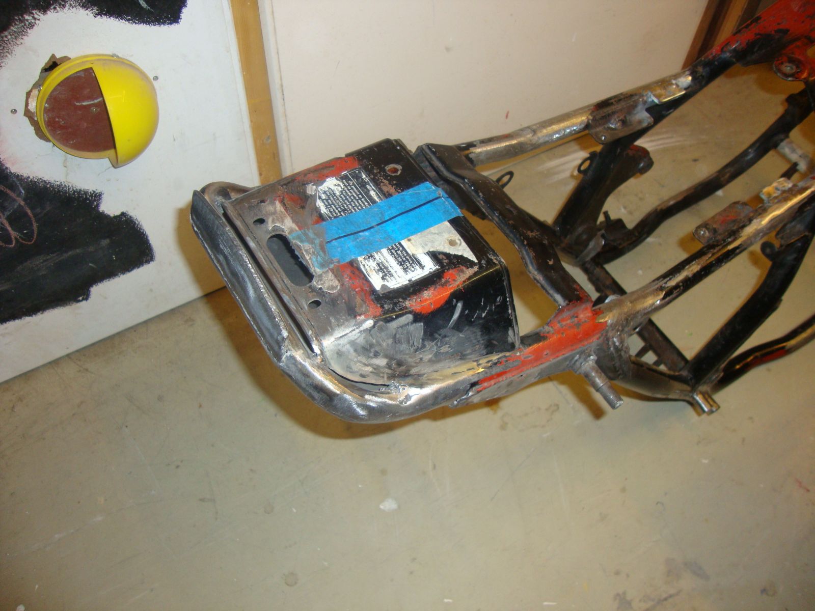

Heres my frame with a shortened arse and the loop welded back in. Its not beautiful (Im not a welder but I thought Id have a go as I also got tired of farming all the work out to other people) but its strong.
Theres also a plate welded in under it to tie everything together

I normally like the factory tail section as is, but that homebrew tail looks good to me. (Good project to try out welding too, since it's not super critical on stresses.) I like it more than the typical rounded loop tails I've been seeing. To me they look a little bit too much riding an ironing board.
