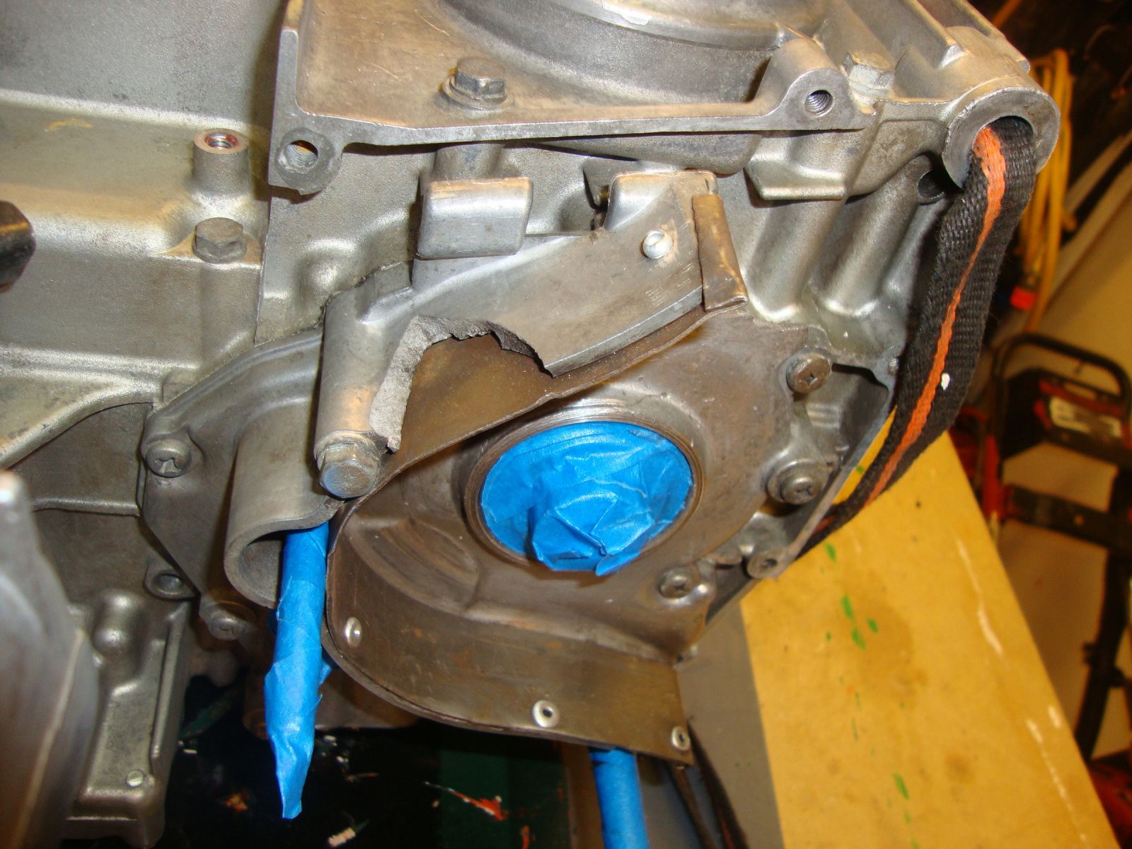

I read that the 1000J motors were prone to losing their front sprocket bolt and my bike shows the scars of just this.
Kawasaki came out with an aftermarket safety clip thing to remedy this. I bought one from ZPower last year.Its still in the bag.I havent looked at it yet.I went with a bigger back wheel on my project which is going to need an offset front sprocket,so I dont know if Ill be able to use it or not. (Yet another question/potential problem/challenge on my build.)
but I know it exists.

SHT. On my Z1 the nut came loose and rode in the oil pump housing. It never came off like that bolt.
