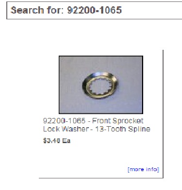

650ed wrote
This is what I have on my 750. See pic below from Z1 Enterprises. I had one with my 630 chain and sprockets and just put new 530 chain, sprockets, new nut and new lock washer on the bike 2 days ago. With 1 or even 2 sides of the washer bent over against the nut there is no way a loose nut can move let alone fall off. .... at least on the 750/4.
I dont know how the 1000s are supposed to be but am curious if a different setup is recommended or preferable on larger bikes
PS I dont know if the washer pictured will fit other bikes
......... or you might be able to use a splined lock washer like on later models (see 2001 KZ1000-P diagram below). The splined washer locks into the shaft because of the spline and then you bend part of the washer against the flat of the nut to prevent it from turning. Ed

I'll call them Monday. I like what JR suggested 92200-1065 Front Sprocket 13-spline Lock Washer. Too bad they didn't suggest that to me earlier. I would have purchased it then.
