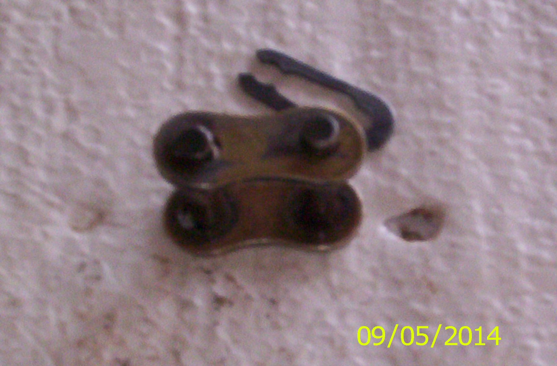

Buy a good quality DID, EK, or other chain. Don't buy from eBay unless you get a warranty and know where it's made. One is Made in China. I posted a thread about it. The ad says High Quality, what they don't say is made in China. Damaged my sprockets and started to come apart within 1000 miles. Wouldn't respond to e-mails and by the time I had the problems, time was up. Ebay is not interested in it being defective even though it could have been life threatening. Had to buy a standard chain to run until I can save up to buy the whole set up.

I bought the standard chain to get as much out of the sprockets at the expense of the chain as possible. What has been said is true. I knew better than buying a unknown chain. The price was the tip off. I will keep paying for it. Buy the O ring and sprockets. You won't regret it.

That's right. When I put Bossie beck on the road, I had a chain and sprocket set I bought 15 years before I parked her. In no time the NOS pretty gold DID chain started kinking. Dried out. Should have bought a new one but bought that cheap Chinese Junk chain. Pay now or pay later, you still have to pay.
