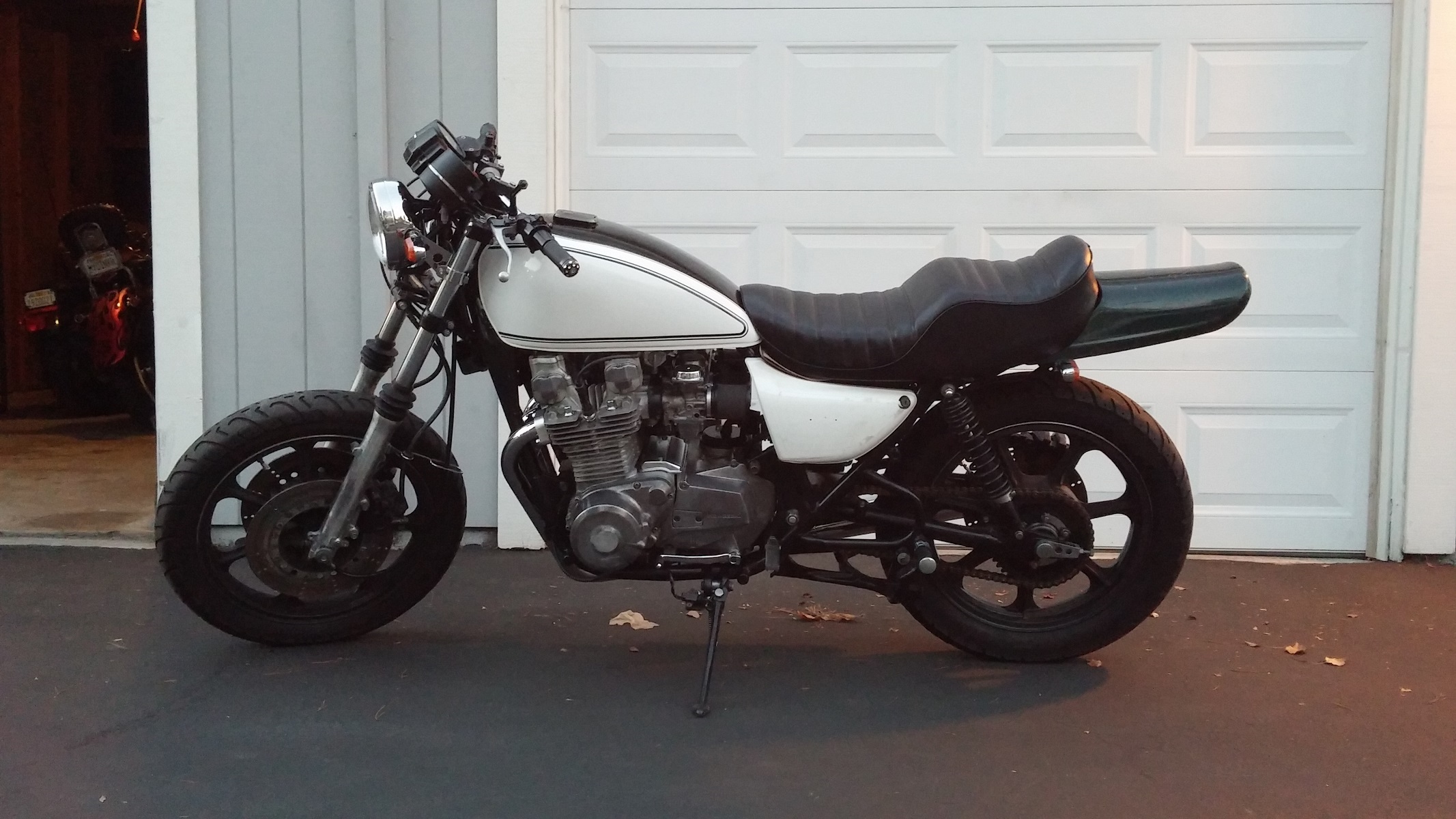

I swapped out the stock bars on my KZ1000P with drag bars, (28" inches wide). The swap was straight forward. This is what it looks like. By the way, I've done quite a few long rides and the ride is comfortable considering the drag bars. Makes the bike feel sporty.

Beauty!!
I still ride with only 2" high Euro bars and can't imagine what it's like with God awful ape hangers.... wow.
Where did you get those crazy mini fork gators!??

The mini fork gators are actually the stock ones, cut in half. I hate to admit that I eventually added stock KZ fork boots.
Thanks for the compliment on the bike. It's work in progress. Fun bike, well worth the countless hours into it!
