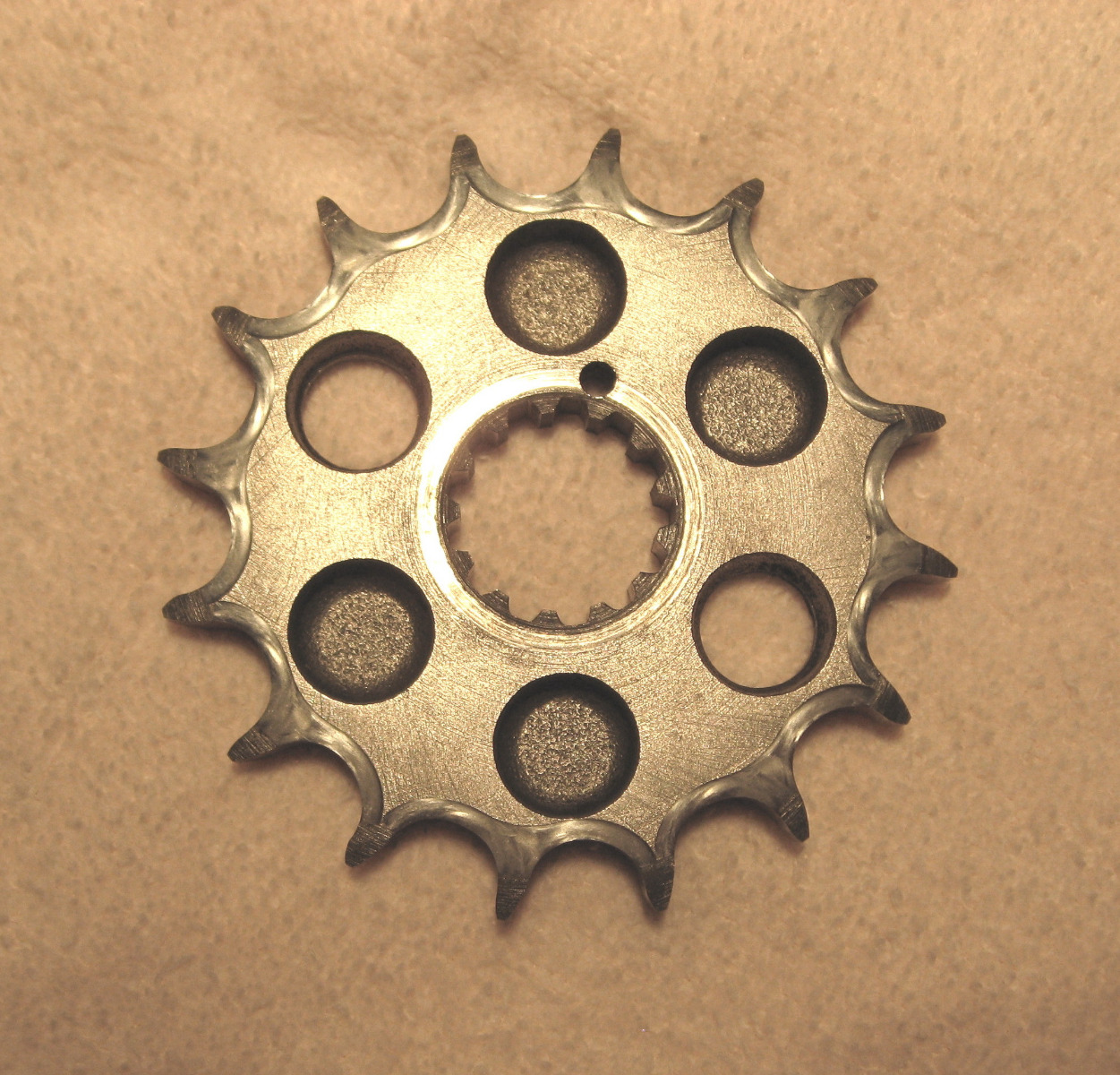

57+k miles. I replaced the original chain at about 37k miles because it and the sprockets wore unevenly as a result of the chain adjusters being swapped left to right (the two adjusters are different on the KZ650- C1 model). The chain wasn't worn out, but I wanted to start fresh after finding the problem (see counter sprocket image below). I replaced the sprockets with stock items and the chain with an O-ring Tsubaki chain. It now has a bit more than 20,000 miles and has been adjusted less than 1/4 inch, so I'm sure it will go more than 40k miles. Ed
