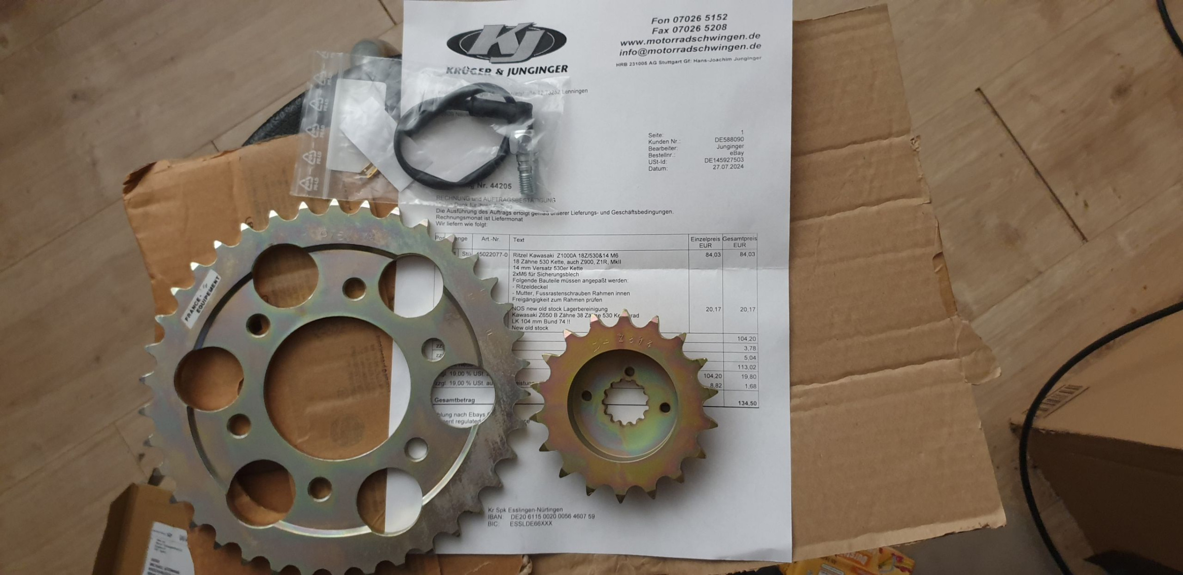

I know this thread is super old, but I am also going to do this conversion on my 1981 KZ750H2 LTD. Current state of the chain is super rusted. I figure might as just do the conversion and know I have a brand new chain drive installed.
Front= 16T
Rear= 38T
Chain=RK GB530XSOZ1-118 (will remove the needed links)
Front= 16T
Rear= 38T

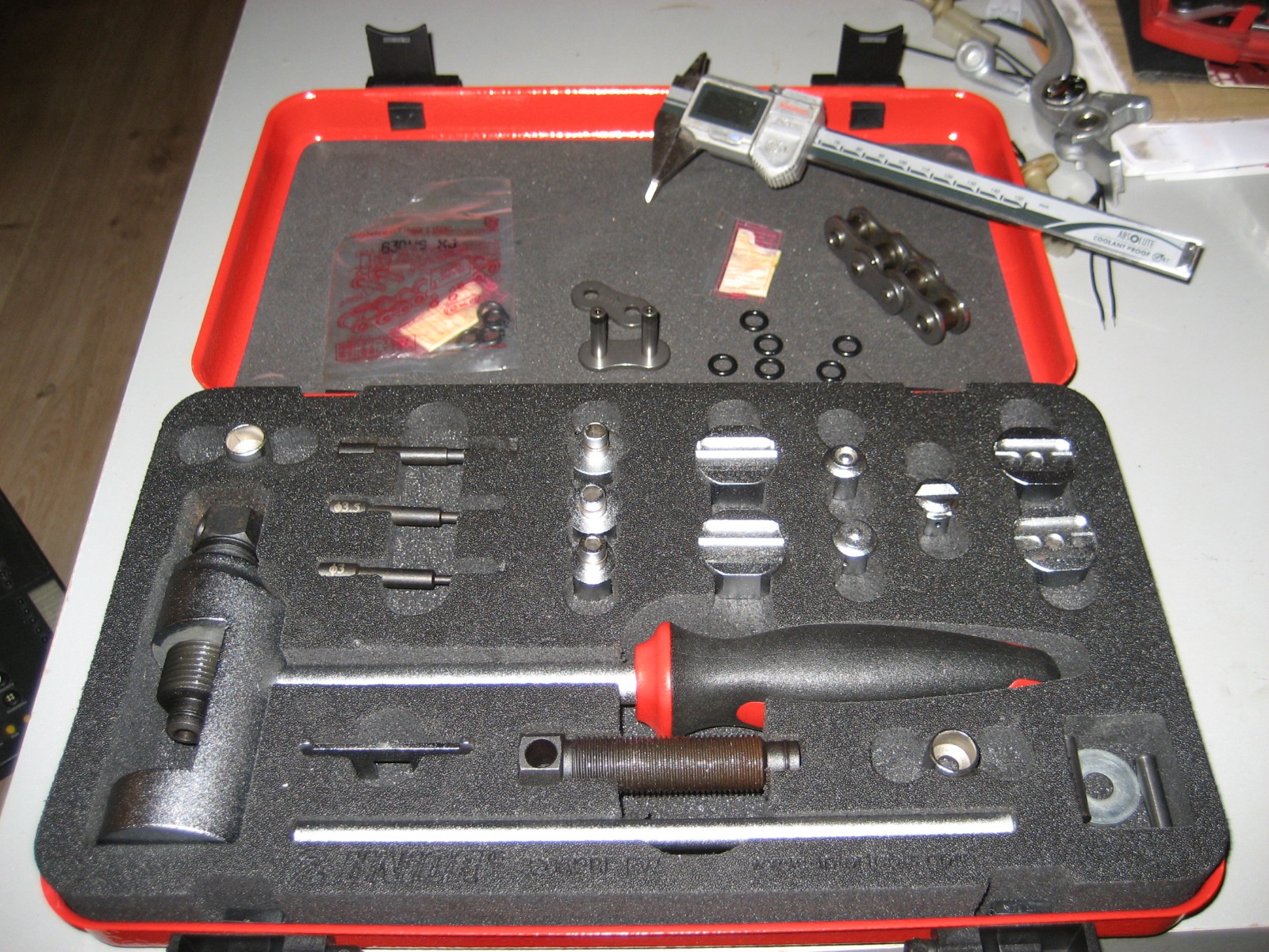

10 Oct 2024 16:10 - 10 Oct 2024 16:15ROTHEWALD CHAIN BREAKER AND RIVETERD.I.D. makes an excellent chain breaking / riveting tool.
Best chain tool ever you can buy for money, Made in Germay Quality as usual !!!
What else.......
www.louis-moto.com/en/rothewald-chain-br...icle_number=10009883
kzrider.com/forum/5-chassis/615435-chain-master-link#843388

Re: 630 to 530 chain and sprockets on 1980 kz750

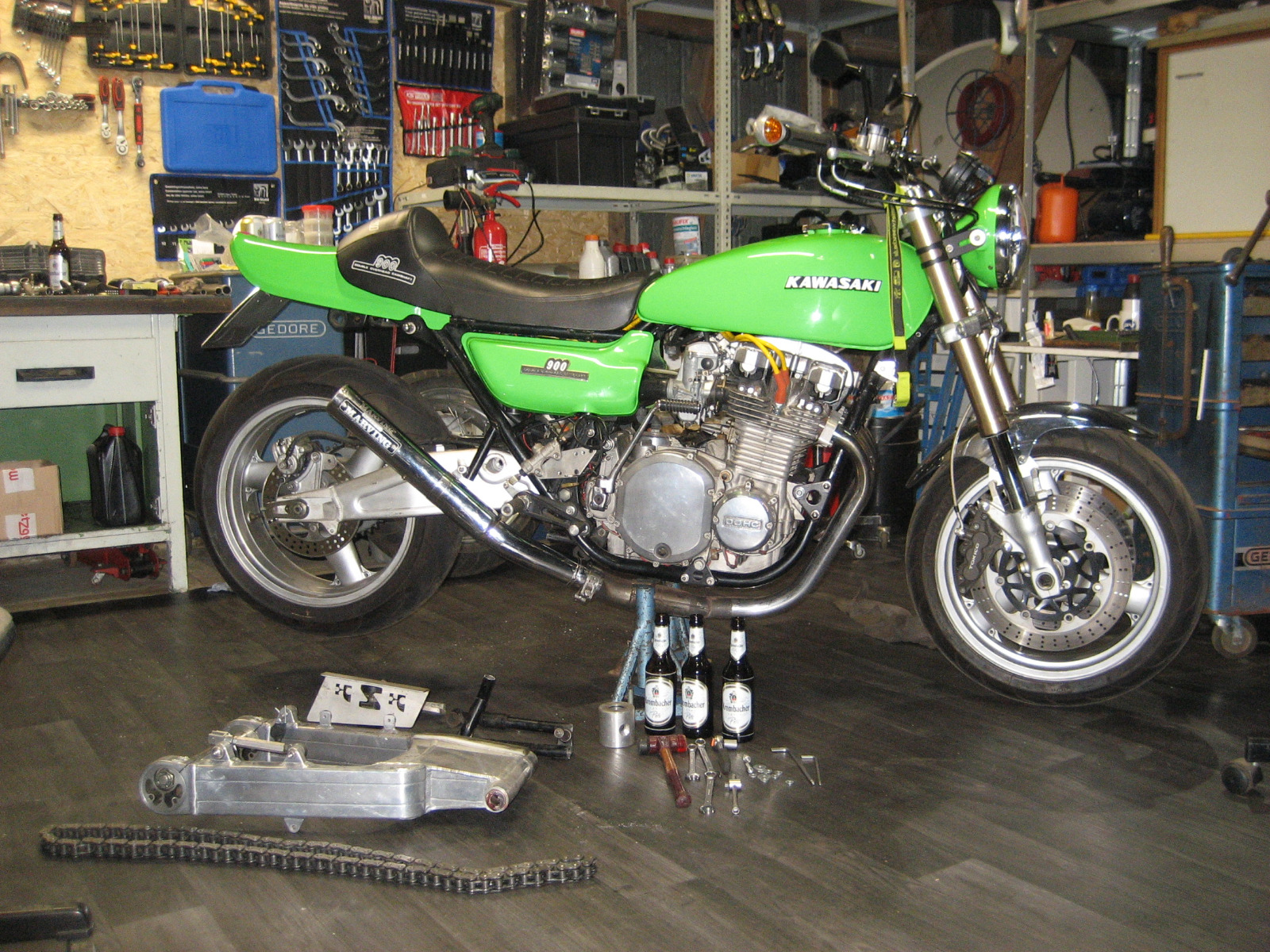

10 Oct 2024 16:56 - 10 Oct 2024 16:59
This tool will be in use to my 630 to 530 chain, swing arm, mono shock, wheels conversion.
