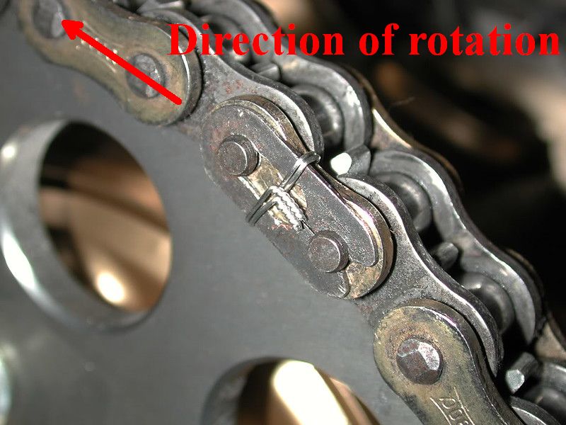

Clip type are fine, I have put them on all my bikes and never had a problem.

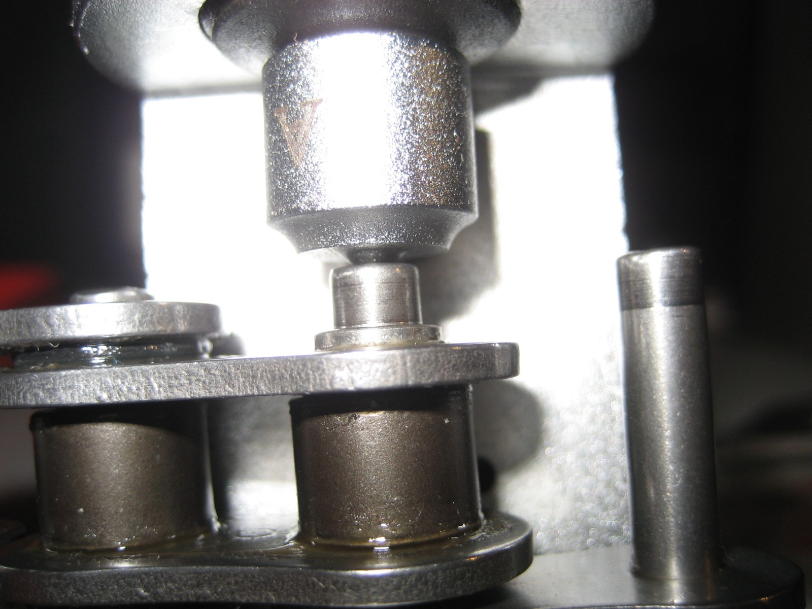

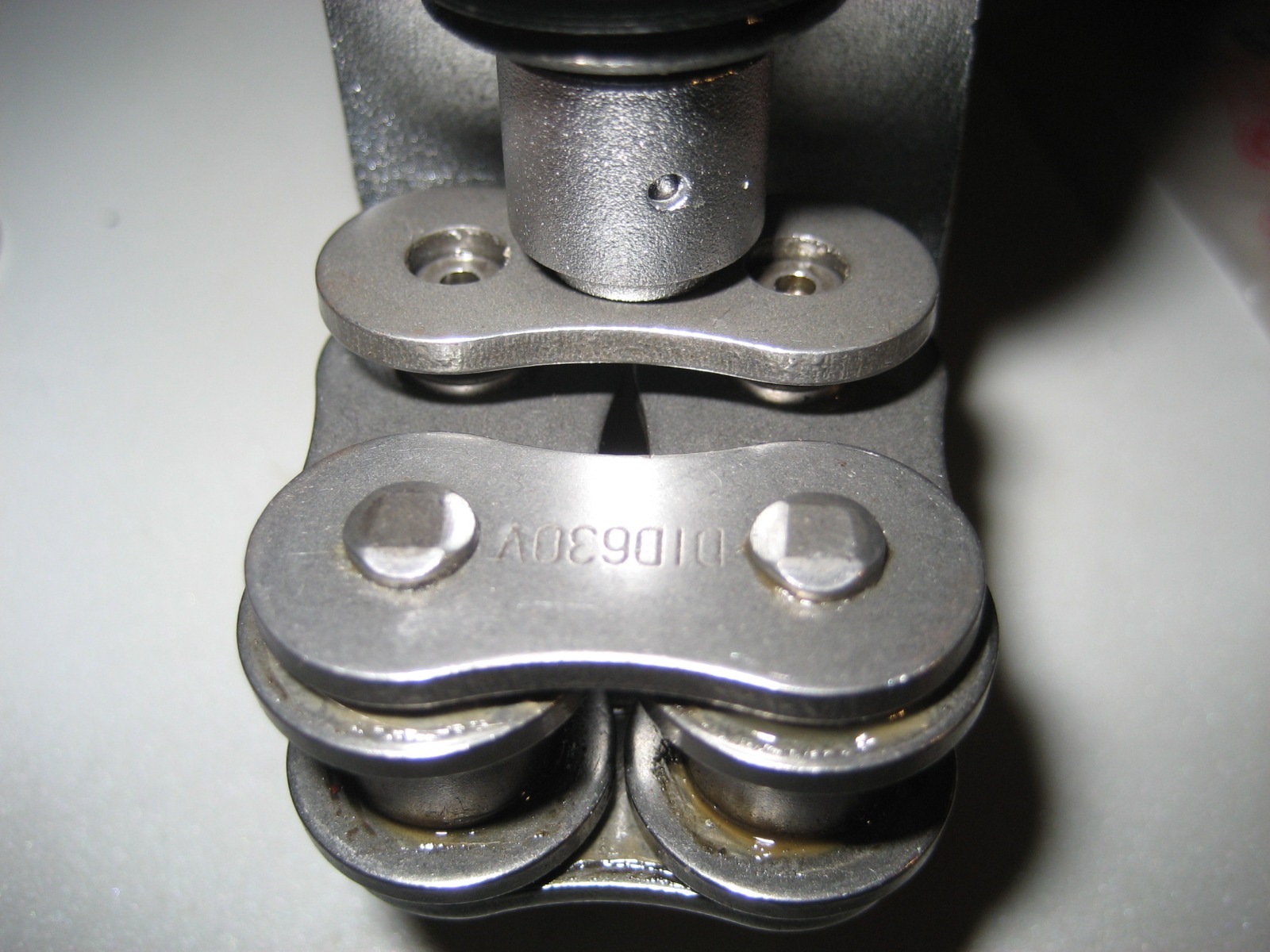

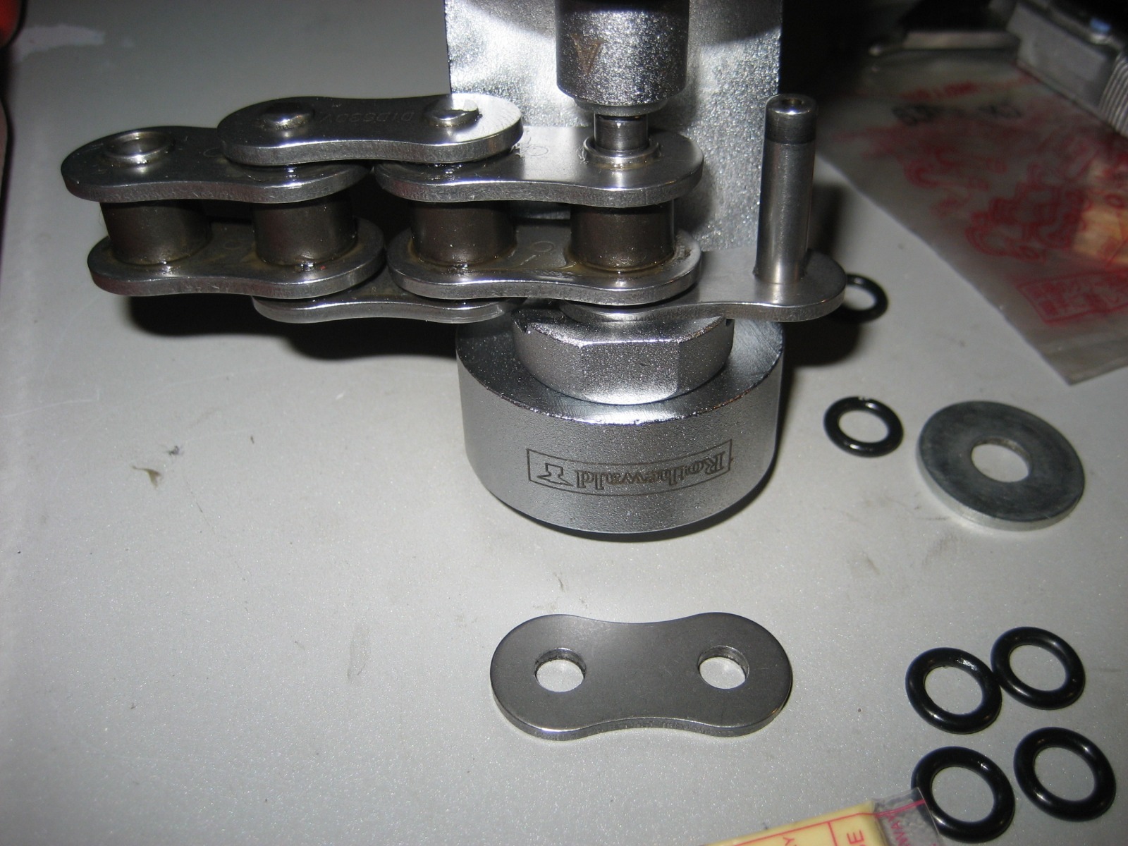

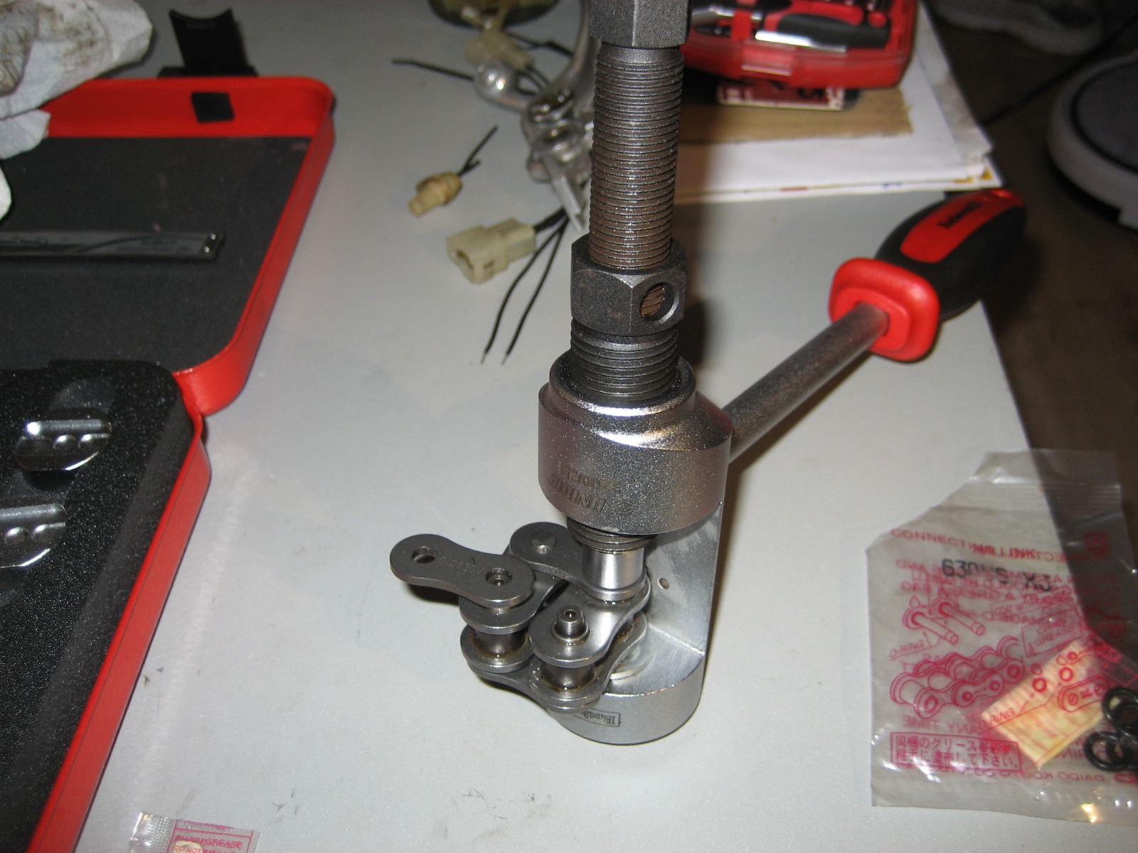

Riveted master links are as strong as the rest of the chain. I use a D.I.D. Chain breaking / riveting tool. The translated instructions are not as clear as they could be, but once I figured it out, the tool proved easy to use and has given excellent results.

I prefer a rivet master link but have to admit, the safety wired link clip looks pretty secure.
You can get a cheap chain tool from Cycle Gear or Amazon. They look beefy but the C clamp is made from cheese steel. Before using the tool to push out a chain pin you have to grind off the head of the pin to the greatest extent possible.
Modern rivet type master links typically have a hollow pin so the chain tool just has to flare out the end. Doing this is fairly easy and the tool doesn't undergo too much stress.

The chain I installed on my KZ1000 this summer came with the rivet-on master link with the hollow pins that Nessism described. I used a sharpened bit in my air chisel with a 2 lb. sledge hammer behind it as an anvil to mushroom the pins, it worked pretty well.

Thanks everyone. I wasn’t aware there were easy rivet tools available Time to order !

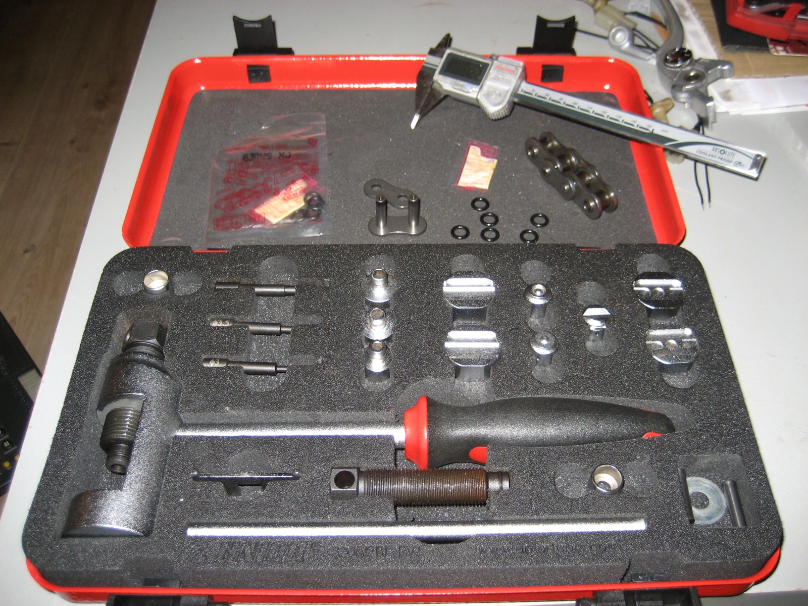

Stay away from cheap chinese tools. I love to buy quality tools.
www.louis-moto.co.uk/artikel/rothewald-c...ald-tilting/10009883
