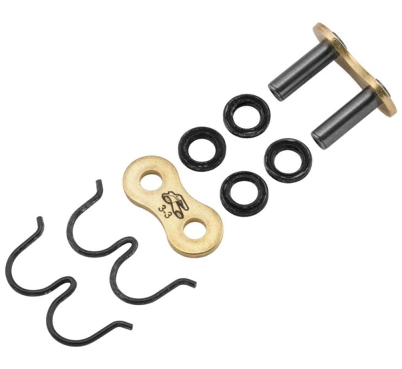

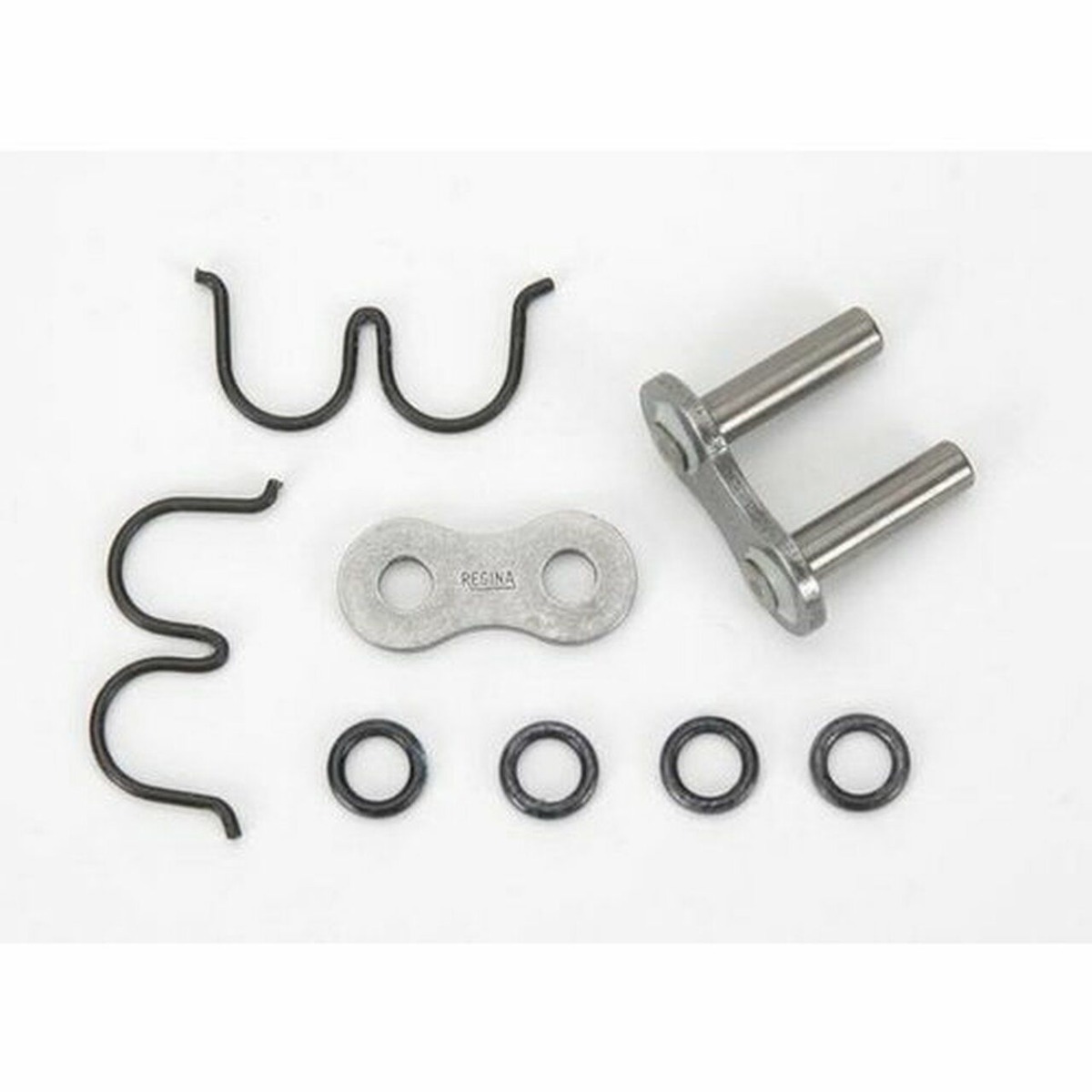

Regina and Renthal offer rivet master links with a wire gauge.
performancecycle.com/renthal-r3-3-520-o-ring-chain-rivet-link/
performancecycle.com/regina-530-ors2-rivet-master-link-black/
