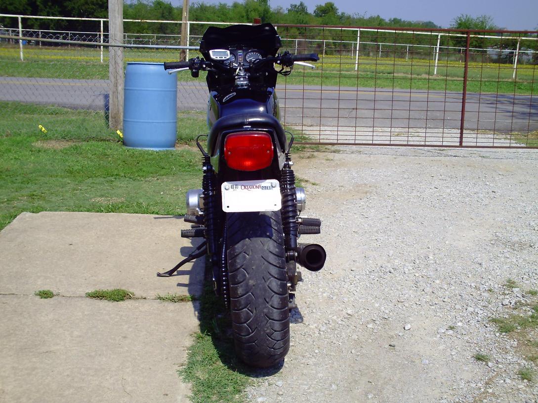

it would be un-noticeable .
i have my rear tire offset 3/8's to the right and it is absolutely un-noticeable in a straight line,turning either way whatever.
take your hands off the bars at 75 and it runs straight as a string.tips into corners the same either way .
