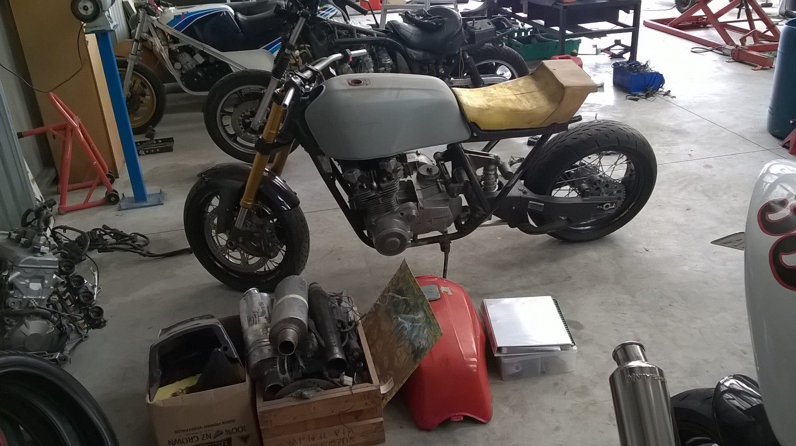

Nice project mate! Funnily enough here is Jarrad's GPZ in my shed. A friend of mine bought it and took the rolling chasis and I got the motor.

Re: GPZ 1100 resto mod 'Old Red'
10 Feb 2016 01:11
Oh man, that's a shame. Hopefully, I don't run into the same road block. I wondered what had happend. I am hoping to make it a runner and get a lot of the kinks out before tearing it back down for paint.
