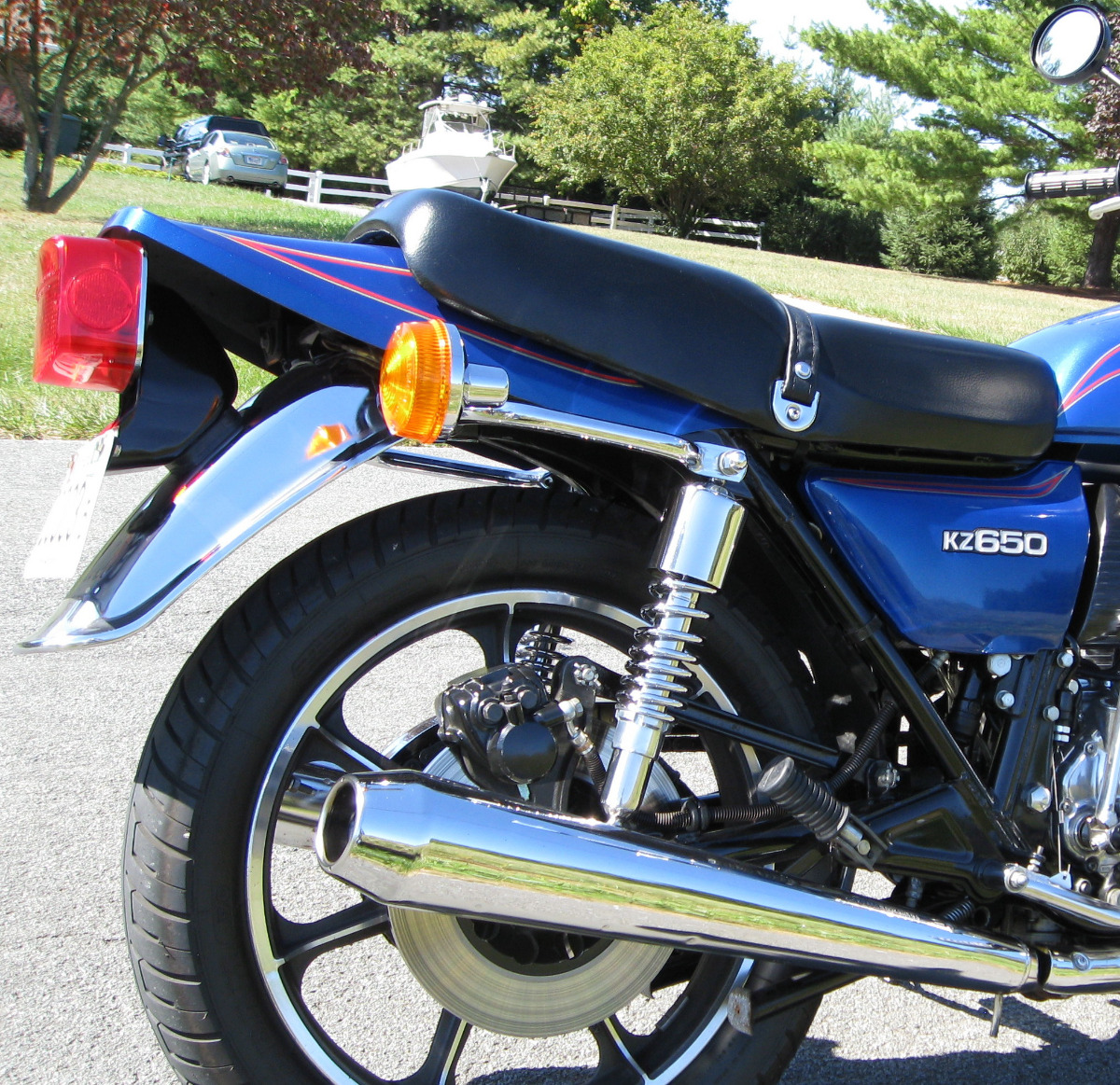

The stock shocks were probably the biggest weak point of the bikes. I would just replace them with Hagons. The Hagons are a million times better than stock but look similar (see pic of mine below). Let me know if you want a link and some info. If you do disassemble your shocks I would suggest you compress the springs before driving out the roll pin. Here's a link that may be helpful; it discusses dis-assembly of stock shocks. Ed
