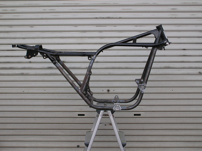

me personally.
i would use a burr on a die grinder and start grinding the hole out until i had it to the same wall thickness as the rest of the tube.
then section a piece of tube and weld it in and blend the welds out to make it look as if i had never been there.
or you can do like these guys did and remove all of the lower tubing and replace it with chro-mo tubing.

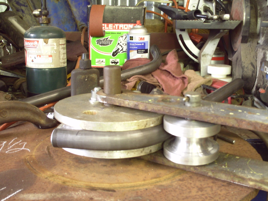

11 Dec 2013 06:30 - 11 Dec 2013 06:31
you could gain some strength and lose some weight using chrome-moly.
i have a homemade bender i bend 1 " .083 with manually.
but you can't go wrong with the
www.jd2.com/p-32-model-3-bender.aspx .
