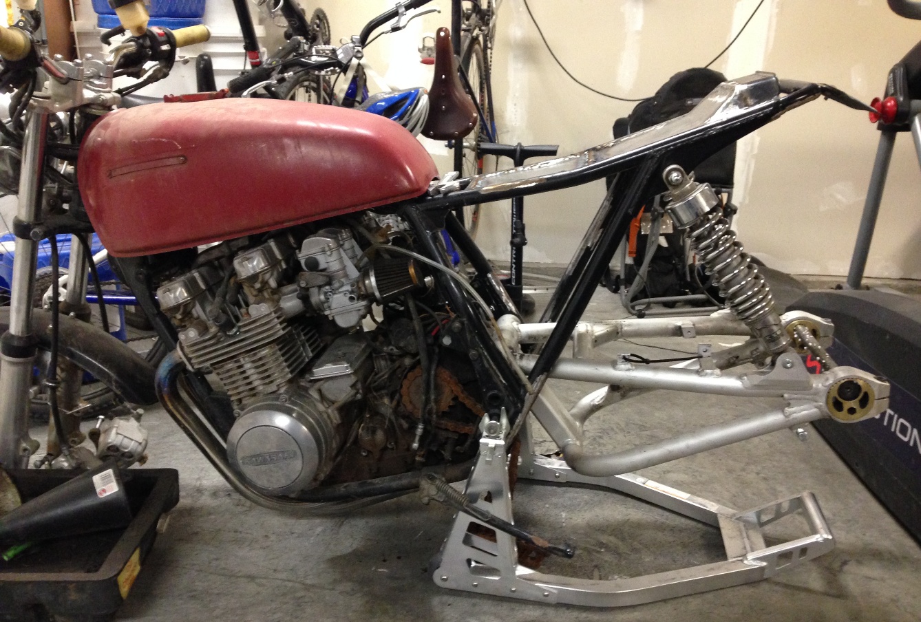

here is the ZRX swingarm. It looks pretty easy, cut of a little at the pivot and space out the shocks. Pretty straight forward for the arm. Still waiting on 2 others and then I decide. If I don't use the ZRX arm it is going up for sale here.

looks pretty tidy !

sHere is a 99 ZRX1100 swaingarm and shocks on my 82 GPZ750 framed ELR. It fit pretty easy with some minor modifications to the pivot. I also had to space out the upper shock mounts to line up with the swingarm. It came out really clean and looks factory.

Ok, I cut about 3/16" off each side of the aluminum tube, and then turned down the stock KZ650 sleeve to 20mm od to fit inside the ZRX sleeve, then put that in the ZRX and measured and trimmed equal amounts off of the right side spacer and the swingarm sleeve to make them equal which gives about 0.1" on each side for a spacer to mate with the frame bosses and support the sides of the swingarm.

I'm currently fitting a gpz750 swing arm to a 650 frame, seems to be straight forward. I picked the swing arm up with some other parts and it's already had the solo shock mounts removed and waiting to be relocated.
The more difficult part seems to at this time fitting the zx900 rear wheel. It was about 1/4 too wide, 1/8 came off each side spacer and now I'm just navigating clearing the sprocket bolts to swingarm.
@kawiconvert that swap is killer looking! Nice job. Looking forward to final pics.
