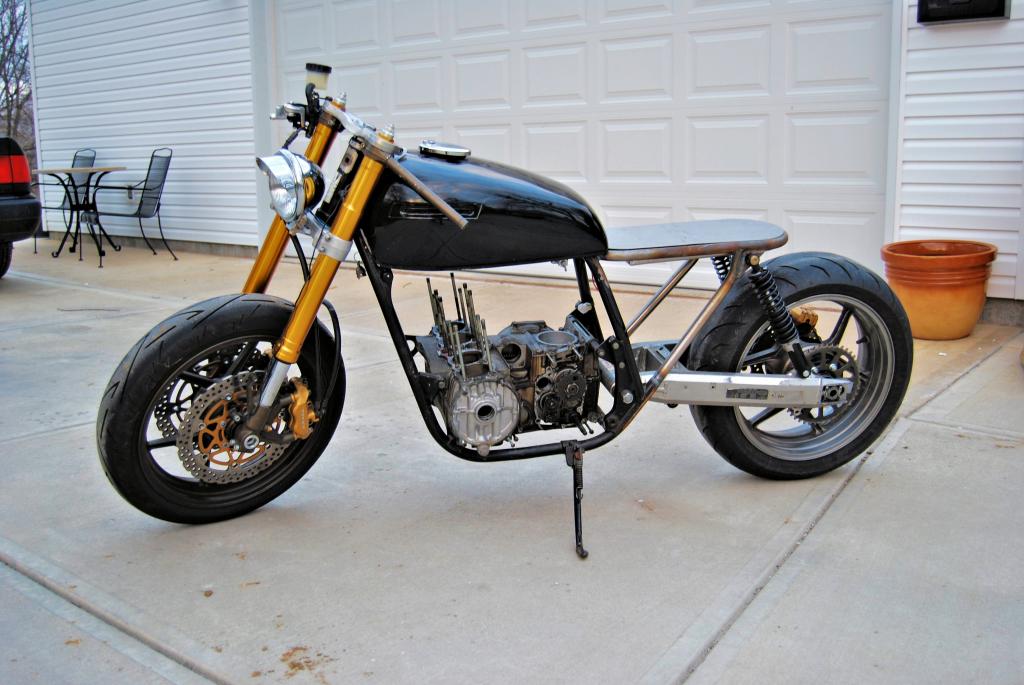

The oil cooled Gsxr swingarms can be made to fit quite easily and the 750's arm won't lengthen the bike too much if at all. If you want to keep the twin shocks then it'll just be a matter of welding on some shock mounts which I believe Z1Enterprises can get.

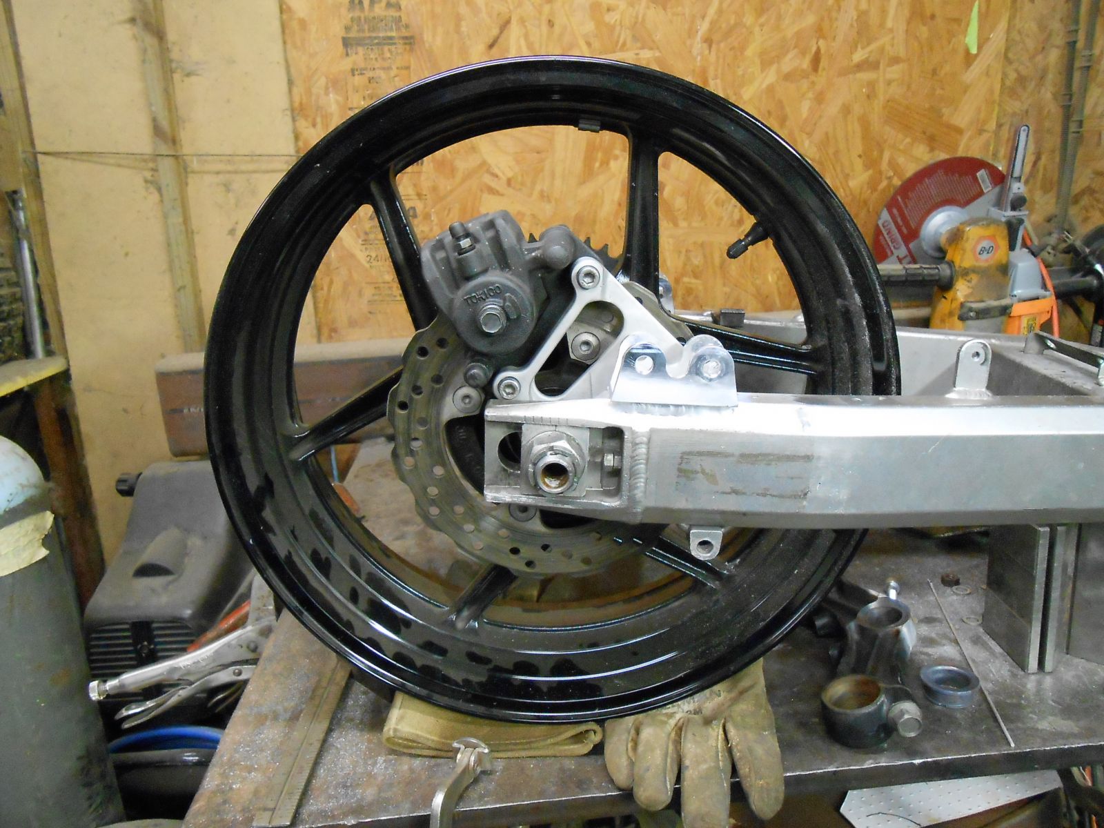

No eBay APP ID and/or Cert ID defined in Kunena configuration03-04 zx6/636 is nice later model stuff to use as well,like dnels bike..
that gets you into some nice late model brakes wheels and suspension.
you gotta have some machine work done on the pivot and weld shock mounts on and modify the caliper mount to clear the shock.
but,the swingarms go for cheap and the machine work isn't that expensive.

i don't recall how much longer the arm is than factory.
a little slice and weld gets the caliper out of the way.

The ZX6 arm added 2" over stock length to my bike. Leon steered me towards that arm and I'm glad I took his advice. Super easy to convert.

I run an 83 GPz750 arm on my F1 that's 2 1/2" longer then the stock arm.
Easy swap I trimmed about 1/16" off each end of the tube and the drilled the frame to fit the GPz bolt.
Z1R rear hub with a cut down disk to fit the GPz caliper and made spacer ring's to fit GPz bearing's
for the GPz axle bolt.
