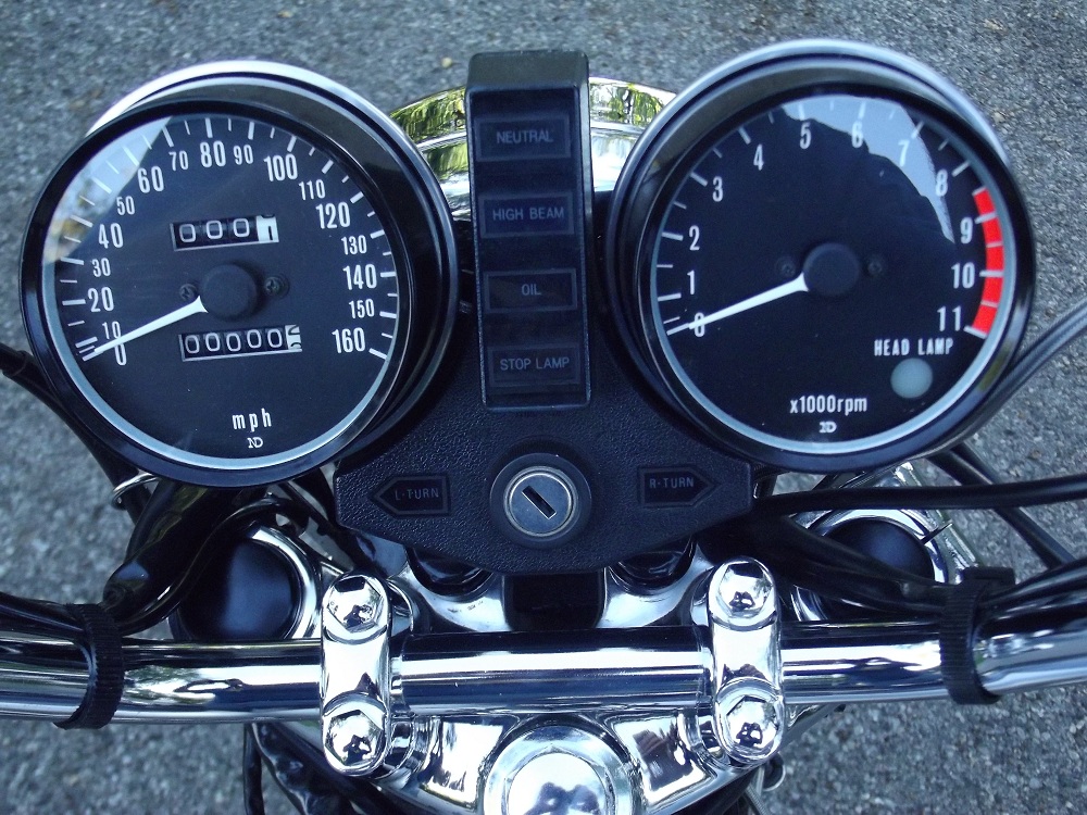

Those look about right. Should I keep them or change them out?

Those look amazing Pete Greek1. I may have to do the same. Do you have a before pic?

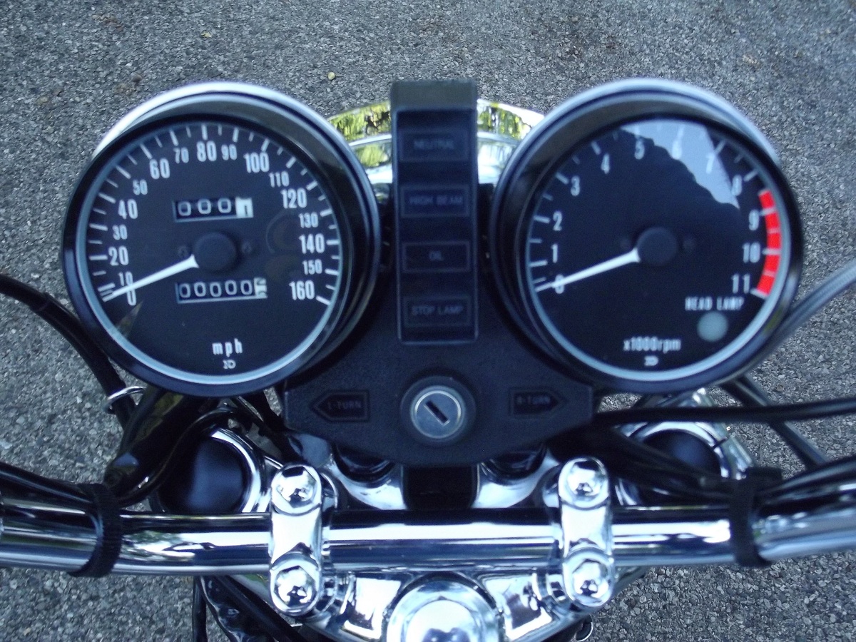

Did'nt take any b-4 pics. my original speedo was in great shape, but only went up to 85 MPH, so I bought this speedo on E-bay, it had a cracked glass some rust & faded, Looked like brand new when I got it back, as you can see

That is the same dash as mine. What did it run you? How much do you think it would cost to have them redo my gauges? I am thinking about buying a set like you did and parting mine out on ebay or the forum. Thoughts?

What did it cost you to have it fixed?
pete greek1 wrote: Did'nt take any b-4 pics. my original speedo was in great shape, but only went up to 85 MPH, so I bought this speedo on E-bay, it had a cracked glass some rust & faded, Looked like brand new when I got it back, as you can see
