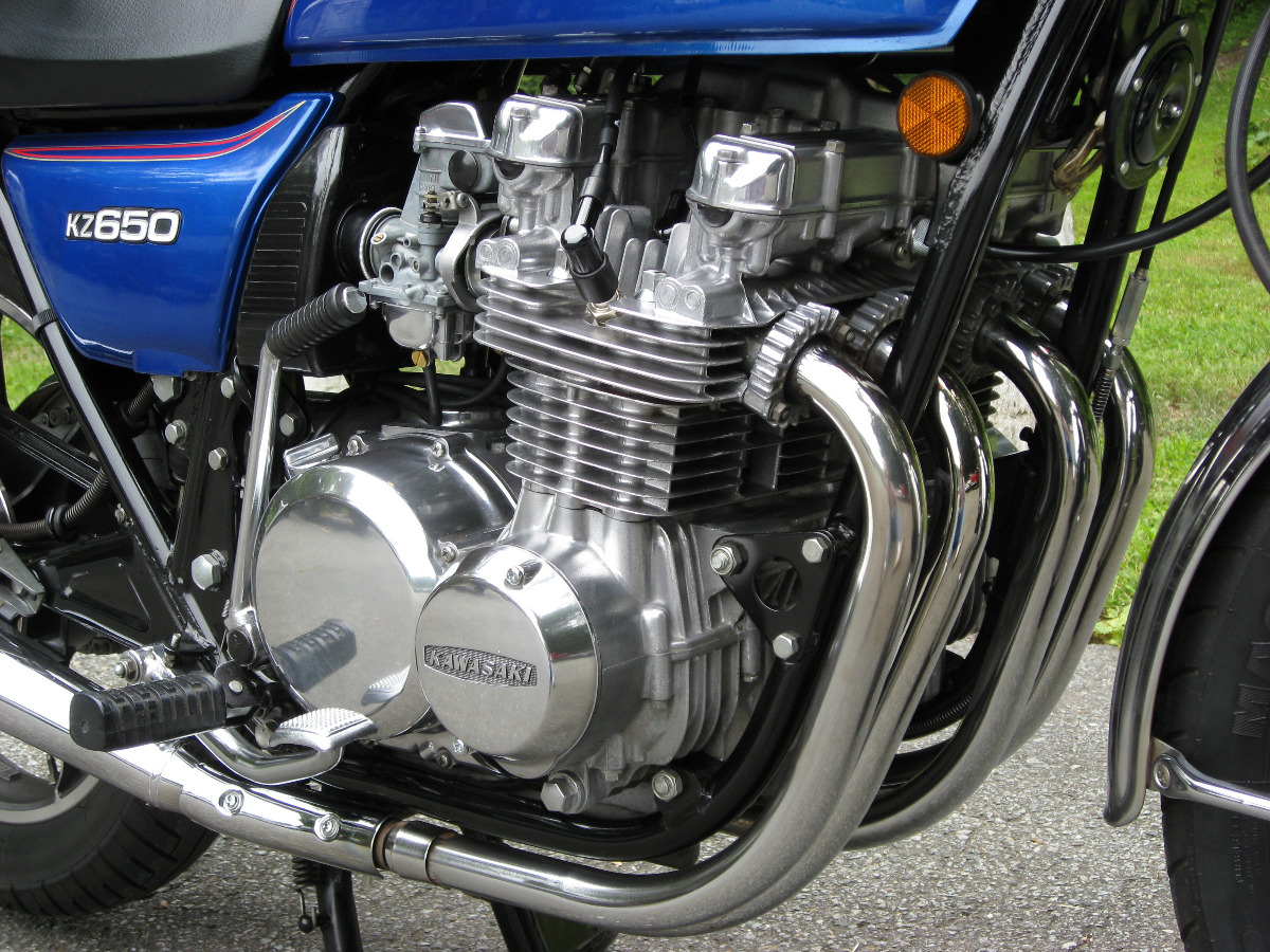

03 Sep 2013 14:17mardimus wrote: ............. But you guys think I should leave them aluminum and just polish them up?.....
That gets my vote every time! To me, the polished aluminum looks cleaner and more natural than plated engine covers and it blends with the rest of the engine better. Another bonus is you don't need to ever be concerned about the plating peeling off or about scratching it. The aluminum is very easy to keep up once it's polished and unlike plating, any little marks can easily be polished out. Ed

That is a very nice and clean looking engine 650ed. Thanks for the pic, it gives me a nice goal to meet in my cleaning process.

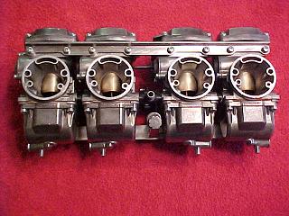

I tried searching which carbs I have and no luck. They do not match any of the carbs listed on the Z1 carb guide. Any other thoughts. I ran a few searches but no luck. I found a real clean set on Ebay to purchase, they are . . . Carbs 29mm Mikuni Smooth Bores drag bike kz900 kz1000 z1 smoothbore
Would these work?
Would these work?
- Posts: 18564
- Thanks: 2103
Re: 1975 z1 900 front end upgrade
03 Sep 2013 14:58Carbs at hand are probably Mikuni constant velocity BS34, that were installed as a replacement for the stock Mikuni 28mm manual slide carbs.mardimus wrote: I tried searching which carbs I have and no luck. They do not match any of the carbs listed on the Z1 carb guide. Any other thoughts. I ran a few searches but no luck. I found a real clean set on Ebay to purchase, they are . . . Carbs 29mm Mikuni Smooth Bores drag bike kz900 kz1000 z1 smoothbore
Would these work?
Pic of BS34 from www.wgcarbs.com --
